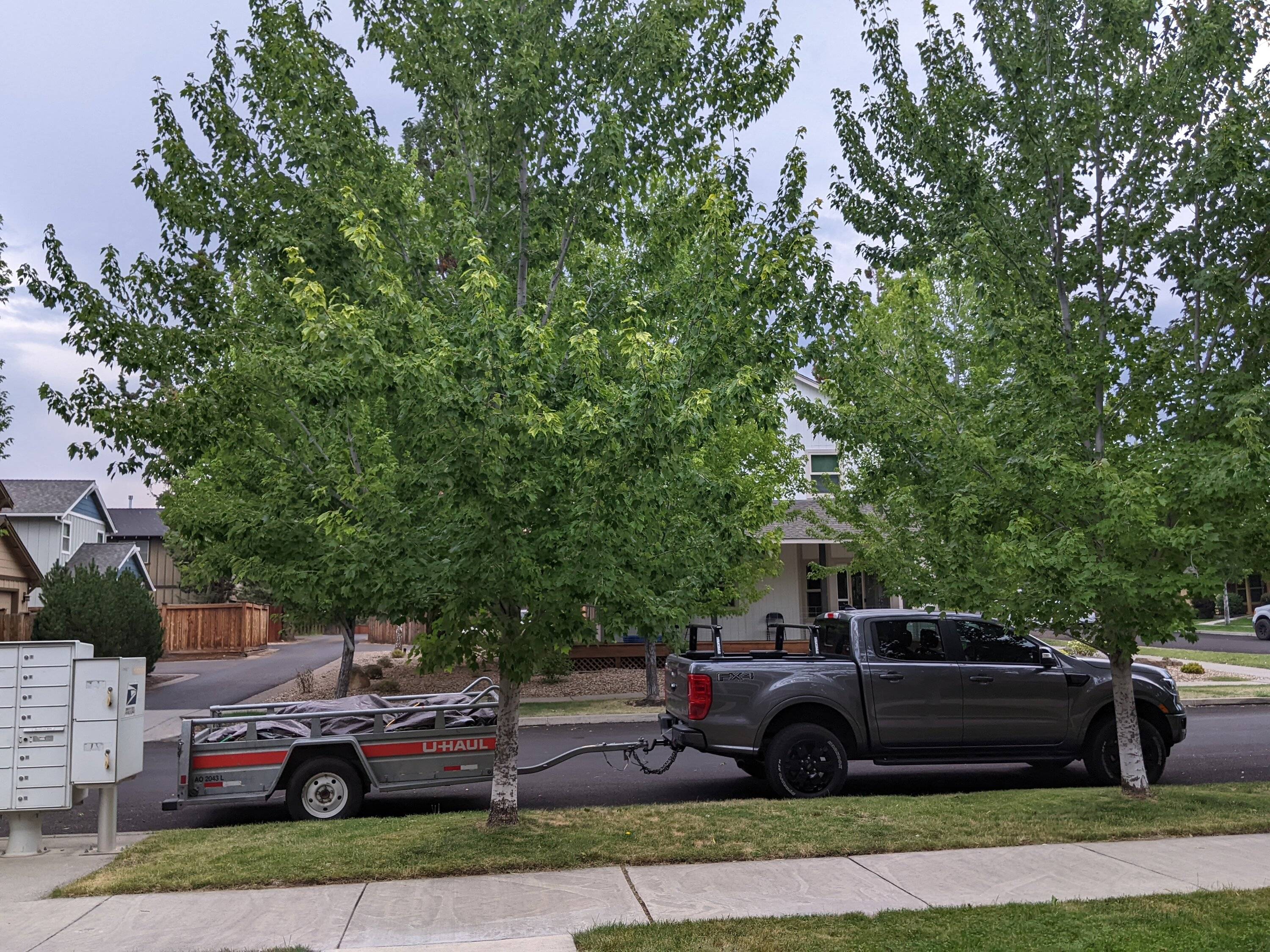

Here is my stock FX4 with a 3.5" drop ball mount and a U-Haul cargo trailer. (My truck does have Fox 2.0 rear shocks - they did not raise the rear end any). You can see the trailer is still slightly nose high, but it is close enough. If I was buying another mount, I'd probably go with a 5" drop, especially if I had larger than stock diameter tires (which I will when I replace the stock Hankooks).
