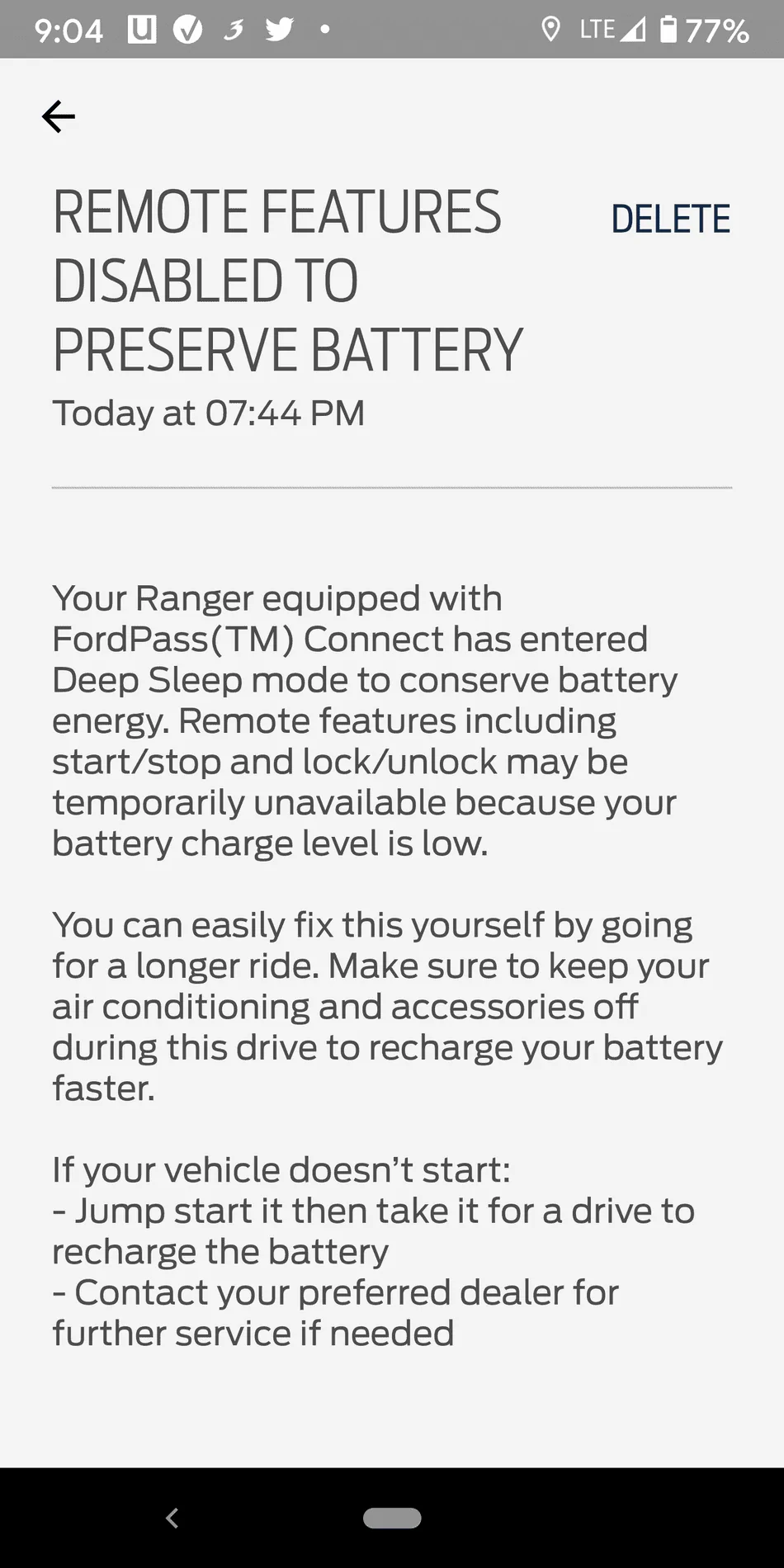

I had the same issue, the Intelligent Access stopped working on all the doors except the driver's door after receiving a message on the app that my 2019 Lariat was going into deep sleep mode due to low batter. I drove it for over an hour on Thursday to recharge the battery and everything else went back to normal except the door locks. I tried the BMS module reset. The batter light on the dash did not flash three times until I started the engine. After that, the Intelligent Access worked on the rear driver side door but by the time I tried the other doors, it was no longer working. It is back to only working on the driver's door. I will confirm the battery is charged and try again later. I appreciate this forum. I don't know how long it would have taken me to find a possible solution without it. Thanks.
I have had similar issue. Since the cold weather. If I put a charger on it overnight the door locks all work properly but next time I try them they don't. I have not done the reset yet. Sometimes when I first get in I get a message about it being shut down to conserve battery. I think I read somewhere that the battery should be fully charged when you do the reset.

I am thinking my Ranger is getting tired of this cold weather.❄
137,238
Either that or it's telling you he's lonely and wants to go for a ride. ?
You can easily fix this yourself by going for a longer ride.
