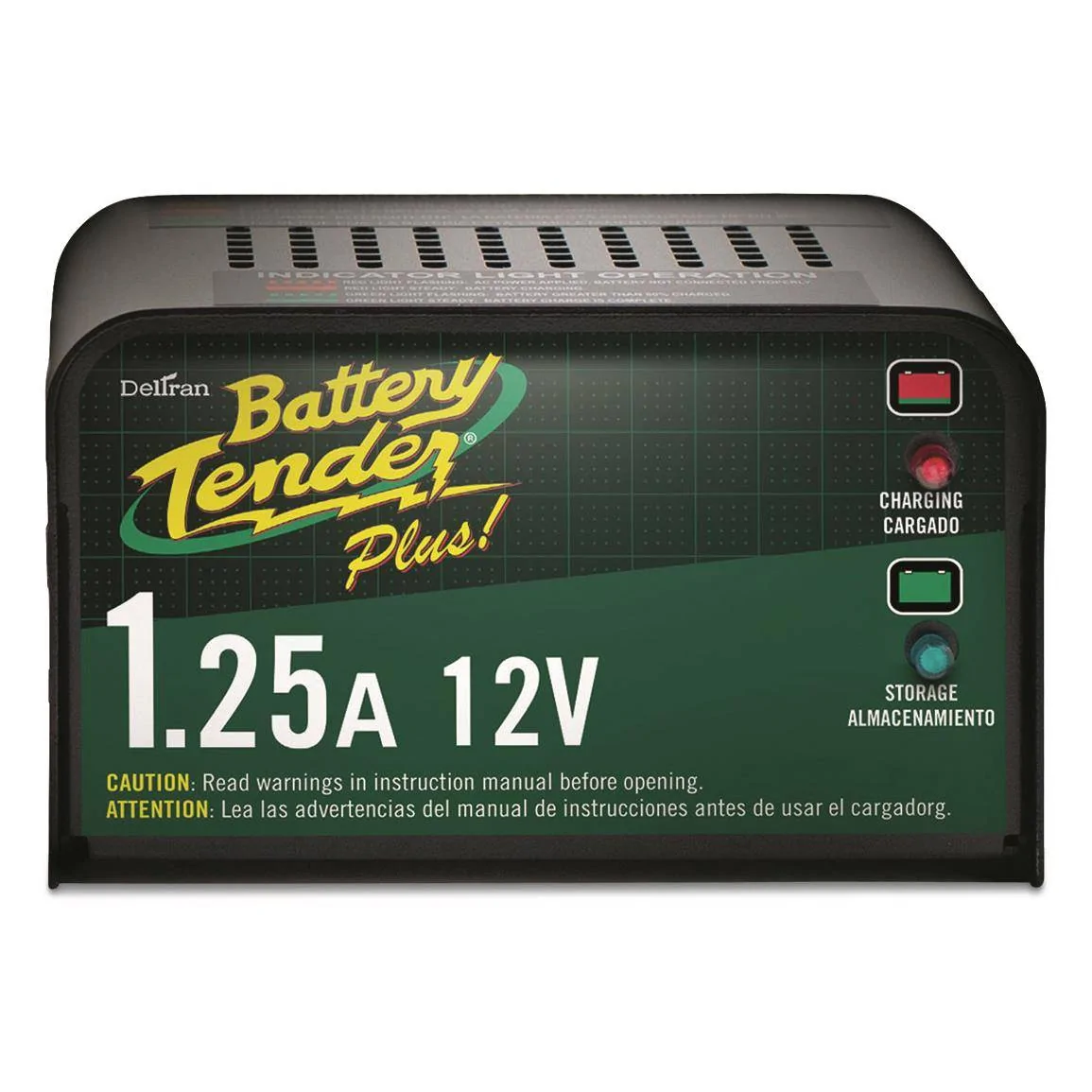

Low battery voltage can cause this.
Charge the battery before doing anything else. Top off with a 'smart charger' - I use a Battery Tender. There are many other brands on the market.
