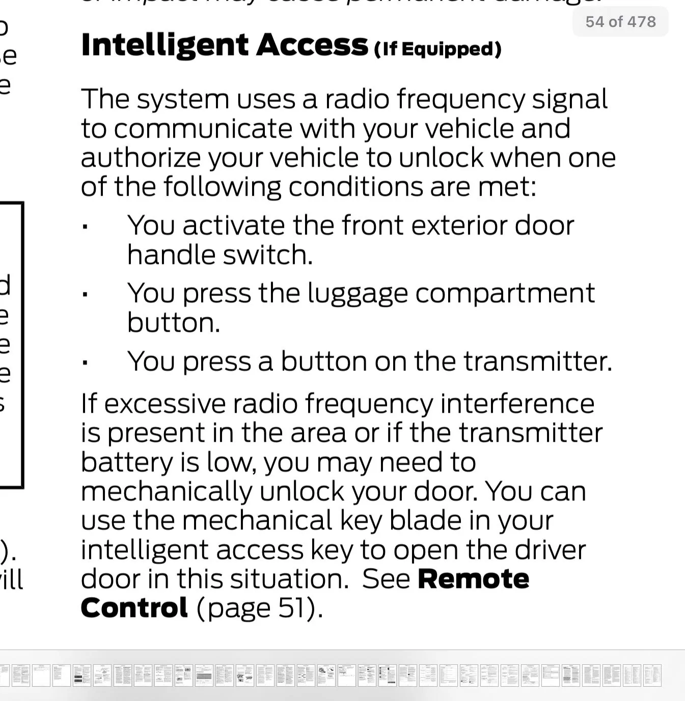

All I know....just purchased and remember reading this.
