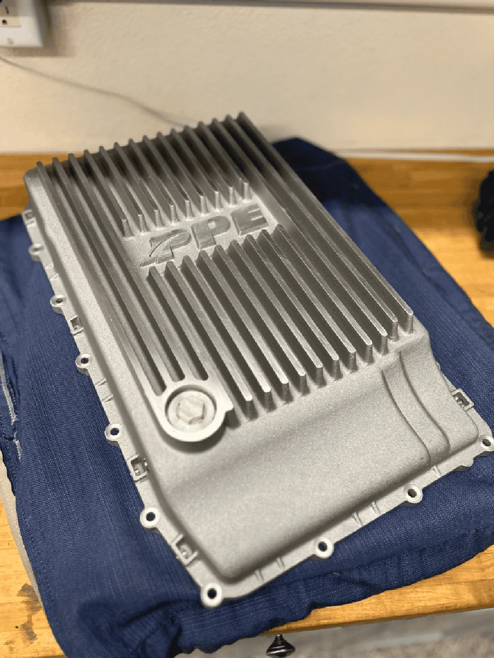

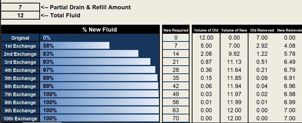

here is a link to a drain and fill spreadsheet from an ambitious gent posted on BITOG . Need lots of ULV to get rid of all those contaminants. Similar to motor oil changes where some pick a mileage number to do a change (every 3k), whether or not the ATF really needs to changed at 30k miles is highly dependent on the way a vehicle is operated. Not in my current plans.
https://bobistheoilguy.com/forums/threads/transmission-partial-drain-calculator-sticky.215133/
"If I can't get it all I'm just not going to do it"
Sure, go with that.
You're getting more out than you think.
Also, I'm not holding a gun to anyone's head, I've clearly stated that what I do is probably excessive, and then posted what I think is reasonable. No need to argue over an opinion, you do you, its your truck.
I stand by my assessment that Fords 150k change is completely unreasonable and the trans should be serviced much sooner.
By changing the fluid every 10k, I am essentially getting a complete (93%, close enough) exchange every 30K. Sure, it uses a little more fluid and it is an extra step, but I bought the PPE pan and MBS stick for a reason.

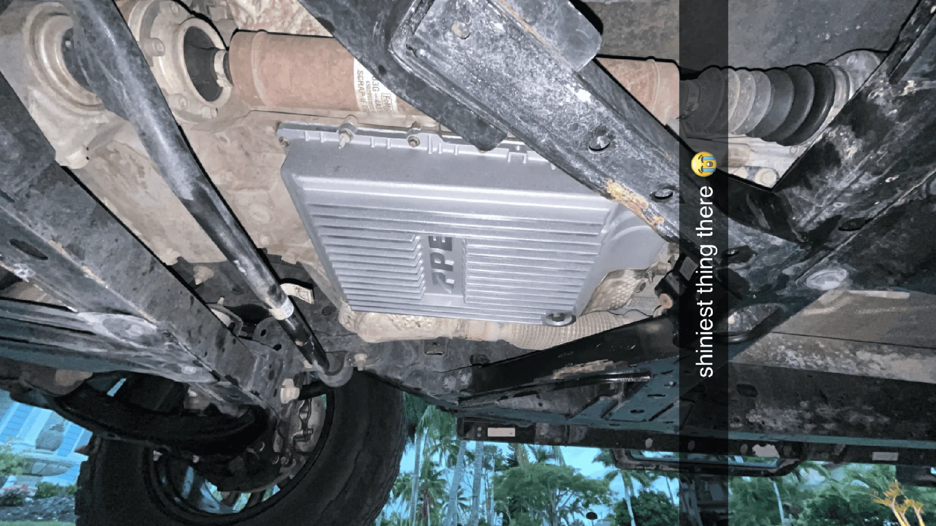

Got mine dropped and the pan changed for a metal one for 400, pan cost 150.

do you know what pan they used ? and does it have a drain plug ?

Pacific performance engineering pan and yes it has a drain plug. Only reason i changed is because I cracked open my plastic oem pan :clap: on a rock at 5k miles now i use a stop sign skidplate too

Where did you get the pan for $150?

you stole that pan ....really good price ...

The shop recommended it and that’s what it cost, dunno if they market it down a lot or just had one they were trying to get rid of :bandit:… try americantrucks.com
