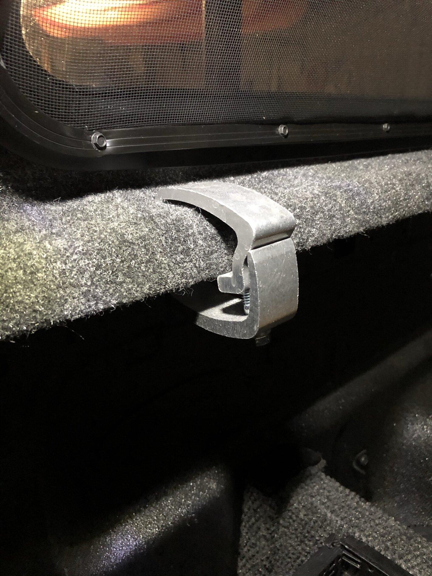

I’ve got as ARE shell and the mounts will make it difficult to add either brand panel without cutting it. At least I think it will.
I don't think the ARE shell will be a problem. I've seen the panels used on trucks that have similar mounting brackets for the tonneau covers. The Valhalla website actually says "Compatible with most canopies and tonneau covers."

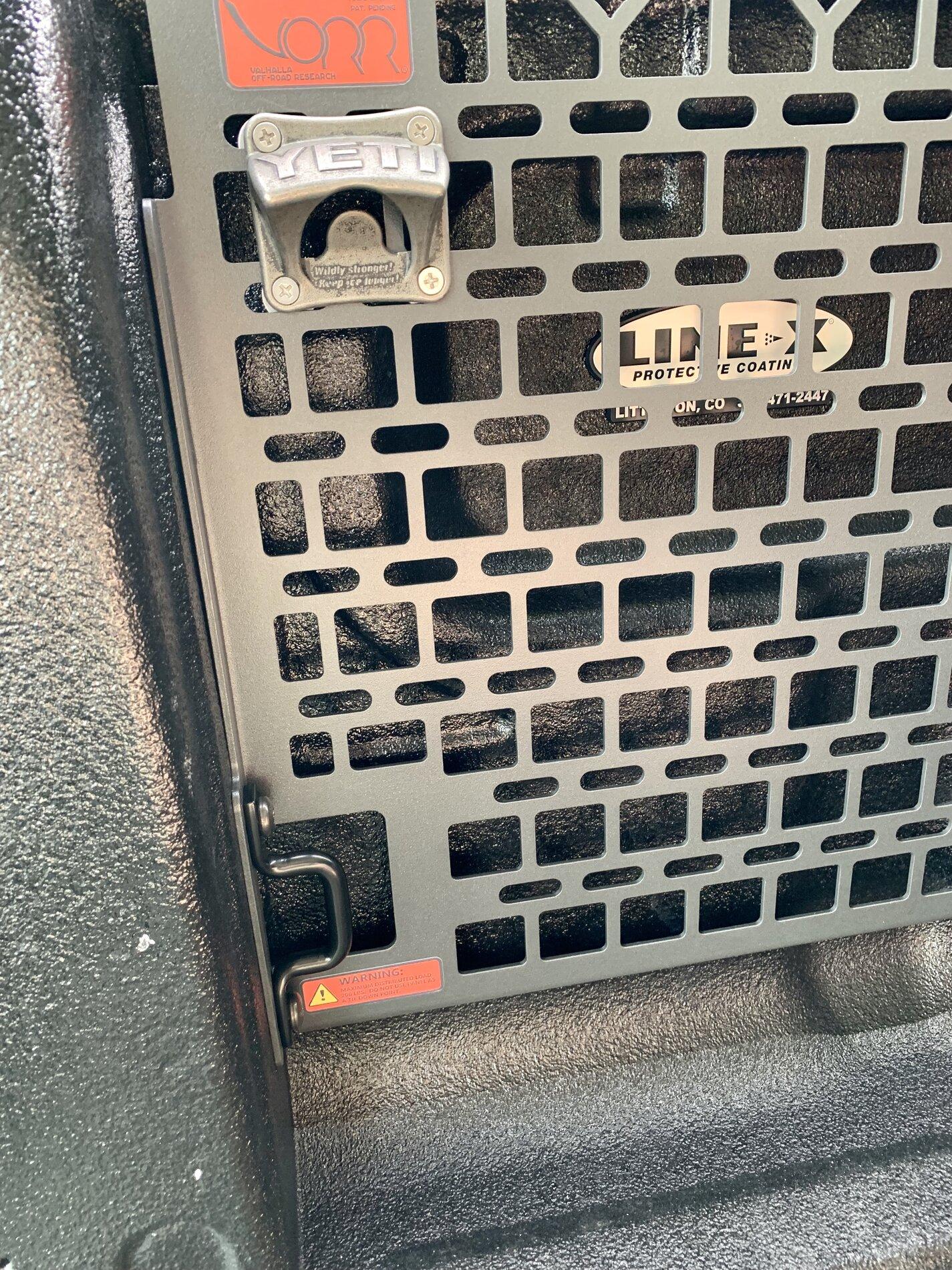

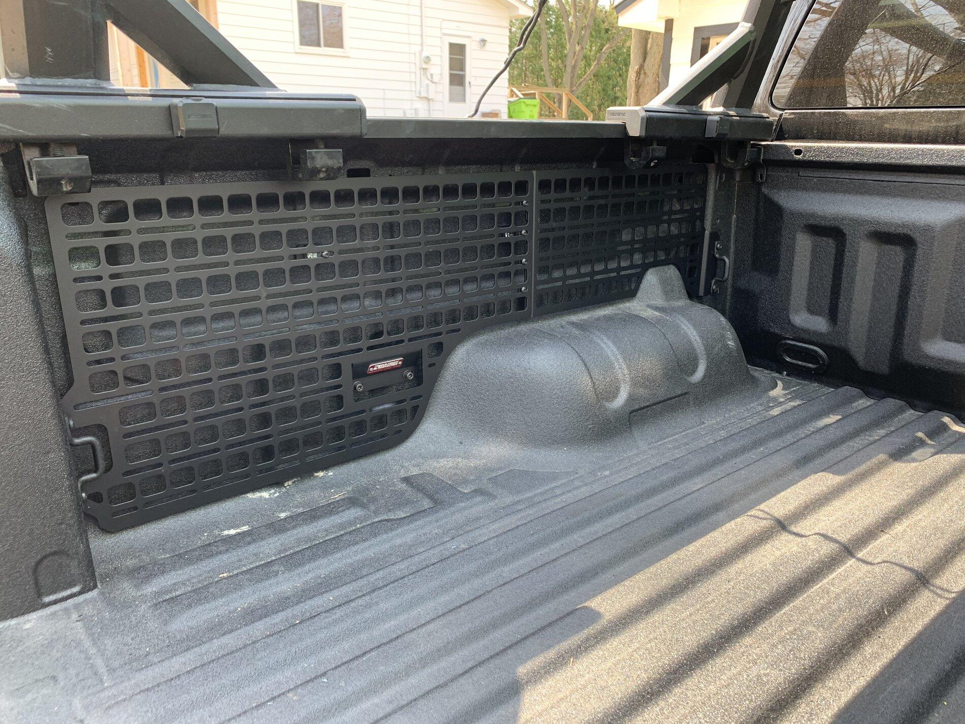

Installed my driver side yesterday, working on the passenger side today. LineX did me no favors by spraying my tie-downs and the rubber grommets. This install would be super easy if I didn't have to cut around all the LineX to remove the tie-downs and grommets.

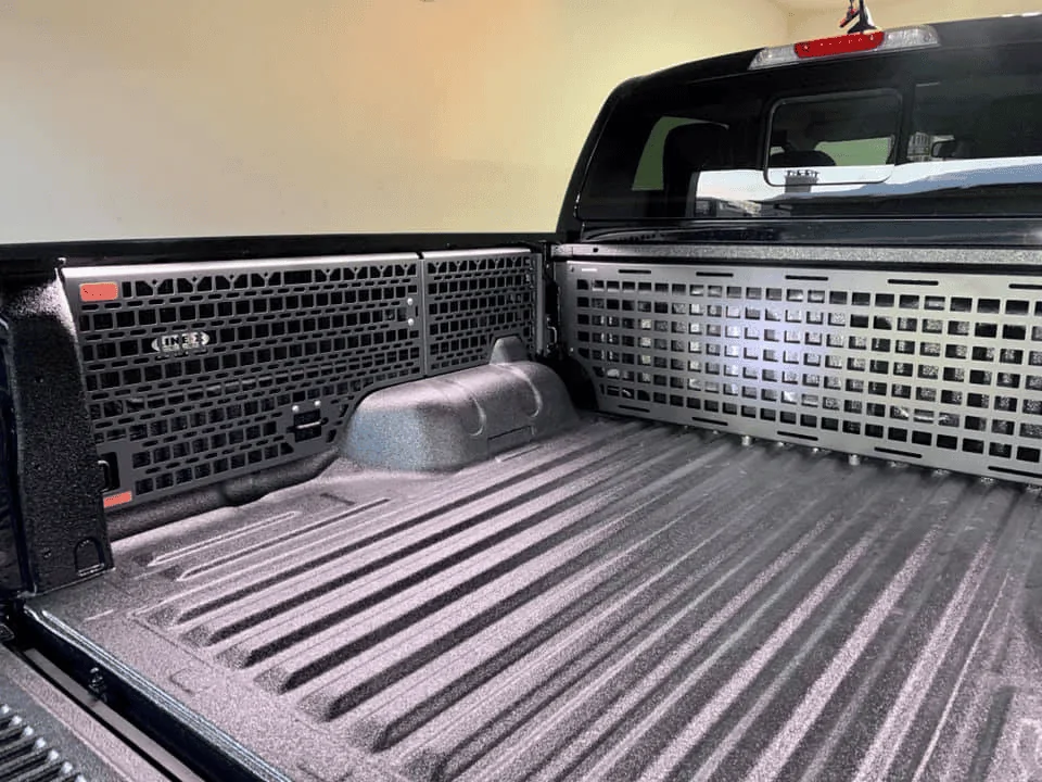

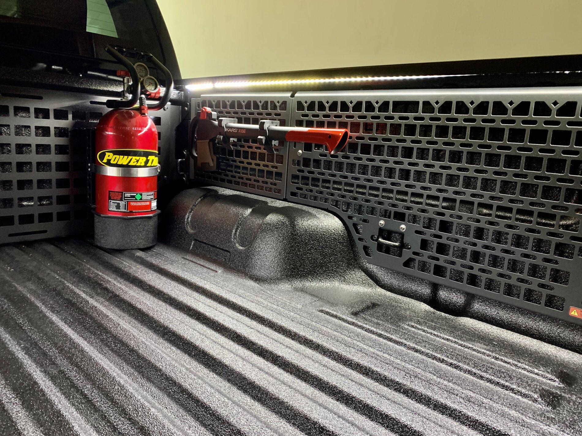

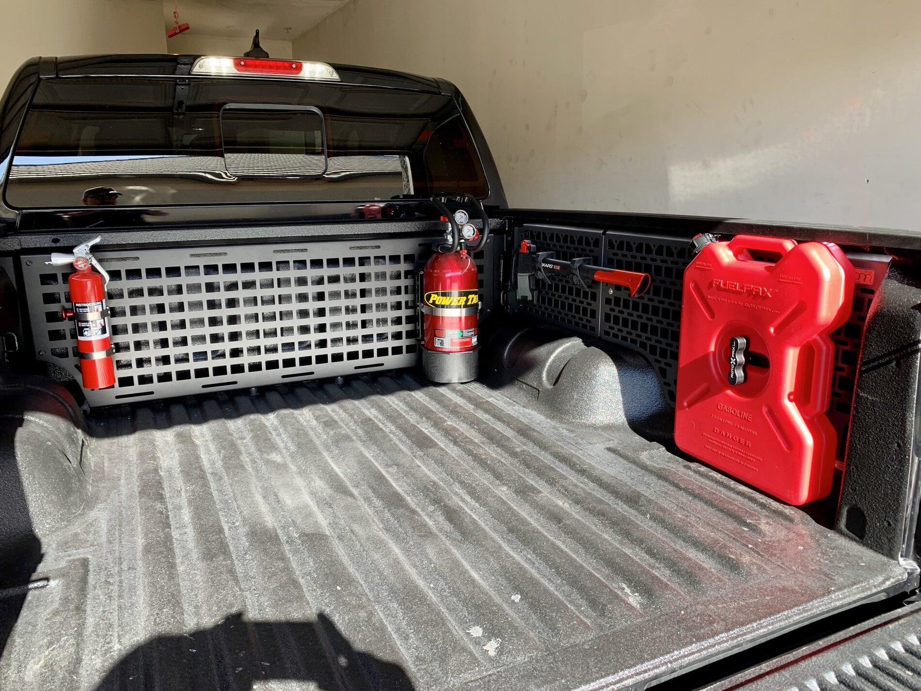

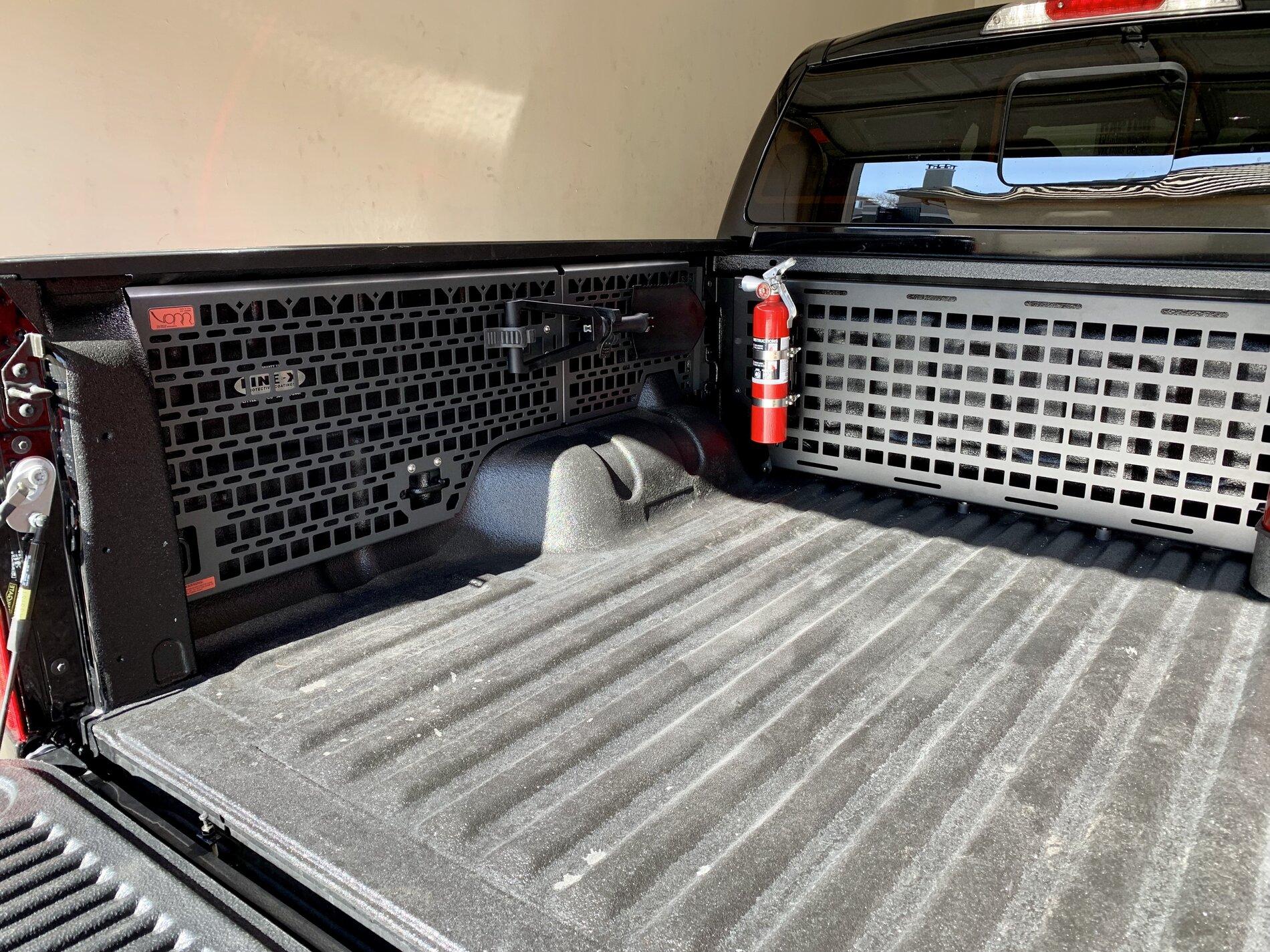

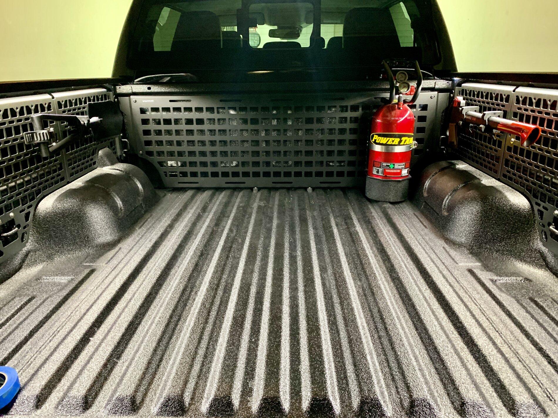

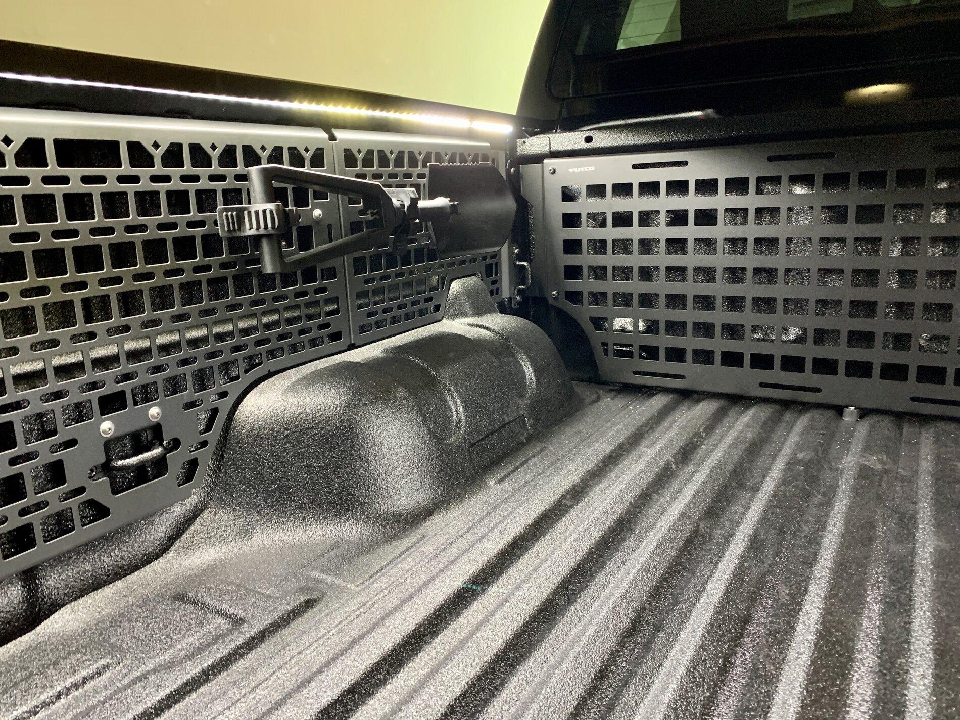

I have a lot more to do, but here are pics of what I’ve done so far. You can’t really mount Quick Fist clamps on MOLLE without a backing plate of some kind.
My Power Tank is mounted with a Power Plate (backing plate made by Power Tank). My fire extinguisher will be mounted tomorrow on the front panel. I fabricated a custom backing plate. Several companies make backing plates for RotopaX mounts - I bought one from Valhalla and one from BuiltRight.
The best option for Quick Fist clamps is to make a backing plate, or buy specialized MOLLE square nuts. I think most of the MOLLE nuts are made for 1” x 1” MOLLE, the Putco panel is 1” x 1.5” openings. I think they will still work. I have some on order and I’ll try them on the front panel, but I bought them for the Valhalla side panels.
