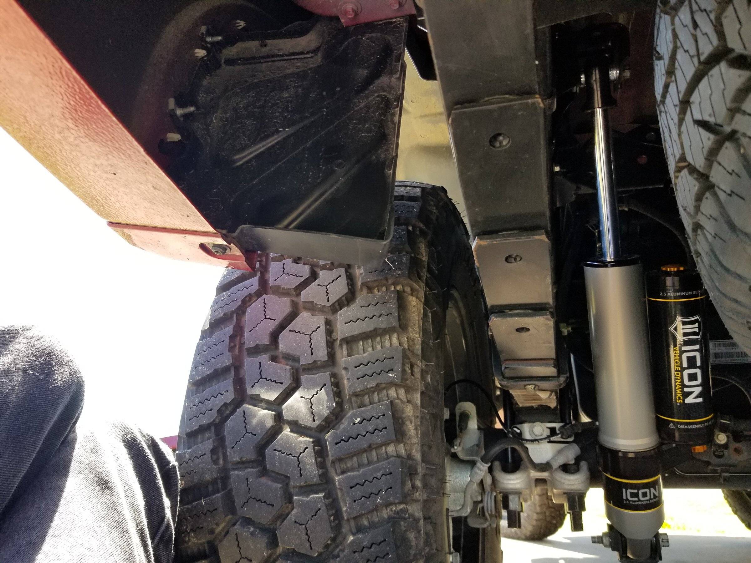

Most of us that have ICON's I think have ICON leafs too. I had Bilstein all around (5100's front, 5160's rear) then added ICON leafs first as I have a trailer to deal with, plus a bed rack etc. and it turned out Great!
Then I was down the ICON slope, and love every bit of it. Don't get me wrong, I am not an ICON FAN BOY. But I really do like their stuff. When I did my rear ICON 2.5's the other day and the 75 mile trip home, I was smiling. Great ride and it plants, even had to swerve around debris from a trailer. It is like a Sport Suspension in a car, firm and planted but not wagon trail ridiculous.
The Tremor owners do not realize what they missed in the Mono Spring, as they have a smaller leaf pack. As I mentioned, try the rear ICON's w/resi's (either options) first and see if you want to do the Front's too. If you are into driving and feel, I think you will like it. It is a truck frame after all. If you are after soft and fluffy, wrong ride so might want to trade in your Ranger. ;)

Been running the Icon 2.5 setup on my truck for about a year,and absolutely love it.
‘It is not stiff as someone implied,yet you can indeed blast over things in comfort.
‘I’m running the stock rear leaves so far,with a BDS 1” shackle on the rear since I still wanted a little rake for when there’s something tossed in or on the back.
I run an E rated tire which is heavy and can be hard to control,and everyone who rides in my truck,can not believe how well it rides and works.

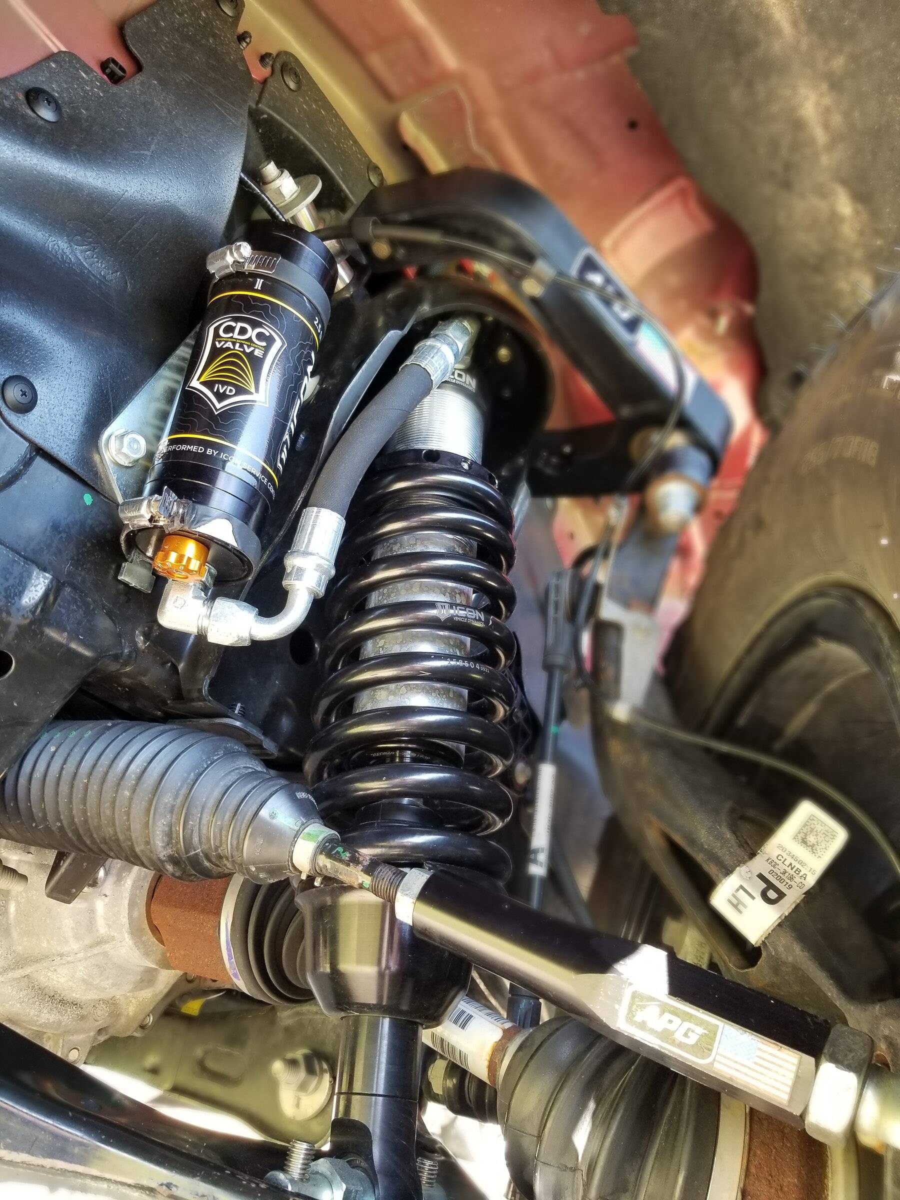

For the most adjustable ...from street and low speed bouncing on rocks to high speed desert racer... the 2.5 ICON CDCV Remote reservoir coilover and Piggy back rear 2.5 , with the ICON WTX Leaf spring pack, is hard to beat.....not cheap.... but worth it for me....King might have been my first choice . But I could not wait 4 to 6 months , all the ICON stuff arrived at my door step 3 days after ordering from Stage 3 Motorsports...
Superdannyboy
Jan 1, 2020
1,099
1,371
75209
I second this.
Wanted Kings, didn't want to wait.
Icon came quick and puts a smile on my face every day. I take the road by the golf course every morning to work just to hit every speed bump. I fly off the highway when there's traffic. It's awesome. When I race my buddies on empty roads in their cars I go off the road too just to have fun. Icon uses a digressive piston. I think I drive too sporty for a progressive piston because I think I would rock too much when turning. When I'm going 20 mph down a residential neighborhood yea I feel everything in the road but who cares. My wife thinks the Ranger is too small anyway so I'm the only one in it, but boy does she complain about the suspension in the f150 because I don't like slowing down for irregularities in the road, THATS WHAT A SUSPENSION IS FOR. lol I just always try to get everyone to buy badass toys.
