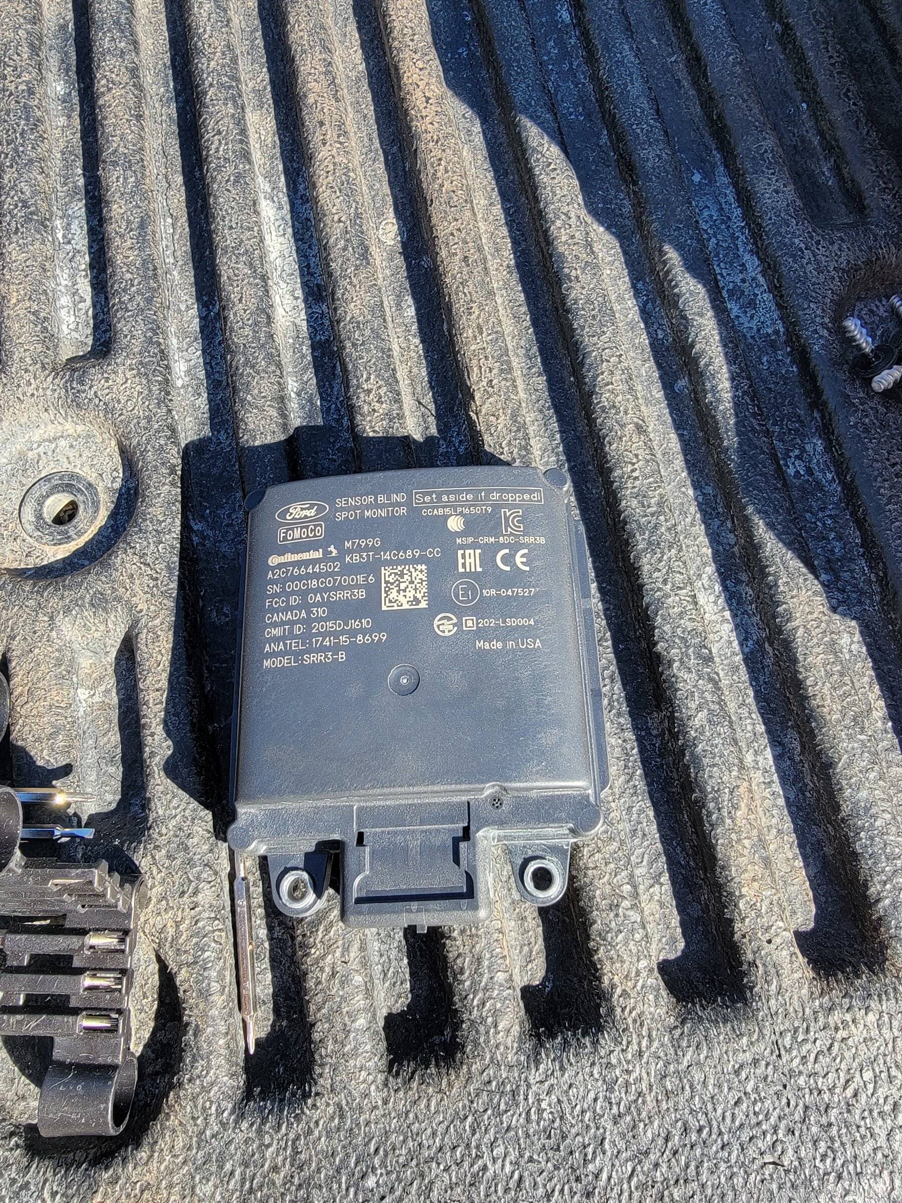

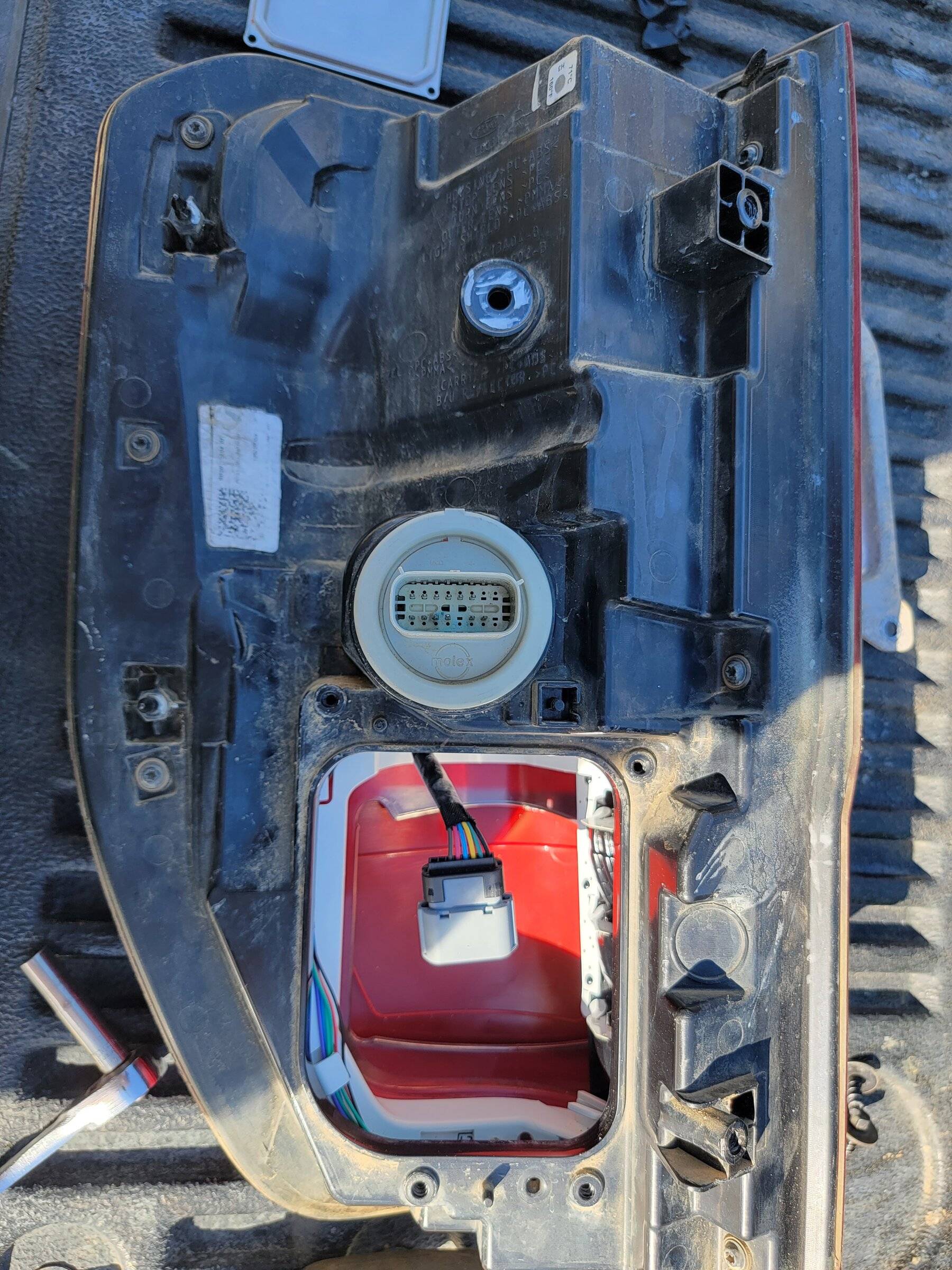

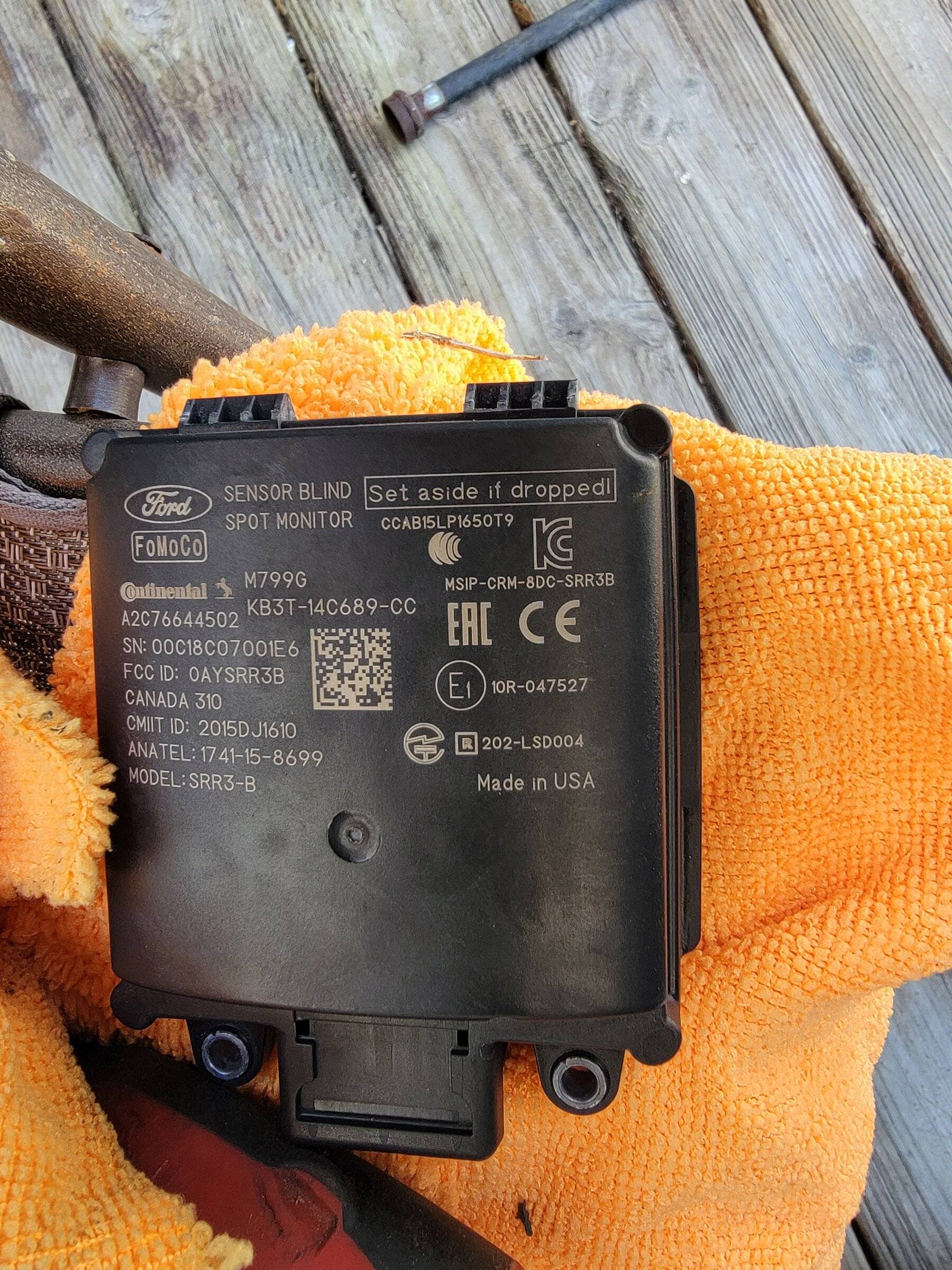

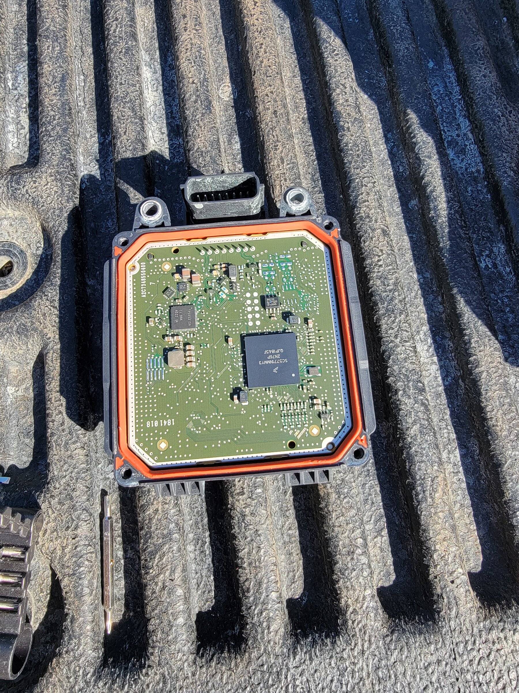

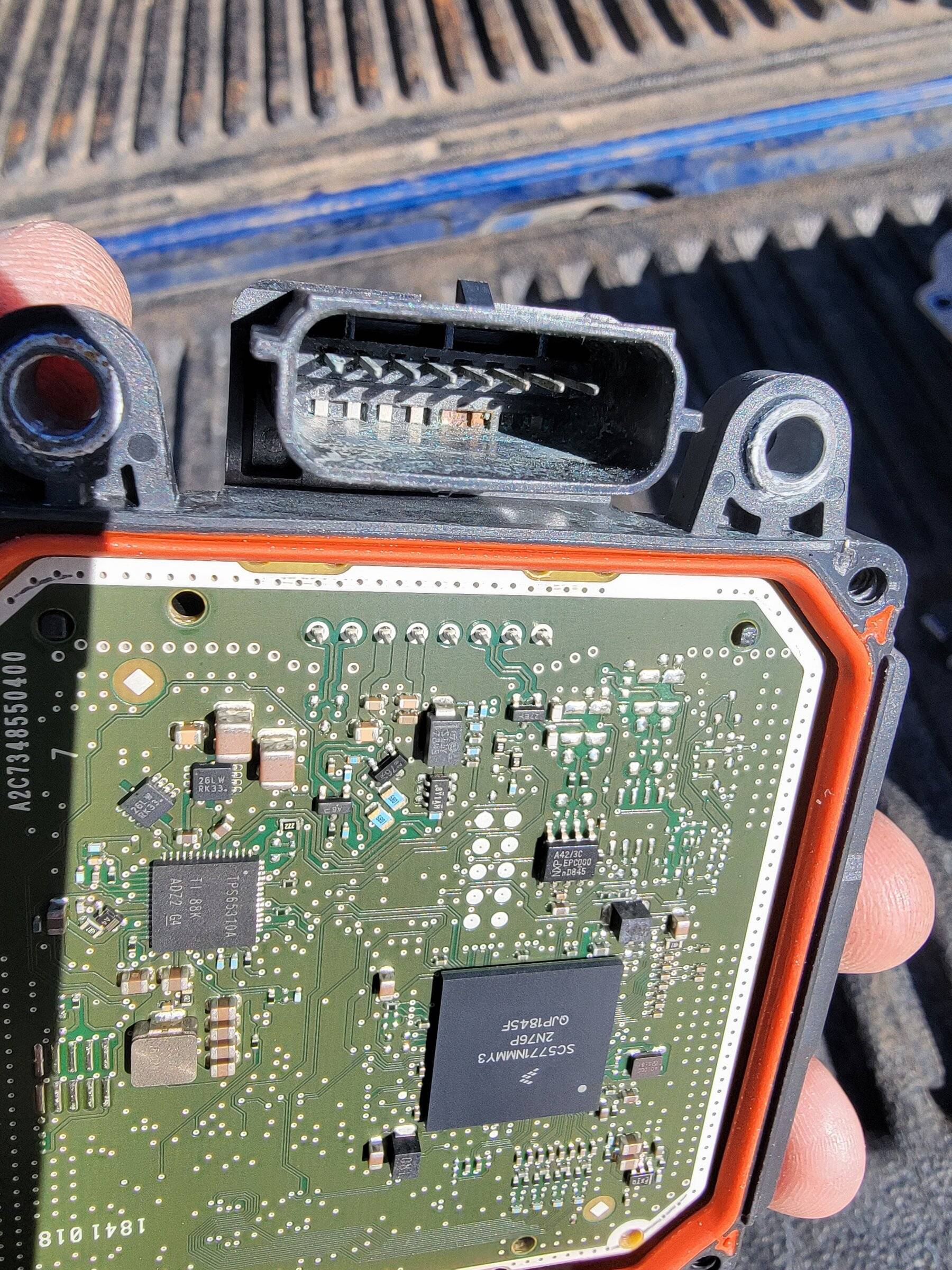

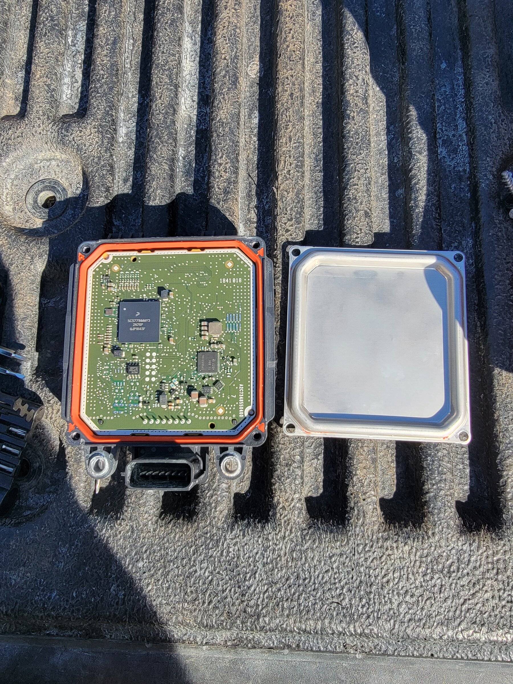

RP is correct. You will need Forscan in order to program a new bliss sensor. Op... Just reuse the sensor you have unless it damaged. Not only that the sensors are programed side specific as I have previously experienced. I have a thread on this from the past. Just search my threads.
Here are a few pics of my sensor drying it out from a cracked lense.
