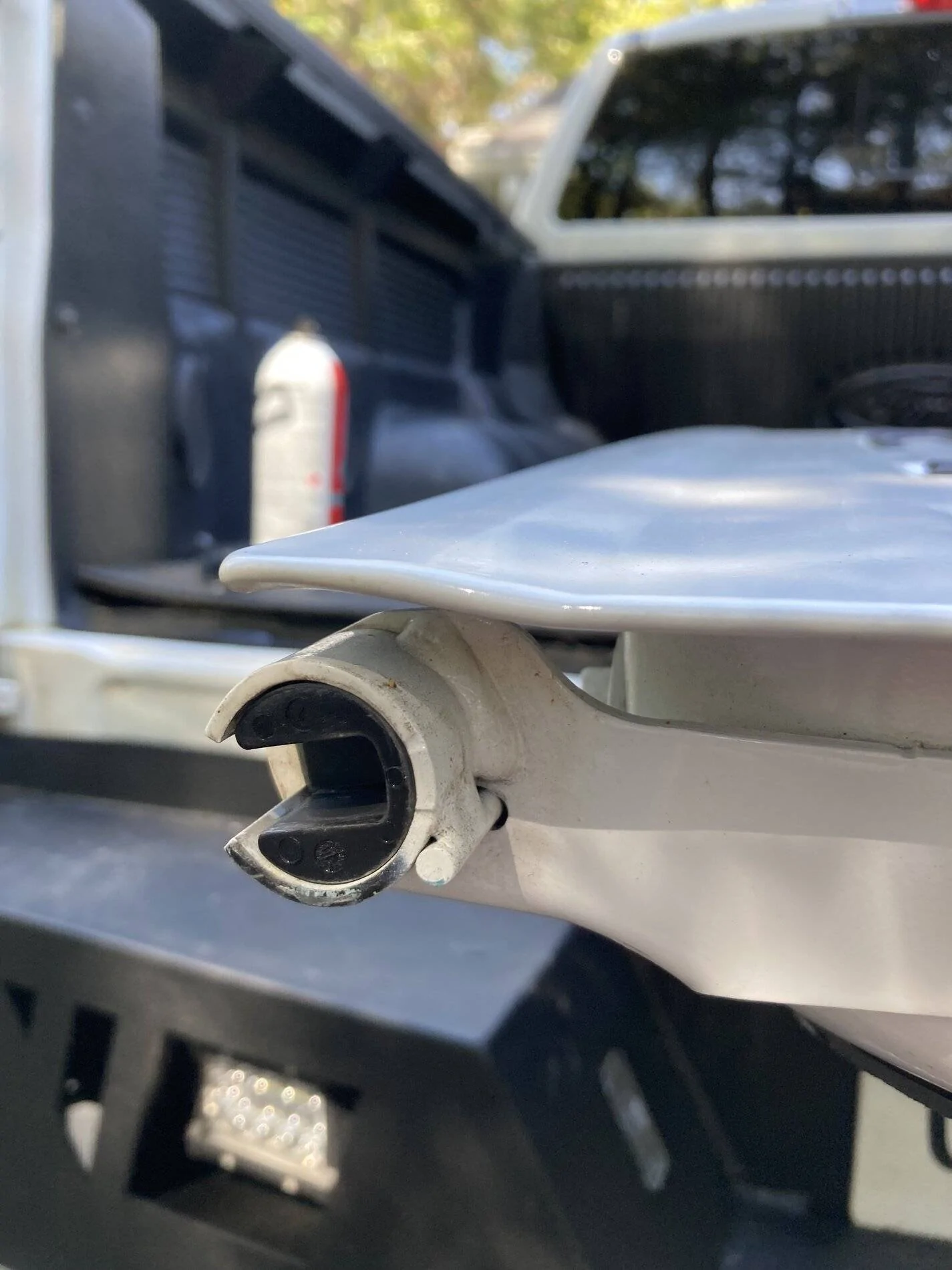

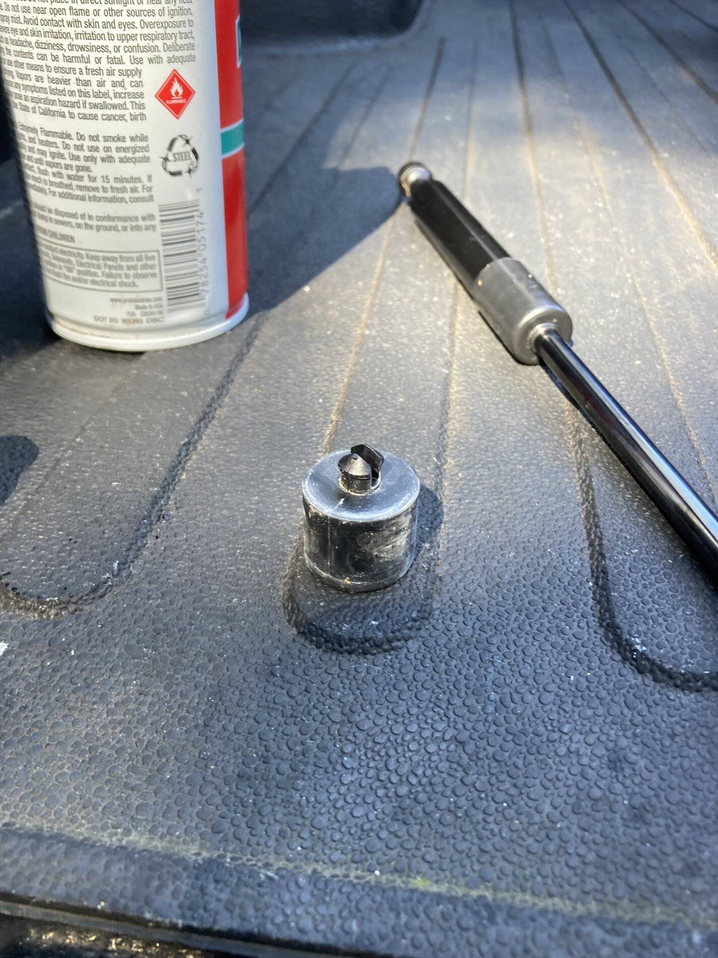

My DeeZee tailgate assist shock has decided to bellow like a wounded ox every time I lower the tailgate.
It's still under warranty but since I purchased it online, I'll have to dig through my CC transactions and see if I can find when and where I bought it.
I'm definitely going to simply remove it for the near term and then search my transactions when I have time to waste on that.
Here's hoping that my arms haven't atrophied away to the point where I can no longer catch that heavy tailgate descending at the speed of gravity. :muscle:
EDIT: See post #11 if you need to spare yourself from digital trauma due to impending damper withdrawal.

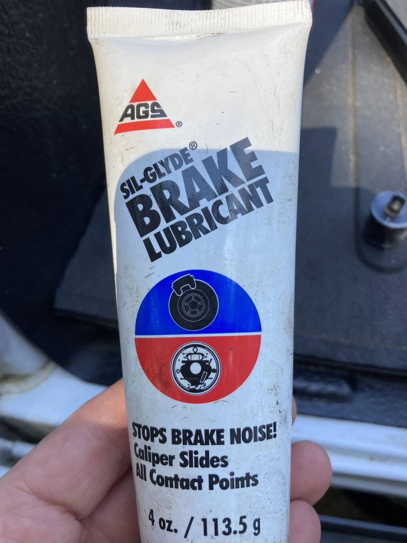

Check the plastic inserts in the tailgate hinges. I thought my damper failed making the same sound. Shot some silicon spray in the hinge and it shut up for a couple days. Pulled the gate and greased the inserts, problem gone!
81
6,999
42,793
Living The Dream
It's resolved.
It was indeed the bushings.
Thanks!
