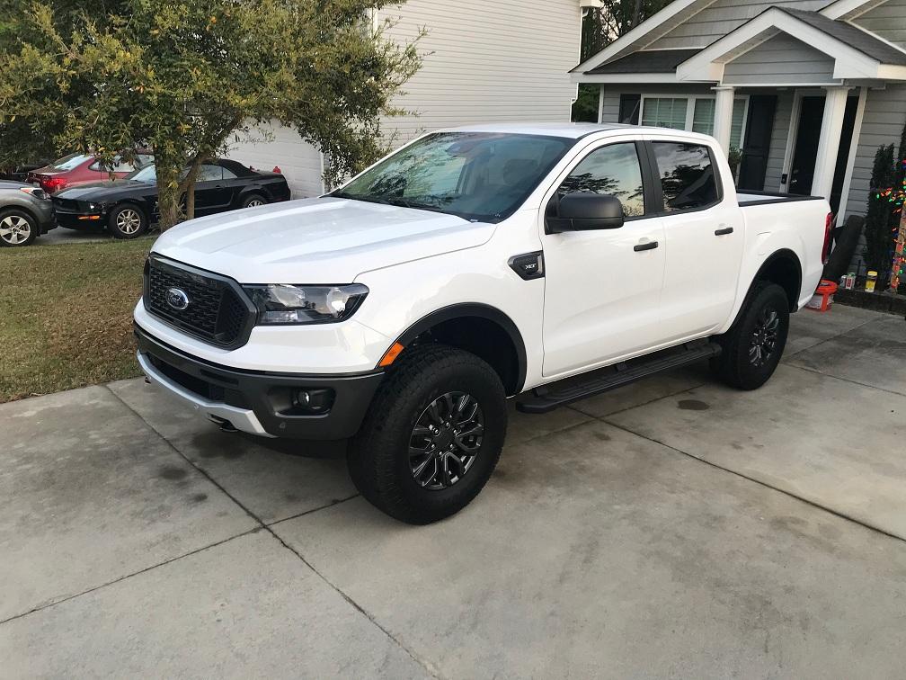

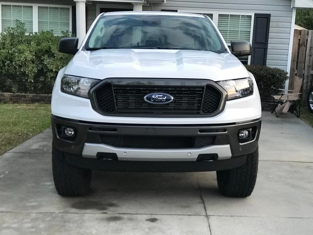

Here she is bone stock, still only has 1200 miles after buying it new 5 months ago. Only mods so far are a de-badging/de-stickering. Next up is Ford Raptor Grill.

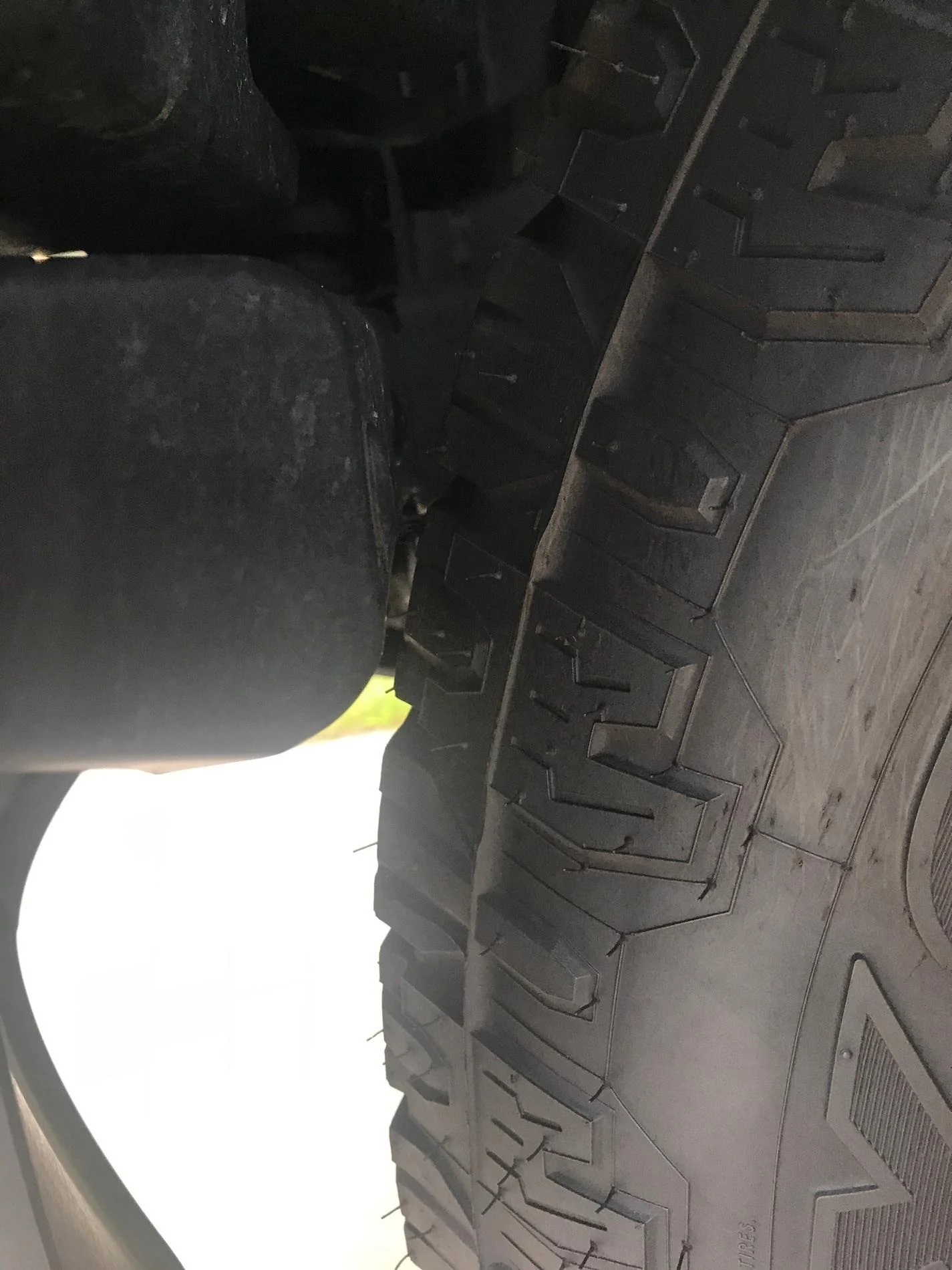

Ford says they installed a 2" Rough Country leveling kit. Well, RC makes a 2.5" kit, not a 2" kit. Maybe he meant Tuff Country, which is even cheaper. And this is the reason I always make a dealer eat the cost on a "lift package". They basically wanted $3,000 for a leveling kit and the tires which maybe cost them $1,000 to buy and install.

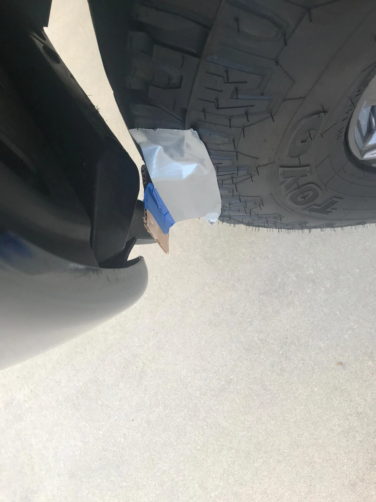

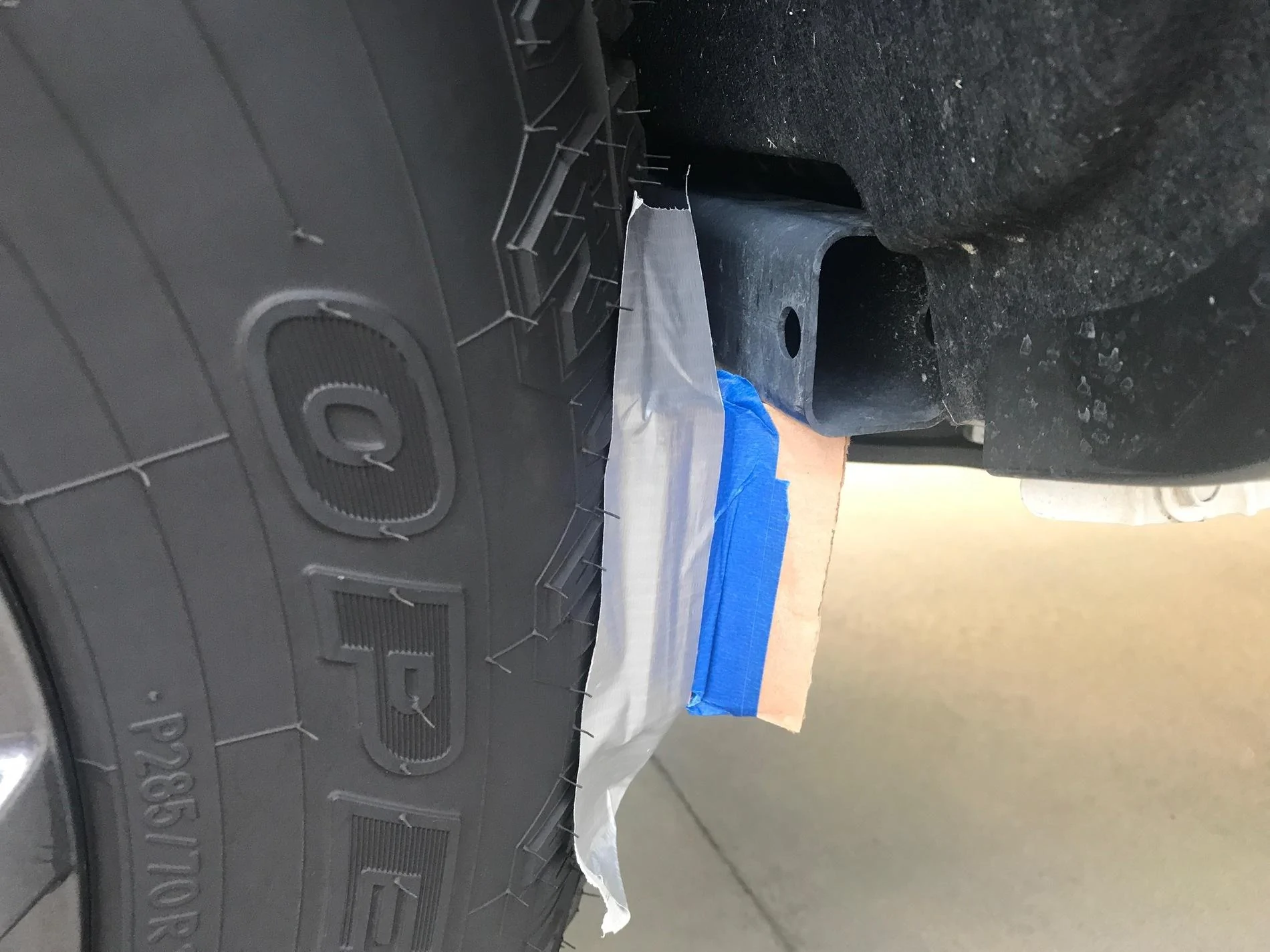

Anyhow, working smarter not harder, I folded a piece of cardboard with a 2" side sticking out and taped it to tire at about the 9 and 2 o clock position then slowly turned the wheel. Yea those crash bars are going to need to come completely out. Honestly 2" may just be too much with that with 285/70 's on here. I'm trying to have to remove the minimum items only and it may require moving the bumper well trim.
Clearance as it stands now:
Cardboard trick:

Reading around on the internet I am also wondering if Ford has some sort of spacer installed already to give it proper clearance. Which would not be a bad thing, even if it something smaller than 1". That would mean I am "over-mathing" my current results, Gonna have to pull the wheel off and find out.

I just put on 285/70's and have no rub with no spacers. Although I'm still waiting on my 1" spacers from Bora. Thought I'd need them. I'll try them when they finally show up and decide from there if I'll put them on.
My lift is the RC
3 1/2" I swapped out my rear crash bars with the BDS. I highly recommend these as it requires no cutting! See my "cringeworthy" post.
All I did was loosen the front crash bars and push them forward. They move pretty far. Took it out wheelin' aired down to 20psi, still no rub.
