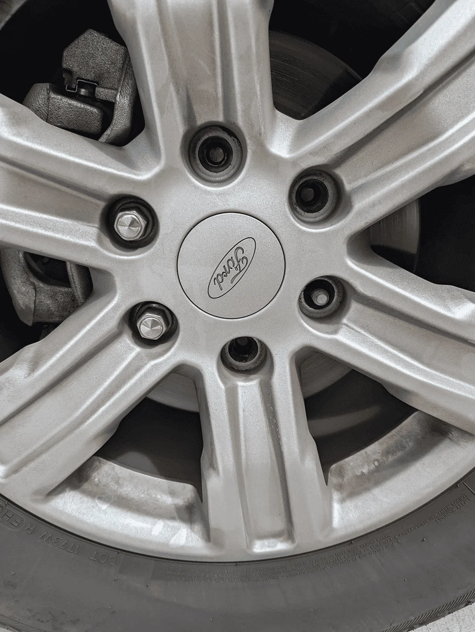

BLUF: I changed my brakes due to a noise problem and a month later arrived home with 2/6 lug nuts and 3/6 wheel studs left on my front passenger side wheel. Nearly f***ing died or killed someone else without even knowing it. This is almost certainly a "novice is an idiot" situation.
So around 3-4 months ago my brakes start making noise. I thought it was weird given I was only at low 40k miles. It kept up despite me being able to see through the wheels and see that the pads should be fine as far as what was left. Not knowing what was wrong and being only on the powertrain warranty, I arranged to use a friend's well stocked and flat garage and flat neighborhood roads to change out all my pads and try to spot the problem.
Changed out the brake pads on all wheels; none of the old ones were near the squealer tab. I did ended up finding some odd rust on the back passenger brake pads. Caliper and rotor appeared fine, so I assumed it was a factory defect or some such since I'm In Texas and we don't salt the roads. And no, this was not where I messed up. I have full memory of doing it, however I must be mistaken and forgot to tighten the front-passenger wheel, did it incorrectly, or forgot to re-tighten it a week later with the others. No, I did not use a torque wrench. I assumed hand tightened with the stock lug wrench was enough. This could also be my problem, but the other 3 wheels are all fine and were treated the exact same.
I was pulling into my neighborhood today and out of nowhere started to hear a rhythmic impact noise. I had JUST passed a construction crew so I assumed I picked up something in a tire and kept heading to my house to take care of it there...
I was missing 4 lug nuts and three wheel studs on the front passenger-side wheel. I just drove around 20 miles at highway speeds to get home. No impacts or potholes, no issues driving TO work that morning whatsoever.
Lucky to have not died on the highway or killed someone else. I screwed up, not making the same mistake again.
I have plenty of PTO and was able to take some for the rest of the week at the last minute. I ordered the parts to replace the wheel lug studs and lug nuts (and a proper torque wrench, jack stands). They are getting here sometime tomorrow. I will be finding out if I screwed up anything else tomorrow or Wednesday depending on delivery time. Going to check the other 3 wheels after I replace the studs on the first, however a quick wheel-on examination shows no signs of problems. I must have forgotten something with the front right wheel.
I'm an idiot, make jokes at my expense. Glad I'm not dead or killed anyone else or totaled on the site of the road.

Thank those last 2 lug nuts for holding on ! Not sure I would trust any of those studs now ? though...
I'm replacing all of them on that wheel and checking all the other wheels.
New wheel studs and a torque wrench arrived from Amazon today. Waiting on the lug nuts and jack stands now.
Edit:
I got all the deliveries in time to change out the (all six) lug studs and get the wheel back on before it got dark/storms started to drench my area. I checked the torque on the other 3 wheels (proper star pattern on all 4, no looseness with the other 3) and drove it about 5 miles without a problem. Going to check the other lug studs visually tomorrow morning and assuming they are all good return to regular driving on Thursday. And yes, I will re-tighten/check with the torque wrench - both tomorrow and Likely at each destination for the next couple days. I'm leaving the torque wrench in the truck for now.
If anyone else has to replace theirs for any reason, make sure you use a good sized/weighted hammer to get them out. I had to use a metal 3 pound cross pein hammer (flat side) to get them loose enough to remove. Regular hammer and a screw driver was NOT enough.
