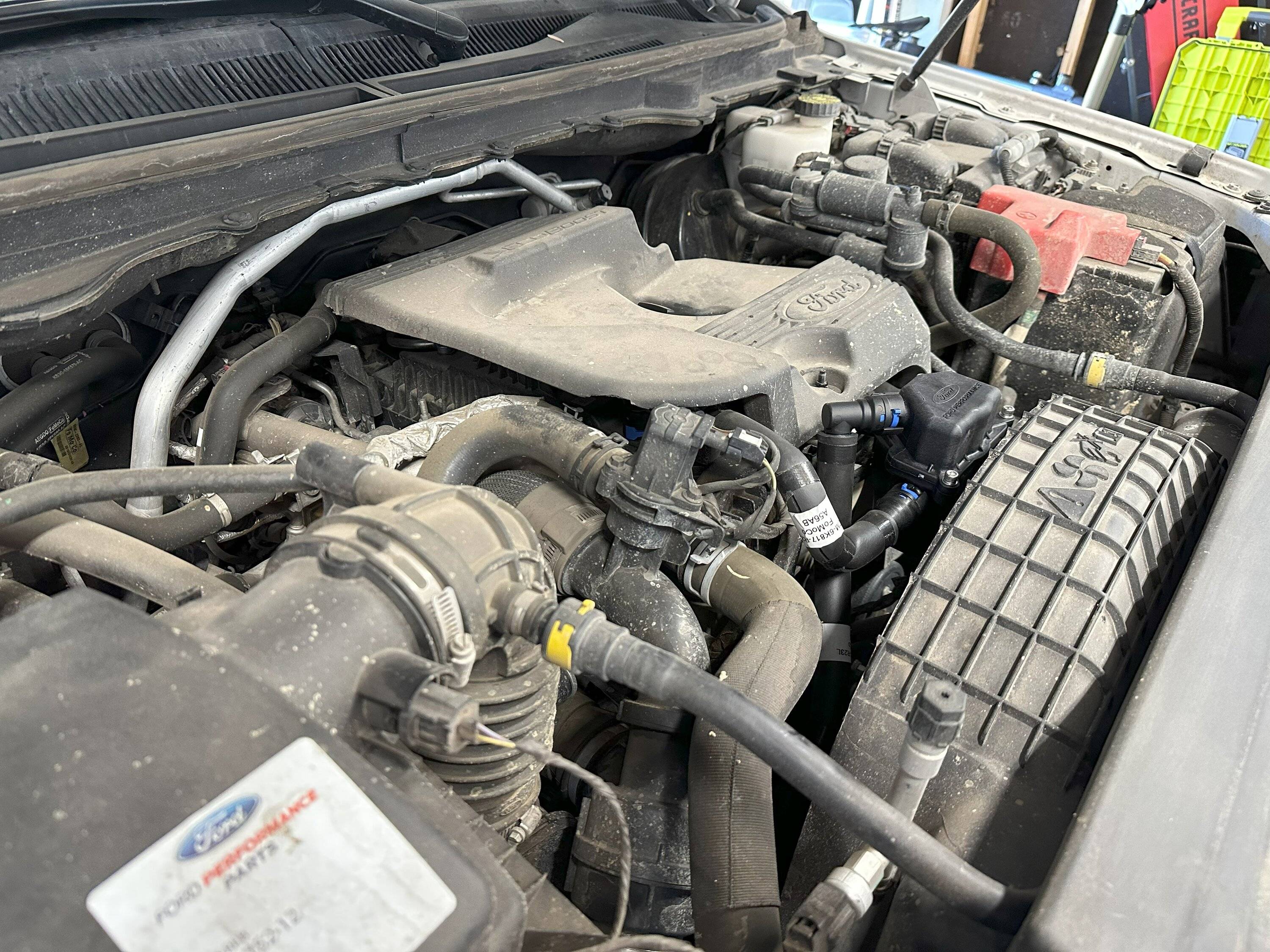

I didn't know Ford made these! I just ordered mine (M-6766-B23 ) on the Ford Performance site. With my rewards points and the discount code it came to $79!! I can't wait to install it and have one more thing to maintain! :p But the benefits of reducing carbon build up on the valves will be worth it.
Before you start your install check that lower hose. If its P/N ends with B23L, do not install. Call Ford Performance for the R23L hose. Neither kit Ford sells is a direct fit for the 20-23 Ranger. M-6766-B23 as the wrong lower hose and M-6766-R23 has the wrong upper hose.
Update: Ford has added a new part number for the 20-23 Ranger: M-6766-R23A
My hose was wrong, I called and was told to send an email with the info with my receit so thats what I did. Waiting now for a reply, thx

The interval I drain my catch can is about 1200-1500 miles roughly every two weeks right now. I think only draining the FP unit at oil changes is asking for trouble.
I have had my FP oil/air separator installed for six months but nothing is being caught in the reservoir. My 2019 Ranger has the version with the sensor. I live in California - is our warm weather the reason? Or did I install the unit incorrectly?

Okay guys, here's an update on emptying the Ford catch can. I unclipped the 2 hoses and then preceded to empty the can for the first time. So now my curiousity gets the better of me so I remove the allen screws to actually look inside the can instead of blindly dumping it.
It contained a little water and a brown substance on the bottom. Now I know myself, I will never be satisfied to just dump it, so I've decided I will always remove the allen screws to empty the can.
This was after maybe 2000-2500 miles during the summer, I expect more moisture in the winter months. Removing the allen screws is quite easy and you won't break the clips.

What is actually on the inside of the can? Baffling, a screen, or nothing at all?

On the top of the can is a metal filter/screen that the contaminents flow thru. Its removable and can fit only 1 way. The rest of the can is a hollow plastic/abs looking material

Just cleaned mine out yesterday after 3000 miles which includes a 1800 mile round trip to Reno. No actual water droplets just small amount of oil and water mixture about a teaspoons and a half. Now that snow is on the ground I’ll check it at 1000 mile intervals. I pull out completely then disassemble and clean.
Has your oil level on the dipstick gotten any higher or stayed in the same spot?
