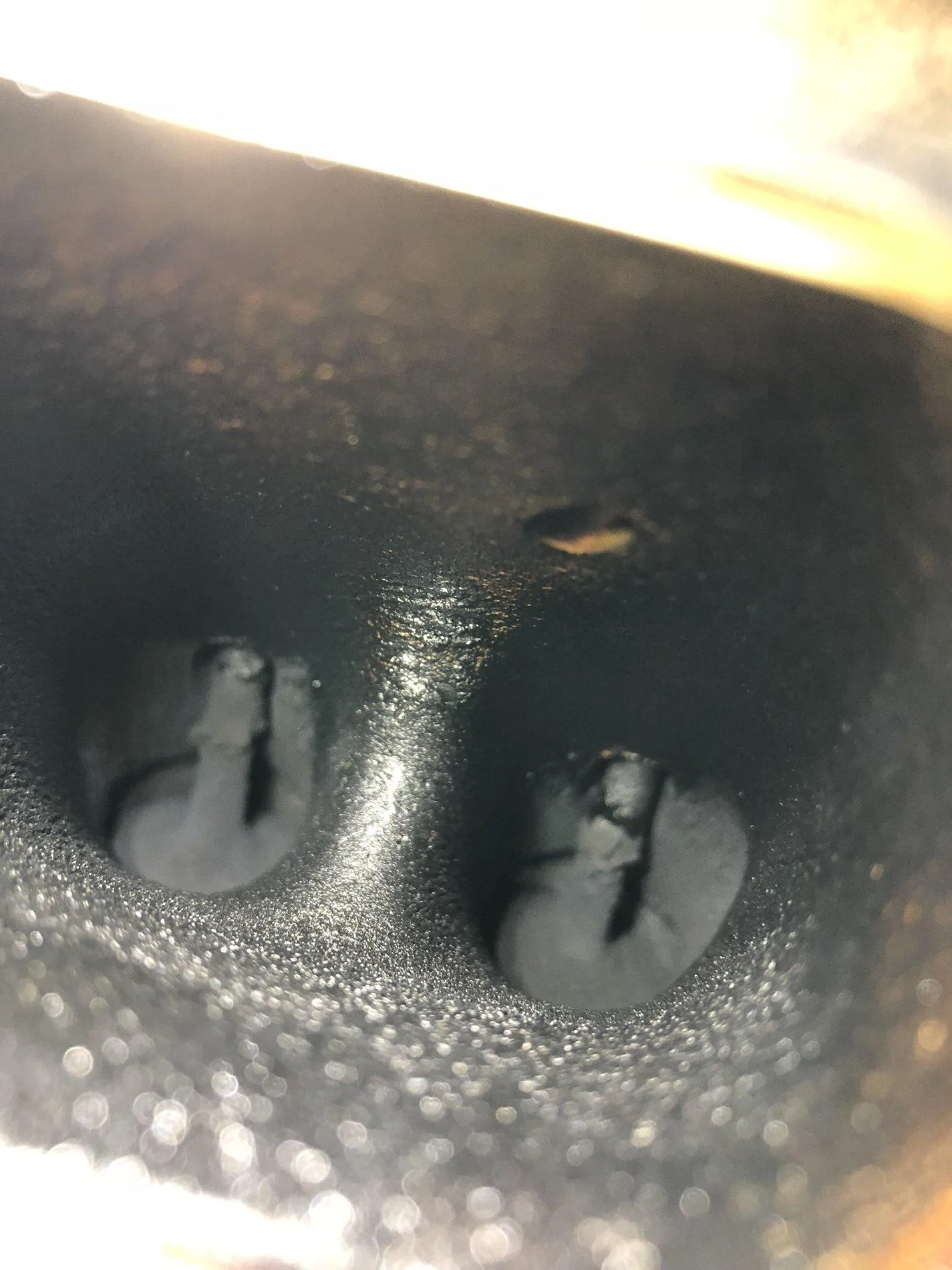

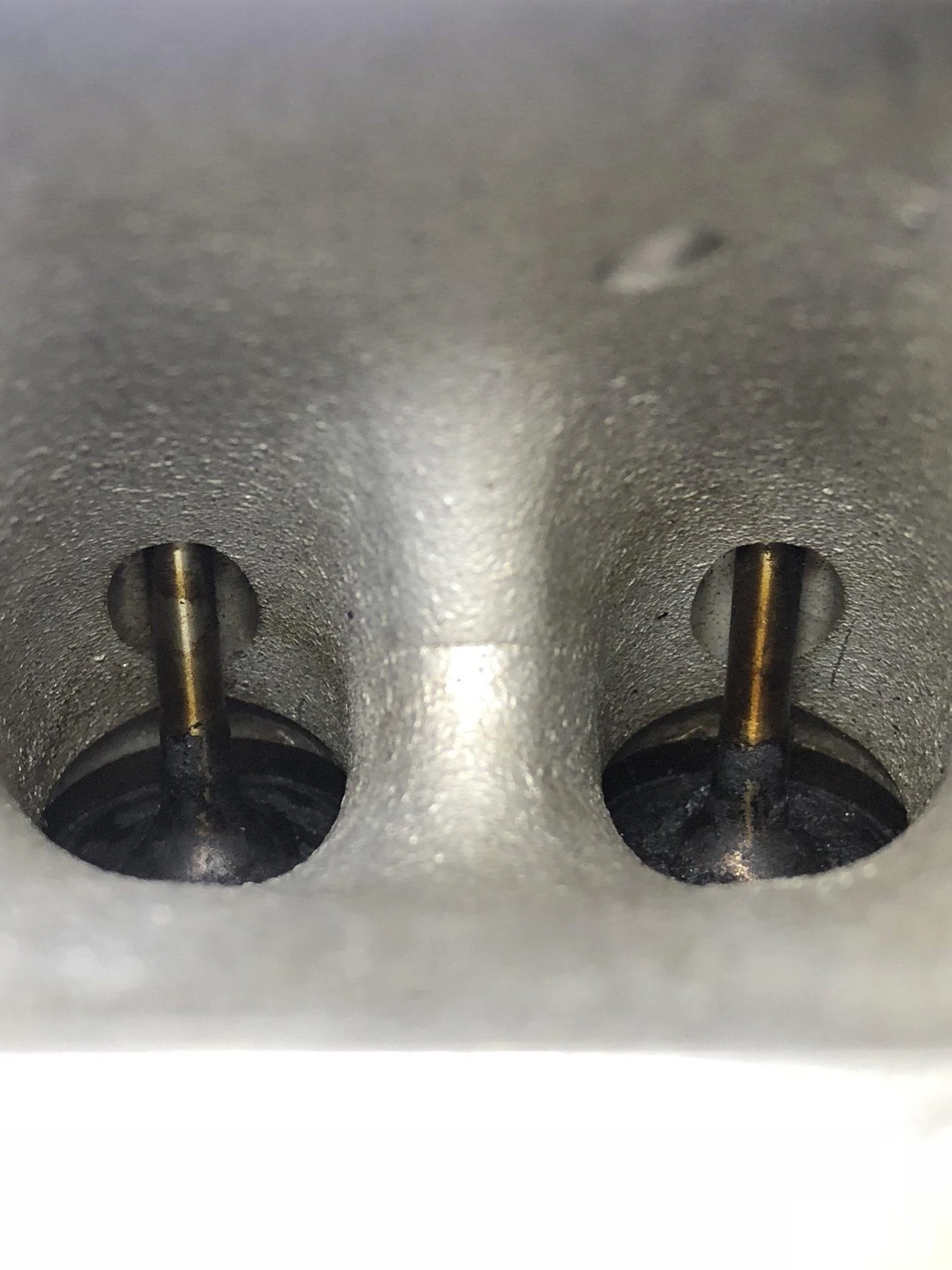

FWIW, I have been using the aerosol top end cleaners in my vehicle engines since the early 70s with no detrimental effects. And that included approx 750k miles on turbo vehicles starting in 1985.
I have seen several videos where they removed the intake manifold and photographed the intake valves then put the intake back on and sprayed in the top end cleaner (seen videos of the CRC and Seafoam) then pulled the manifold afterward. In all cases it did not remove all the carbon build up but in all cases it made a very noticeable improvement. The consensus was using these cleaners on a regular basis will keep the carbon build up at bay.
I started using the CRC GDI Intake Valve cleaner on every other oil change starting in 2011 with my wife's new 2012 Focus. The Focus was not a Turbo but my 13 Focus ST, two Ecoboost Mustangs and the Ranger are. Between all those engines I have accumulated close to 200,000 miles and never noticed any degradation in performance or idle quality. I had purchased a bore scope to take a look down the intake manifold on the 17 Ecoboost Mustang but traded it in before I got around to it. Haven't done the second oil change yet on the Ranger but will use the CRC on it.
After reading through this thread I have a few comments:
1. I wouldn't recommend spraying the cleaner in through the air box. There are to many direction changes, and pockets between the air box and the intake manifold for the material to drop out of suspension and not make it to the valves. On my Focus ST I removed the hot side pipe at the throttle body to spray in. On the Ecoboost Mustangs I removed the hose from the manifold to the Catch can and sprayed it in there. Have not scoped out the best place on the Ranger yet.
2. Some folks are concerned about chunks of carbon breaking off then going through the engine and damaging the turbine wheel in the turbo. This stuff dissolves the carbon build up so there are no chunks associated with it. Plus under normal conditions the carbon can break off and go through the engine at anytime. I have never heard of a turbine wheel being damaged by carbon.
3. Folks are concerned about the solvent in the cleaner damaging seals. The seals in a turbo are made of a ceramic like material that are impervious to automotive solvents. Plus if you are following #1 above the compressor side of the turbo never sees the cleaner and on the turbine side it is burned hydrocarbons just like your exhaust is all the time.
Now with all that being said; a buddy of mine just traded in a 14 Focus ST with over 120,000 miles on it. This car never saw anything but the cheapest 87 Octane gas he could get and oil changes were done at 10k miles with conventional dino oil. The car was running as strong and smooth as the day he bought.

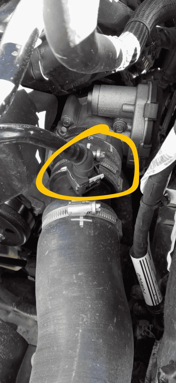

So you mentioned you haven't scoped out a good place to spray on the Ranger. Any ideas ??

There is a line attached to the hot side hose right in front of the throttle body that seems like will be a convenient spot to spray in the cleaner. I would like to use one that is after the throttle body but if there is not one to easily get at I will use the one mentioned.
[/QUOTE]
Something like this?? 2.7EcoBoost recommended??
