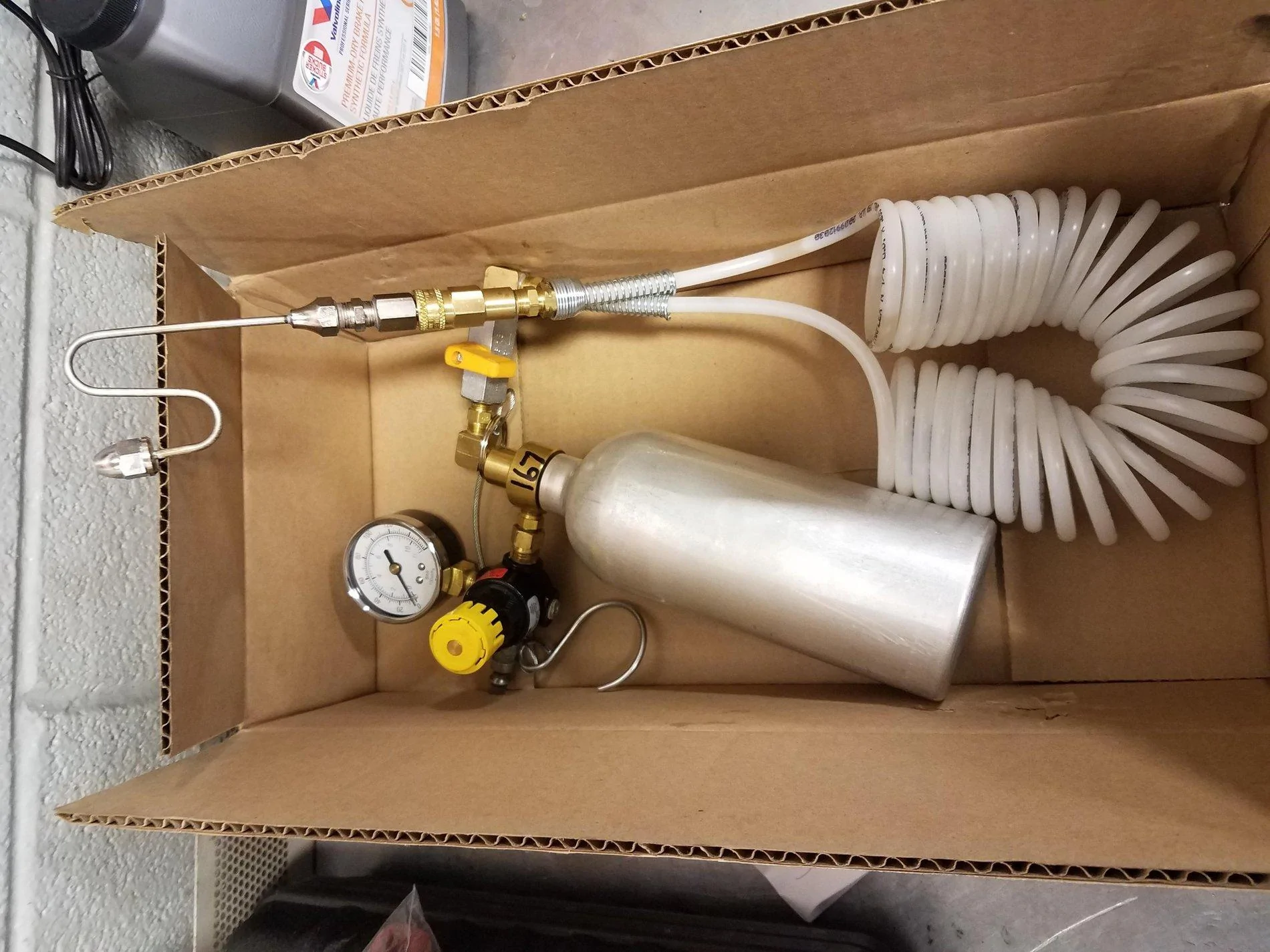

Oh yeah, I think the service I'm thinking of uses a pressurized bottle and sprays directly into the intake manifold through the throttle body. So it would only pass over the valves and then be immediately exhausted through the combustion chamber.
This is what it looks like, This is what I use.

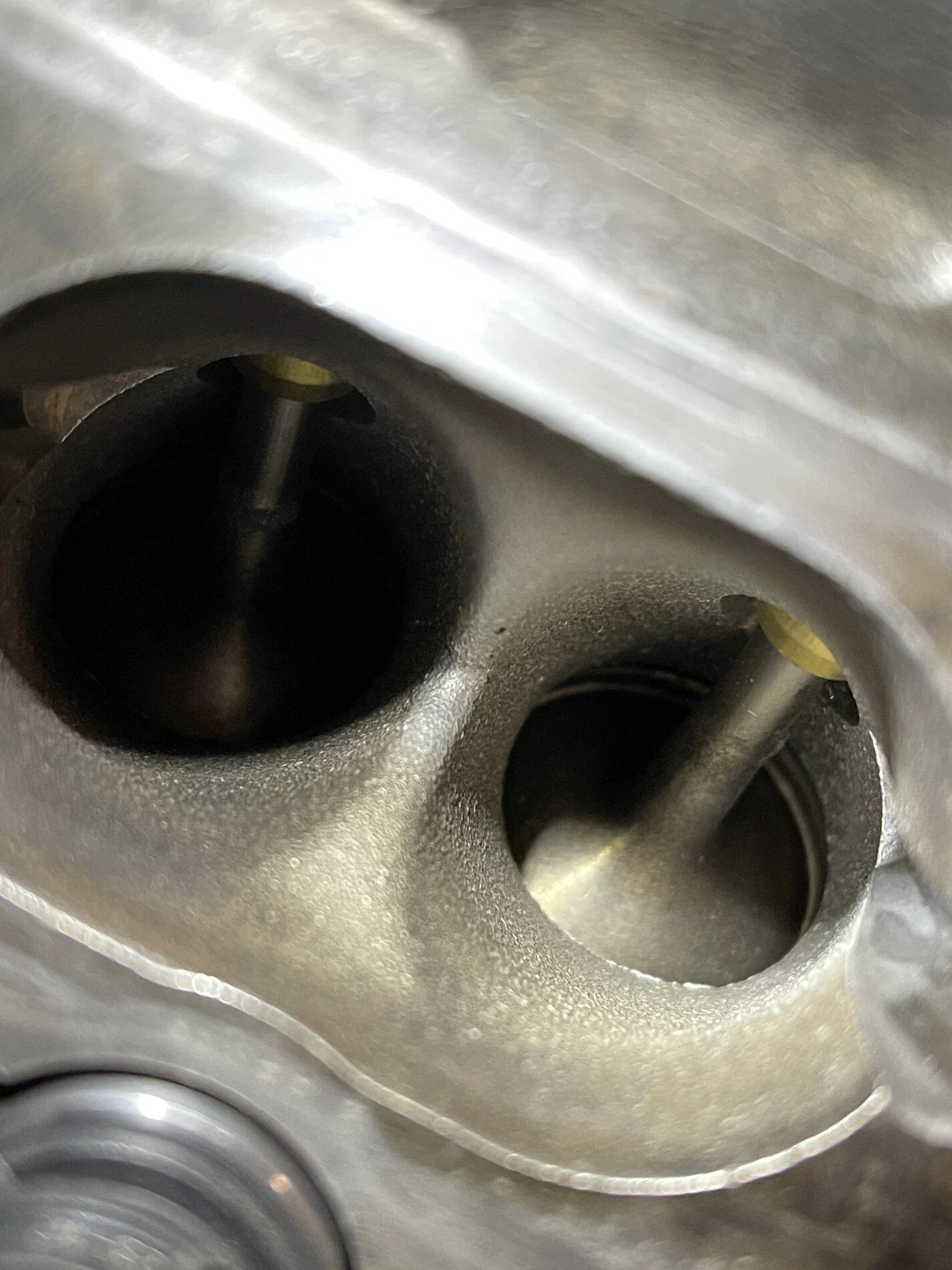

Looks like it will become a necessary maintenance step with our vehicles. Do you use BG products at all? I'm curious if the BG injection service would help prevent this build up in order to postpone the need for walnut shell blasting.
We do have the full BG intake valve cleaning injection system. It uses shop air to spray a fine mist into the intake manifold while the vehicle is running. The biggest problem I see is that it is connected to a vacuum line, usually from the brake booster. Which is almost always at one end of the intake manifold. Therefore you do not get an even distribution of the cleaner on all of the intake valves. When we perform a walnut blast cleaning the results are definitely noticeable (smoother idle, no misfires). I can’t say that for any of the chemical cleaners. Once I remove the intake manifold I usually fill the intake runner with BG GDI cleaner to soften up the deposits. This helps the walnut buster do it’s job a lot faster with less mess. You have to do companion cylinders as pairs and tape off the intake runners that are open. Then turn the engine over by hand and repeat the process on the remaining cylinders. Definitely a labor intensive job but not all the difficult l.

What’s the approximate cost of a job like that on a 4 cylinder?
Ford’s current labor time is 1.3hrs to replace intake manifold gaskets. Gaskets list for $3.87 each. Most shops will probably charge around .5hrs for each cylinder runner to be cleaned. So looking around $350-400 total.
