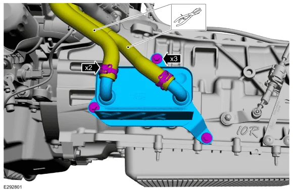

OIl Cooler Ref:
Pictured are the Engine Coolant Lines, so they would have to remove the Oil Cooler and tap into the lines going into the transmission.
Note: Just upstream of this is the control valve to supply engine coolant to the oil cooler.
Then I think they flush the Oil Cooler Itself, before reinstalling. (?)

OIl Cooler Ref:
Vague doesn't even begin to describe that procedure. The note at the beginning seems to indicate thay this proceedure doesn't even apply to our trucks. We have a "plugin" cooler. They tell you to refer to the instruction that came with the machine? WTF
The only thing you showed that even applies to our truck is the picture of the cooler. The yellow lines are engine coolant lines. The oil connection to the transmission are behind the cooler with a couple of fixed tubes and o-rings. So, this would need to be removed to hook up any kind of lines to the transmission. Including opening up you coolant system.

For $250 I'd have to assume that the coolant tank as shown in the pic might be unbolted and moved aside giving access to the ATF connection , but the concern I would have about the pressure flush is that if the filter is doing it's job it collects particles and for $250 that couldn't involve changing the filter and the flush may well circulate stuff the filter collected - but back to the OP post - they did change his filter hence the higher cost paid, in the end maybe have been a better way to go.
