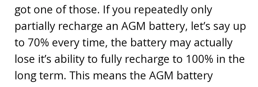

One good thing about going to a traditional lead battery is the alternator can send full charge to it at all times (factory setting with AGM battery is vary alternator output to keep battery around 80% charge) and it won’t reduce battery life like can happen with AGMs getting 100% charge all the time. At least that’s what Google taught me…?
To take advantage of sending a constant full charge from alternator to a traditional lead-based battery, you can either unplug the sensor on the negative battery post OR if you want ASS still activated you can modify the battery charge % setting in FORSCAN so the alternator will not vary output.

Found this regarding AGM batteries. Could this be why they are dying prematurely? Makes you wonder what Ford is thinking with their settings. Mine will be on tender charge forever, and have increased to 90% with Forscan.
