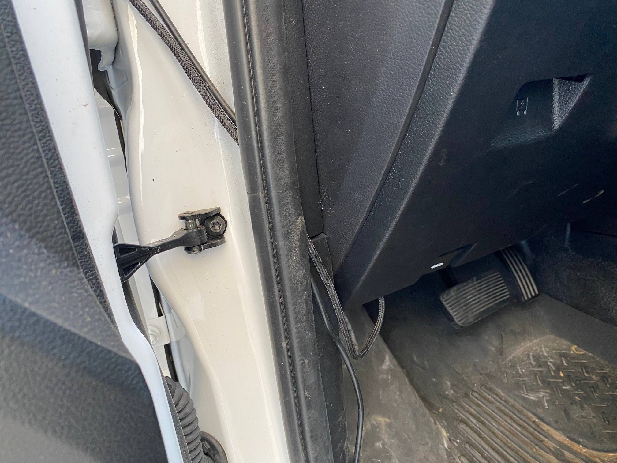

Can anyone who routed wiring along the drivers side of the hood through the door vs through a grommet in the firewall share how they did it? I went along the little channel in the hood that comes out to the door and then passed under the weather stripping. after it rained i noticed a puddle in my husky floor liners. I just have 2 wires to route into the cab, my trigger 6 and gmrs antenna.

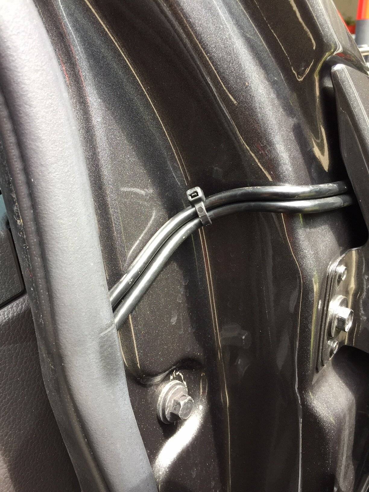

I have antenna cables coming the same way... but I think you're diagonal lead in is what's drawing rain water inside...
I crossed into the cab as high as possible (above the first fender bolt) and horizontally...look in my build link (below) for pics...

Looks like some pretty heavy wire impacting the door weather strip / seal. I would not bring in wiring that way.

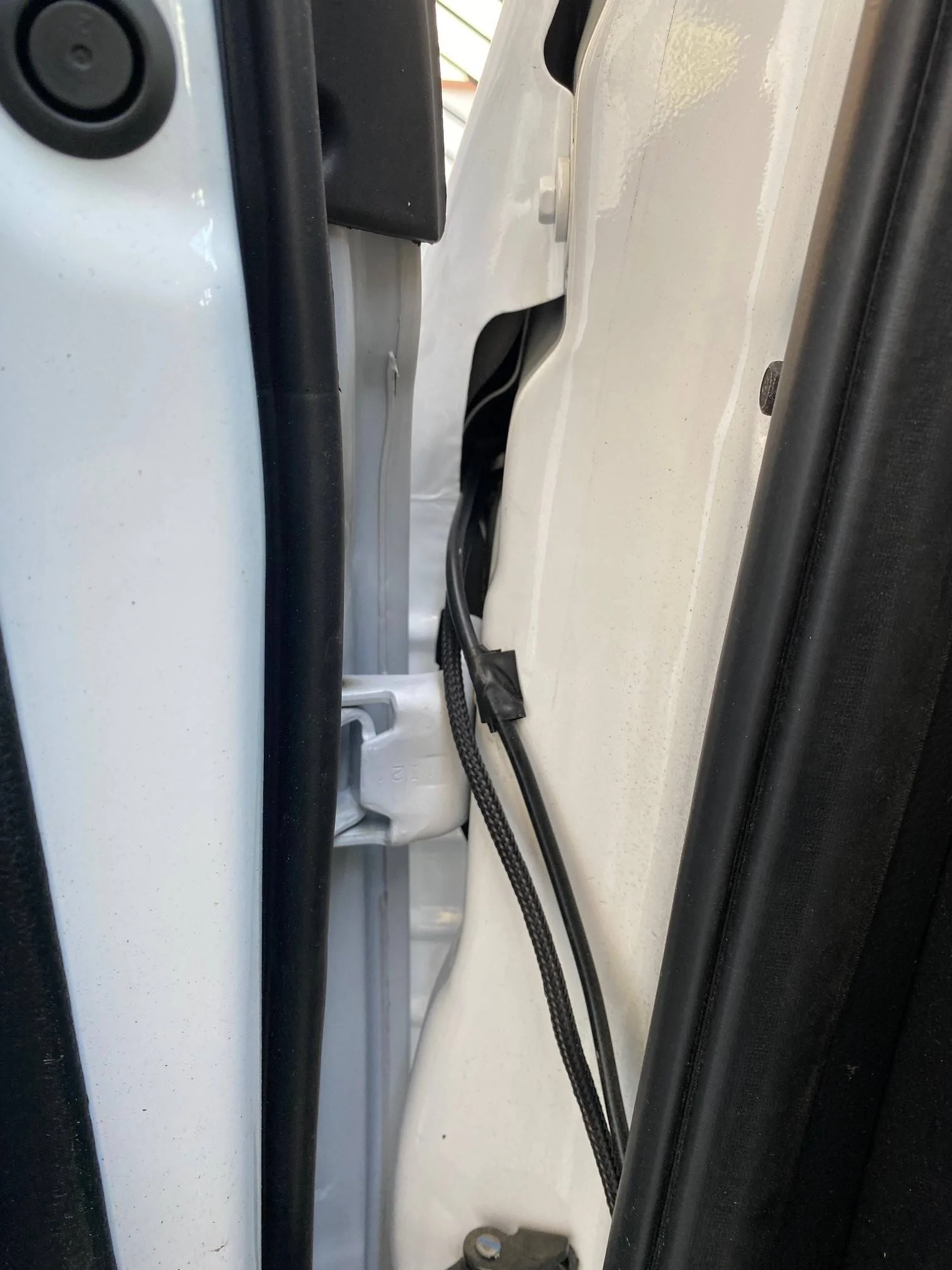

It's fine...the reason I brought my antenna cables in the same way is because I didn't want to cut the factory connectors which is too big to fit through grommets...

thank you for sharing this. I was digging through your build and couldn't find a picture, this is helpful
