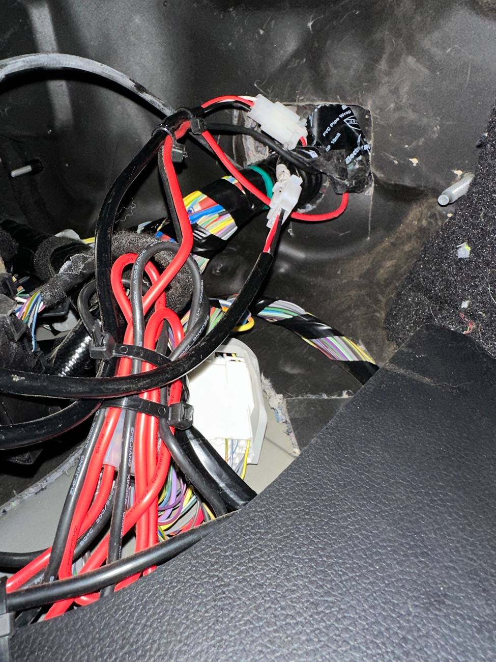

okay perfect that is just what i wanna hear! do you have pictures of behind the dash?

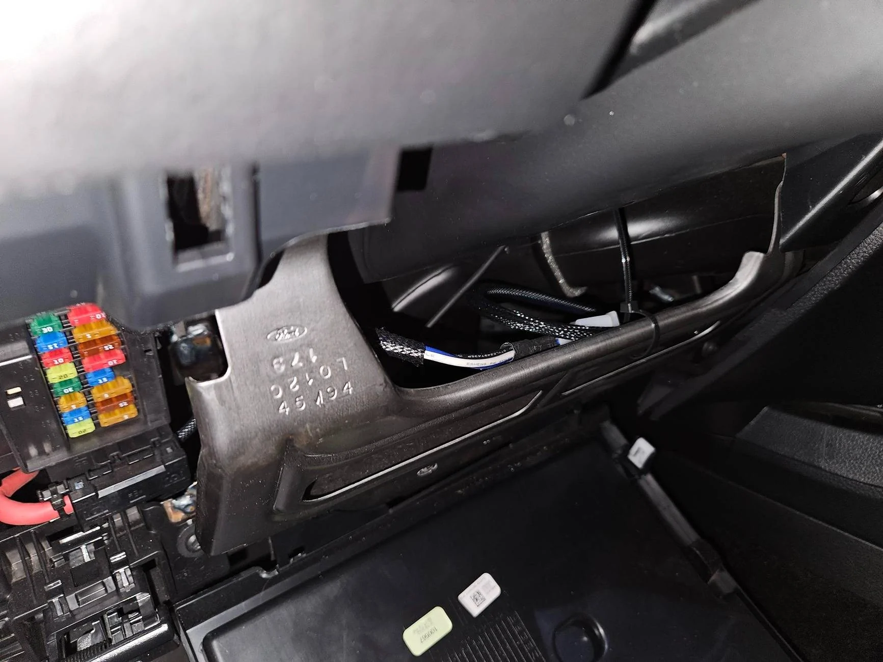

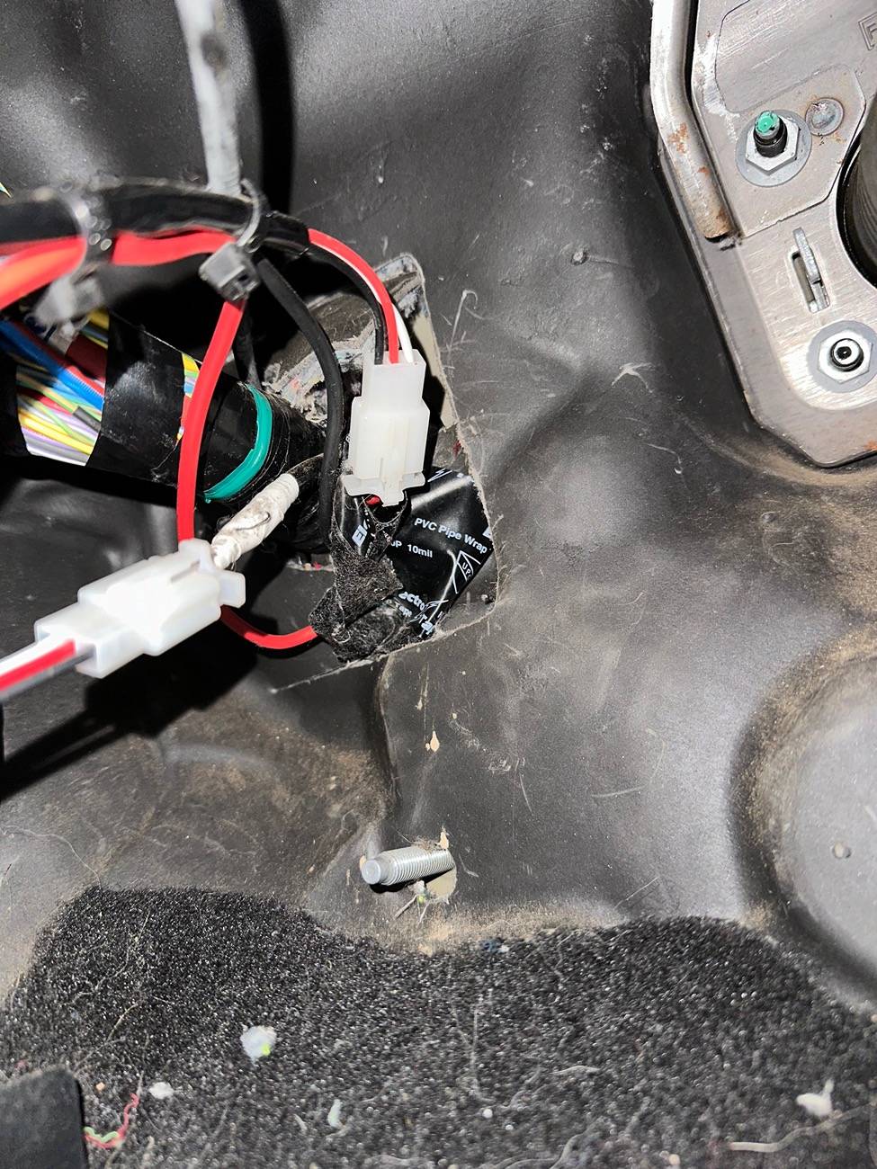

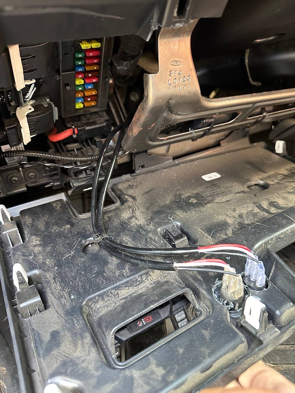

I didn’t take pictures but I can try later when I get home. I installed the switches for my lights next to the existing controller for the stock lights. I basically followed that wiring harness. The only panel I needed to open was the cover for the fuse box. Poking a hole through the plug in the firewall was difficult because it’s up behind the pedals. I’ll try to get some good pictures for you.

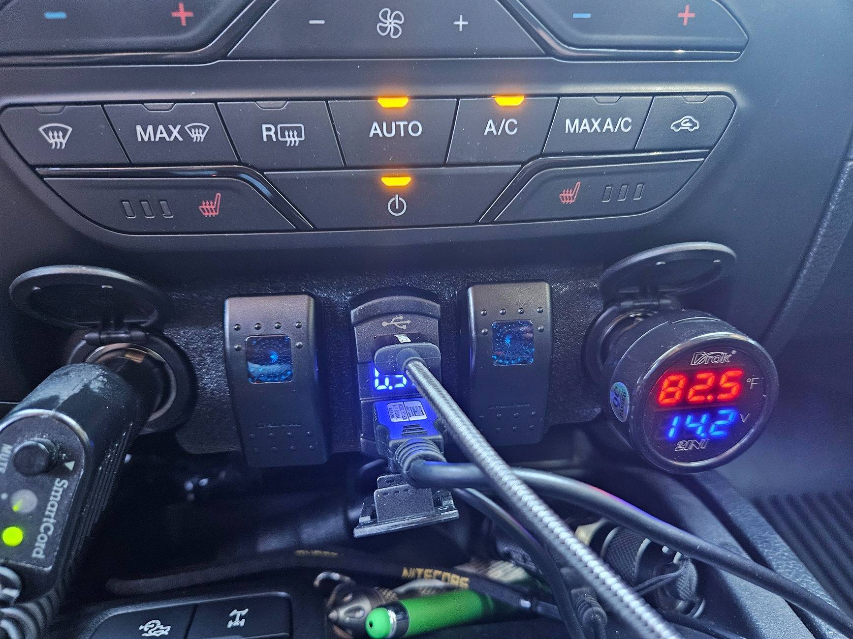

okay thank you so much! I have run some small ditch lights and my switch is actually in a near area (on the fuse box door)

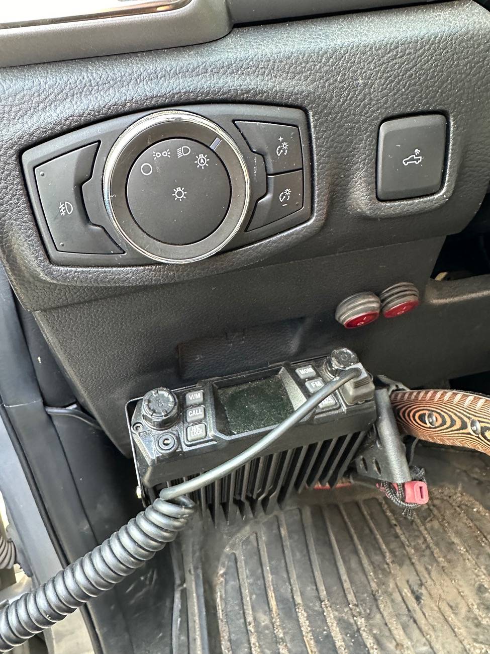

Not the greatest pics but gives you an idea. I realize the rats nest of wires looks terrible but I wasn’t going to spend the time and effort to cut everything exactly to length and redo connections lol I have a GMRS mobile radio in my truck so that’s what most of that wire is. I can’t see it when I tuck it under the dash so it doesn’t bother me ?‍♂
