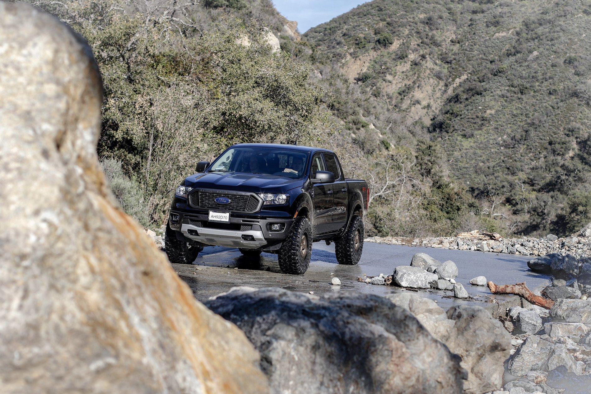

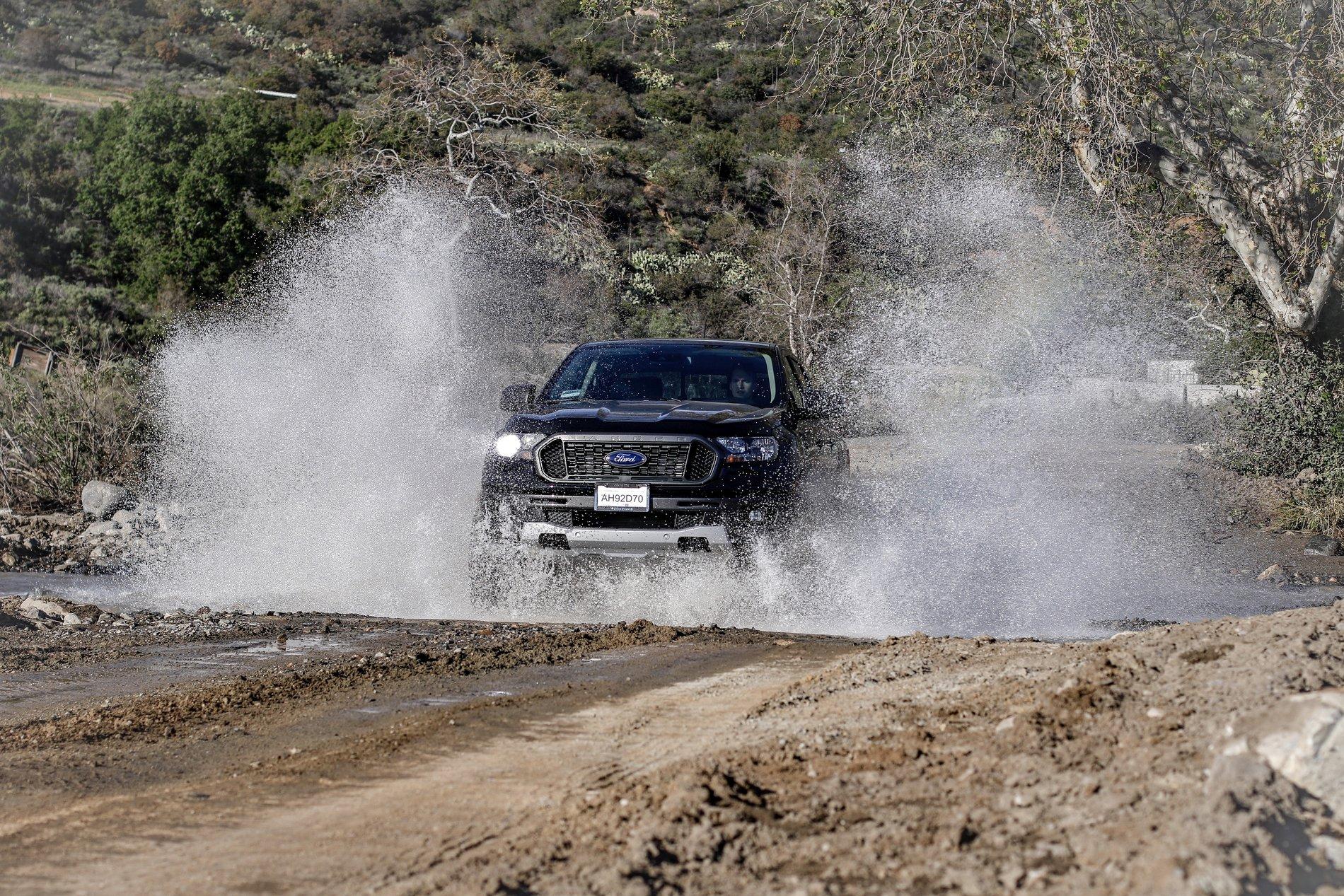

Took the Ranger out in the mud and blasted through a river over the weekend, IT WAS AWESOME!!!
You’re making me hella jealous man! lol
Even if I get the truck looking as good (and functional) as yours I’m many months away from being able to play like that ... a whole lotta snow needs to melt before we can even see our trails!
