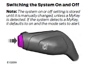

Out of curiosity, are you on the latest version of software? Did you do a system reset? These settings should take to what ever you set them at and remain that way. Not sure if you’re selecting these changes while system is active or switched off from the turn signal switch. In mine I make adjustments while it is off. Then switch it on and they’re good. Hope that helps

Bruce, I think you need to hit the end of the turn signal switch which will turn it off if you want it off. Bret

are you using a key set up to the My Key functions?
Yes I am using the my key function and I discovered that when I disable
yes I am using the my key function and I discovered that when I disable the my key the lane keeping mode stays as I have selected “alert and assist”
thank you all for your input!
