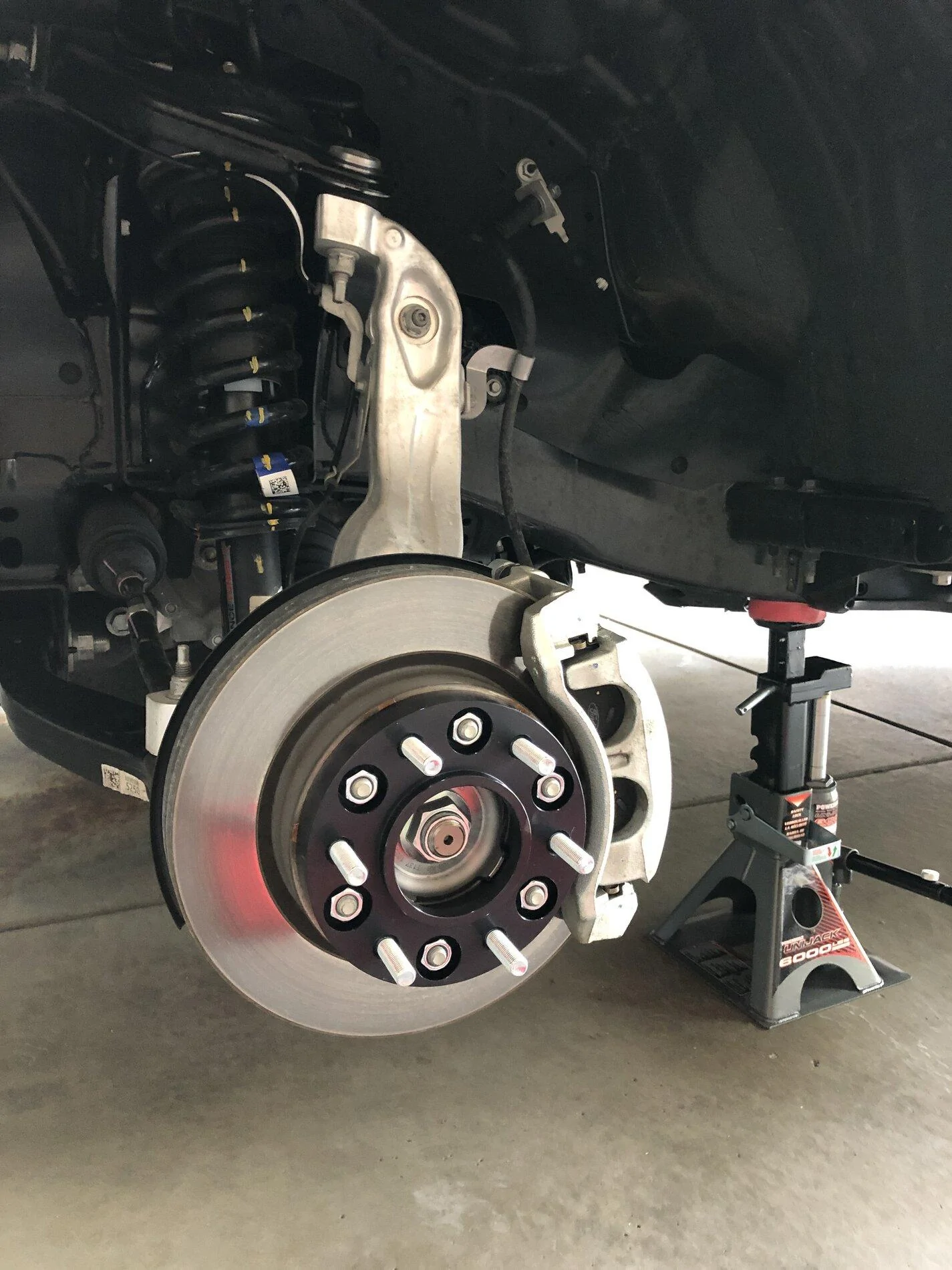

Is that a jack stand and bottle jack in one. Where did you get this. I need one
Yes it is and all the info about it is in the link I attached above the picture. :cool:
