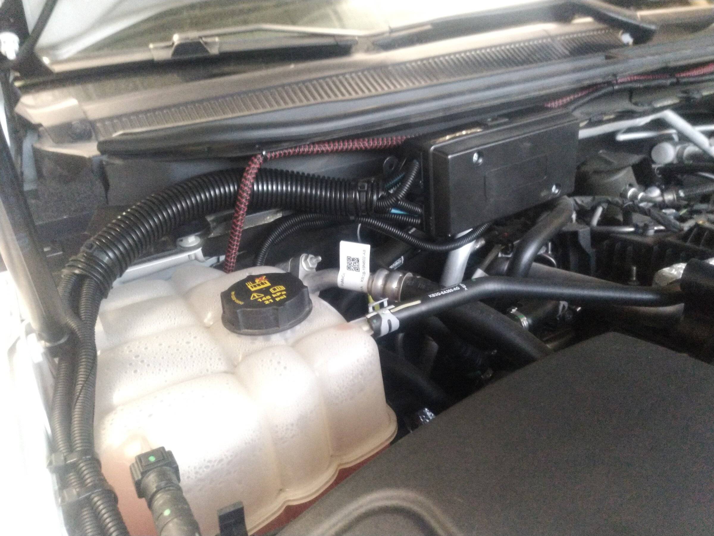

Is it more common practice to tap it somewhere in the harness, or just tap the line right before the bulb socket?

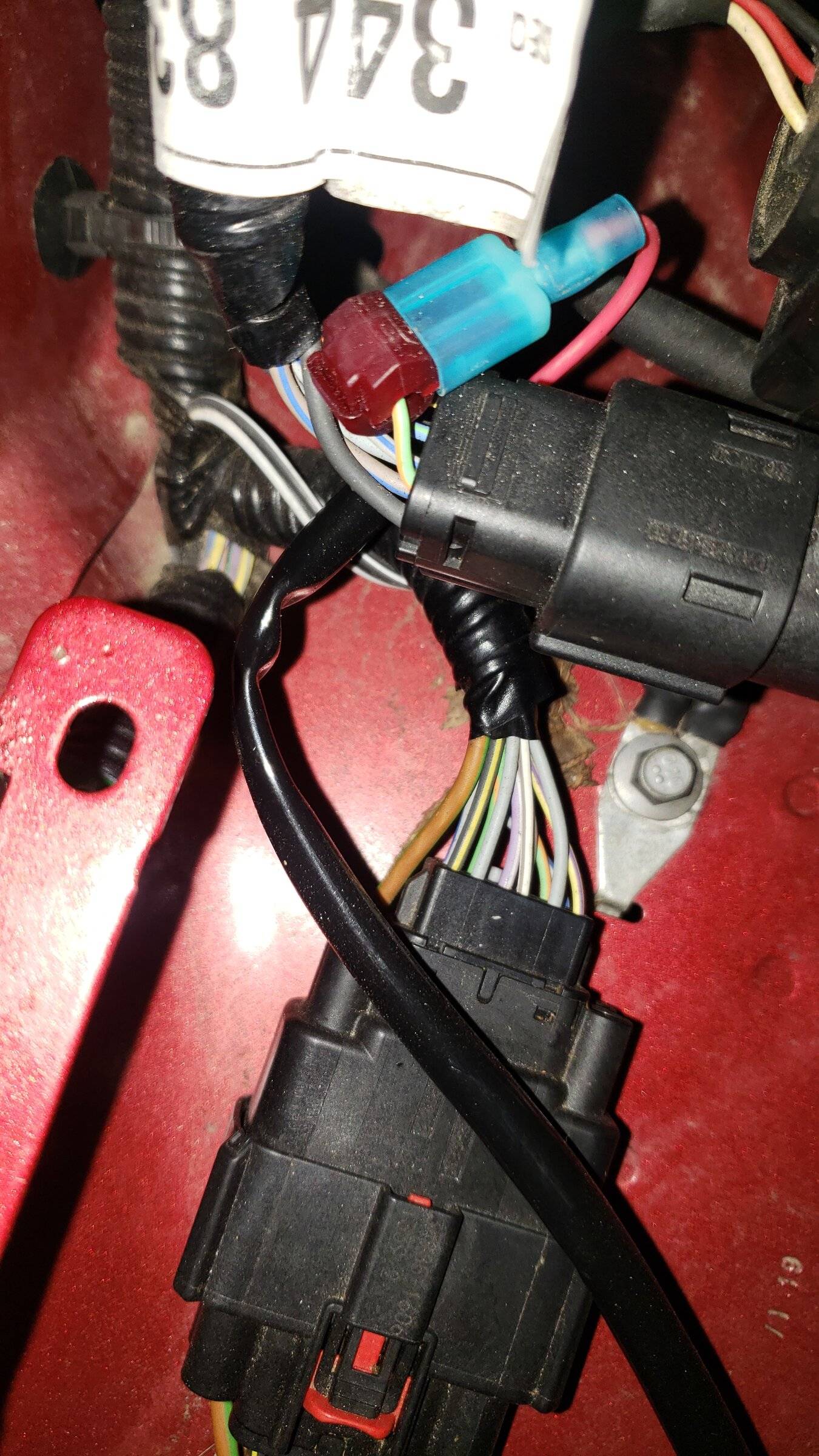

They are all in the wire loom behind the left headlight , right beside the battery on my Lariat . I tapped the park lights there.

Those quick tap type connectors in the picture above, they are considered to be a poor way to tap into a circuit, I would suggest a proper crimp connection with sealing heat shrink.
The amount of times electrical problems are traced back to one of those would surprise you, at least it's under the hood, somewhat protected, but it is the headlight circuit, don't want a problem with that one.
Just look at the pic, nice sealed connectors, to prevent problems, last a long time, and then there is the tap......
Just my 2 cents, feel free to disagree.

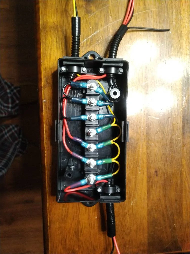

Yea I stay away from those splice taps. It takes almost no time to make a proper 2 to 1 connection with self soldering heat shrink butt splices.
I love these things:
If it is a harness that requires multiple inputs I invest in a junction box like this:
