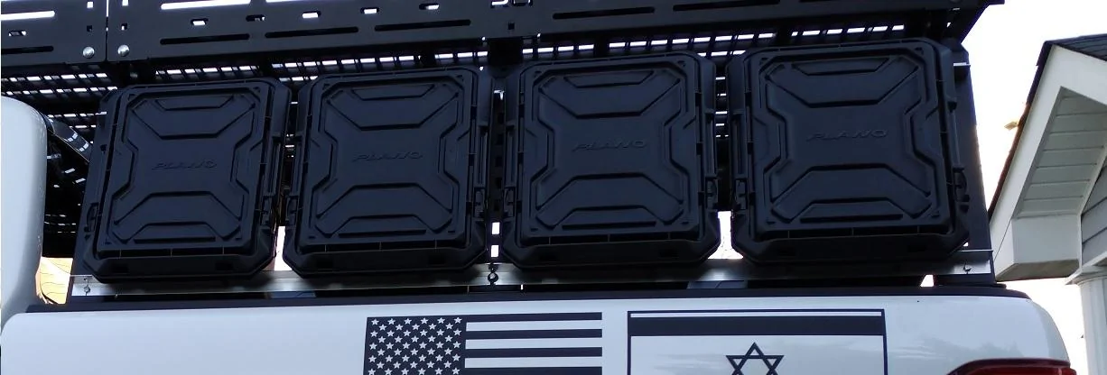

I have camlocks ready to install (8 all keyed the same), but in my usual messed up brain I am thinking there has to be a more genious way to do this.
So something like this; https://www.amazon.com/Homello-Elec...ds=electronic+cam+lock&qid=1617932610&sr=8-55
Problem is getting 8 all keyed for the same card. On top of that I would really like an option to hit a switch on the inside of the truck to disengage all the locks (or I could get crazy and have 8 switches to operate all locks separately.

Will run about $130 for 8 of them. Will probably order 1 and test it (to see if the strength rating is accurate), if its a go I can get 7 more. Simple 2 wire system. 130lbs of locking force is more than enough for pods that are just thick poly anyhow.
Those use power to remain locked, unlock when no power. I’m guessing the normal state will be locked. Probably not something you want to use if you care about your battery.
Consider a universal door lock actuator. This can be installed to throw a simple rod to move a bolt closed. Think of how a safe works. These actuators are 2-wire reversing polarity. +/- moves the actuator one direction, -/+ moves the actuator the opposite direction. Often, this can be connected to the factory actuator.
https://www.amazon.com/InstallGear-Universal-Power-Actuators-12-Volt/dp/B00CZBQCR2
Good point, may be a good excuse to go ahead and start piecing together my secondary battery bank and solar array.
Space inside my pods is at a premium, I had considered actuators, but they are too bulky.
The good news is even big door electromagnetic locks are very low power. I am curious what these smaller ones draw. Reading around on the internet they are likened to night lights you use in your kids room.
