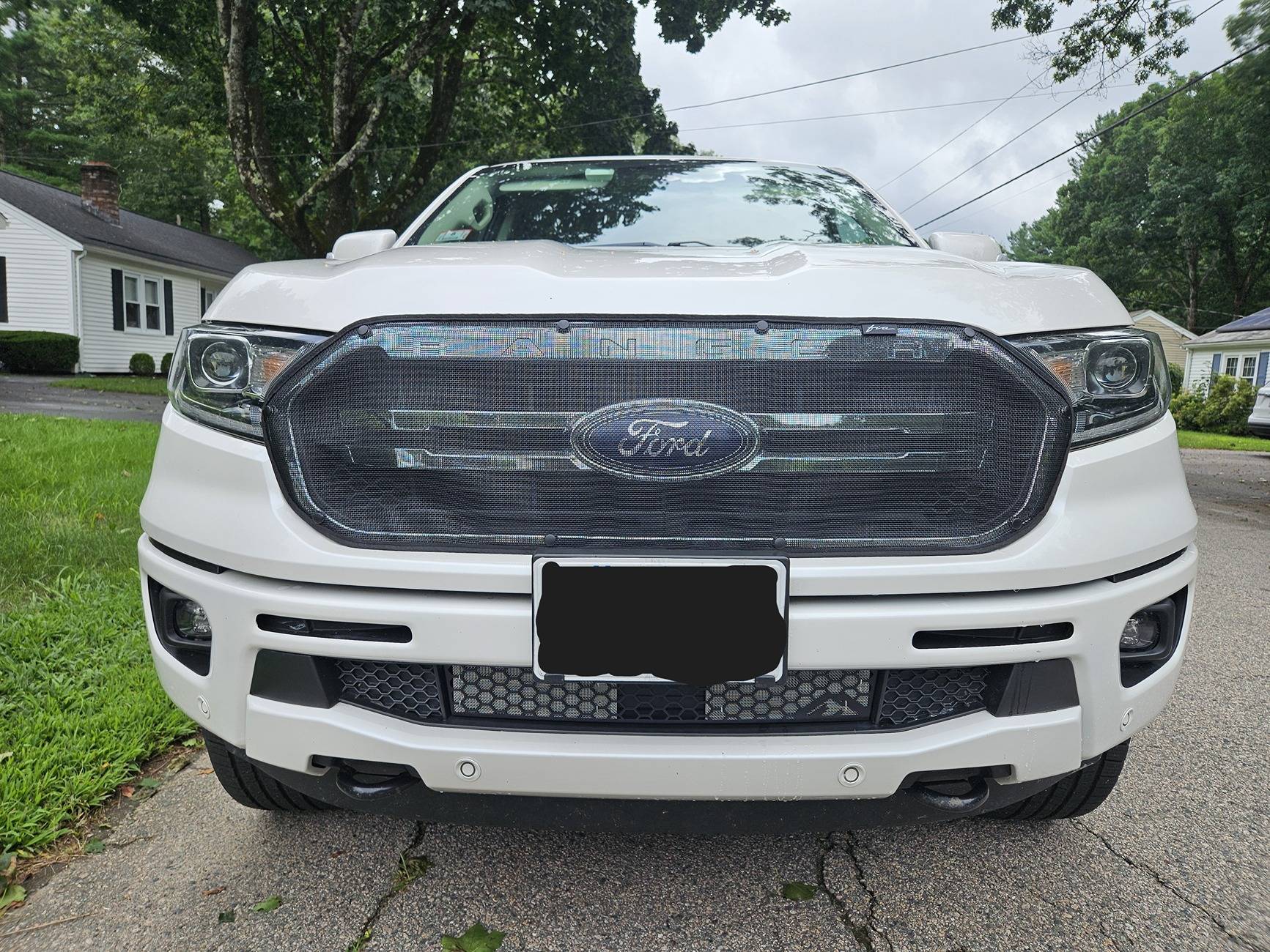

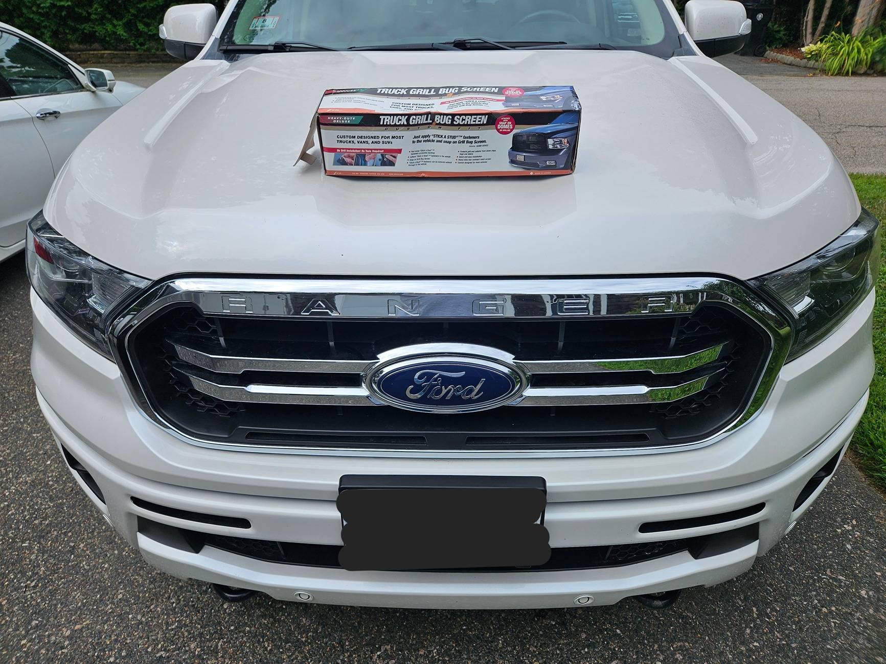

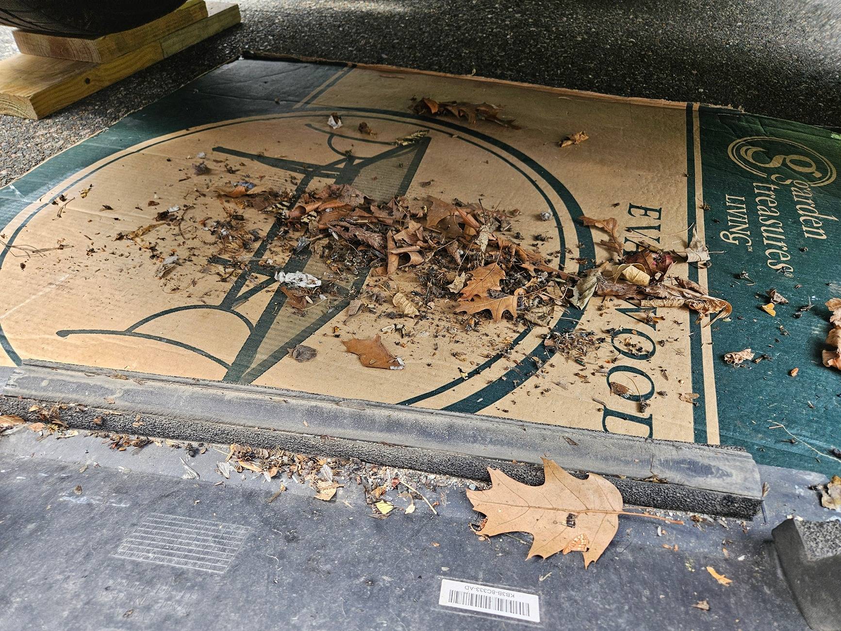

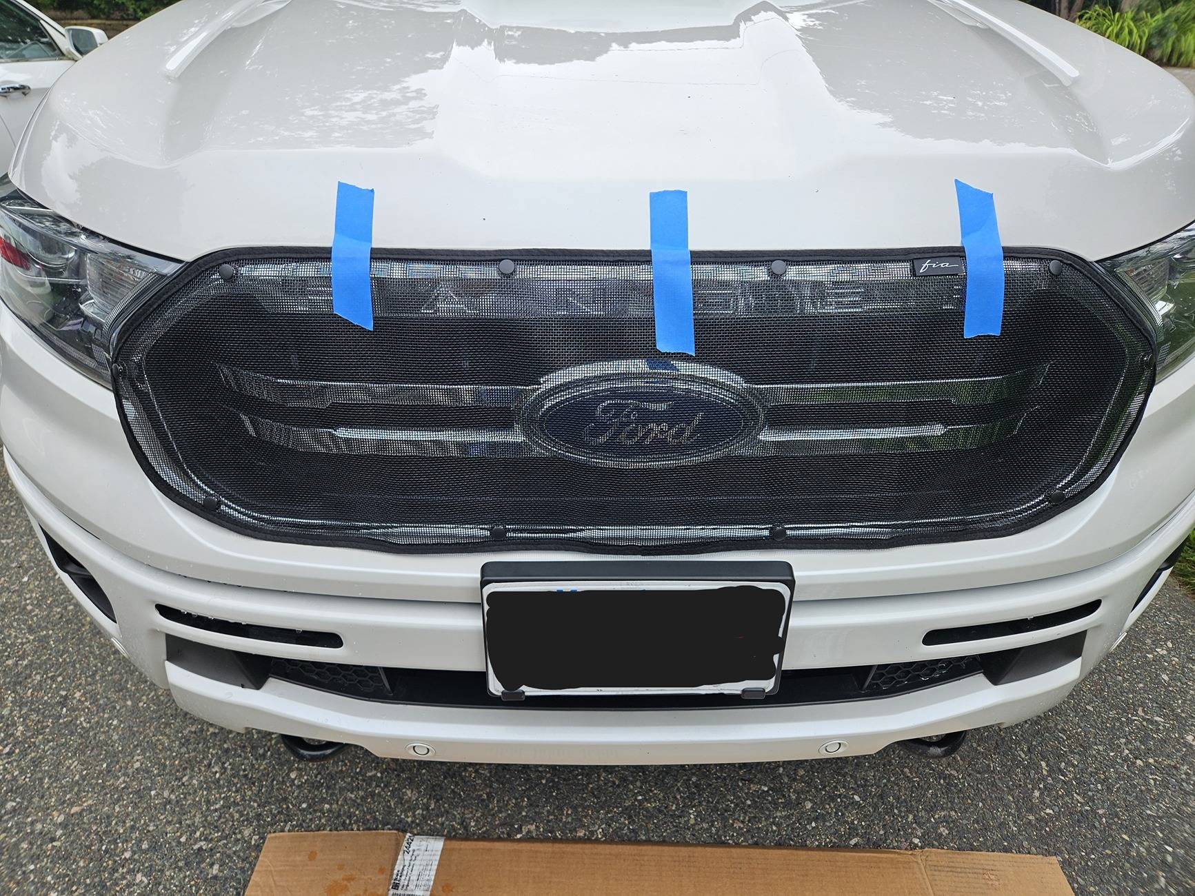

I installed the FIA bug screen and the M2M Grille Insert (I returned the Putco; it seemed like a lot more effort to install than it needed to be). I attached 13-mesh stainless steel screen (about same opening size as the FIA) to the back of the M2M insert, except where the ACC sensor is. The only place not protected now is the horizontal slot in the painted part of the OEM grille. Here are pics of the install, and of all the junk that was in there affecting cooling.
