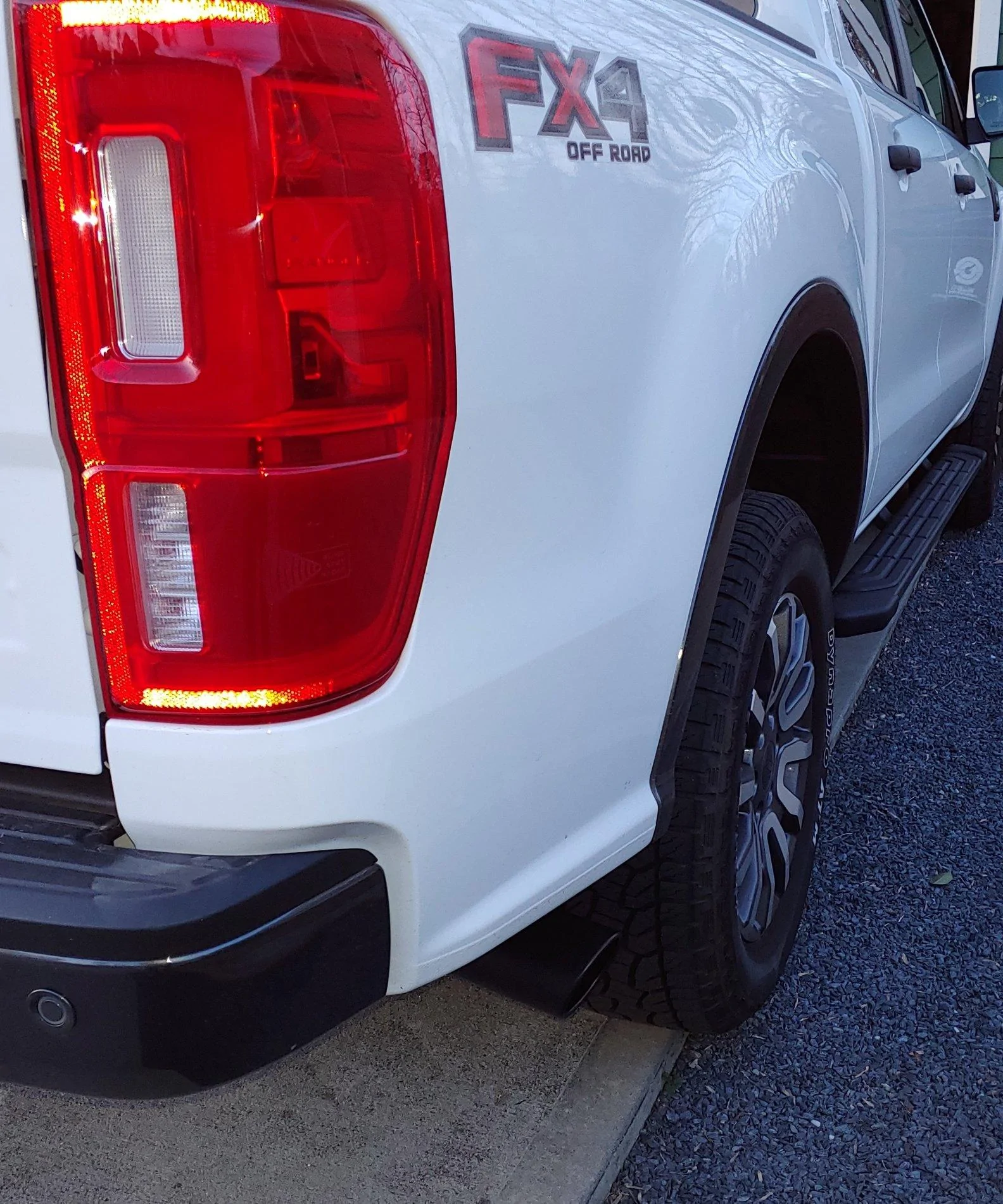

Mine sticks out about a 1/2 inch past the bottom of the fender if you look at it from behind. That's with the tip as far on as it will go without the tailpipe going past the rolled edge of the tip.
I thought it looked like crap with the galvanized pipe unpainted so I took the tip off, painted the pipe all the way to the muffler with heat resistant black paint and then put it back on. The tailpipe doesn't get very hot anyway so I just used Krylon High Heat from Lowe's; about $4 a can. I used some cardboard to mask the lower part of the fender and the end of the muffler. It still looks fine after 3 months and 5000 miles.

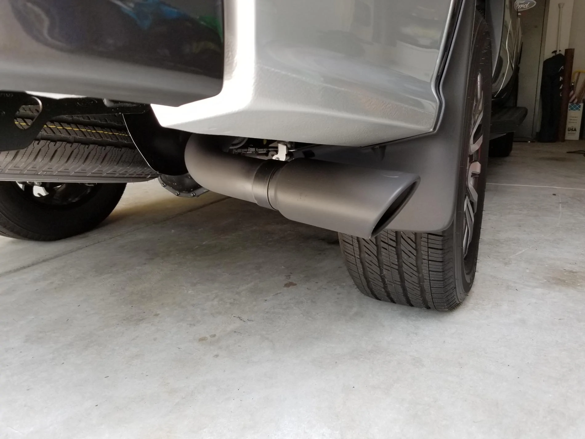

Not quite a pic from the complete rear but one I had on hand.
Thanks.. looks good.
I'm on the fence as to the black vs shiny vs a matte stainless:question:
I emailed them... I'm hoping I can get them in raw stainless, no chrome, no powder coat and then sand them down to a matte finish. I think that would look pretty good with the silver painted aluminum wheels on my truck.

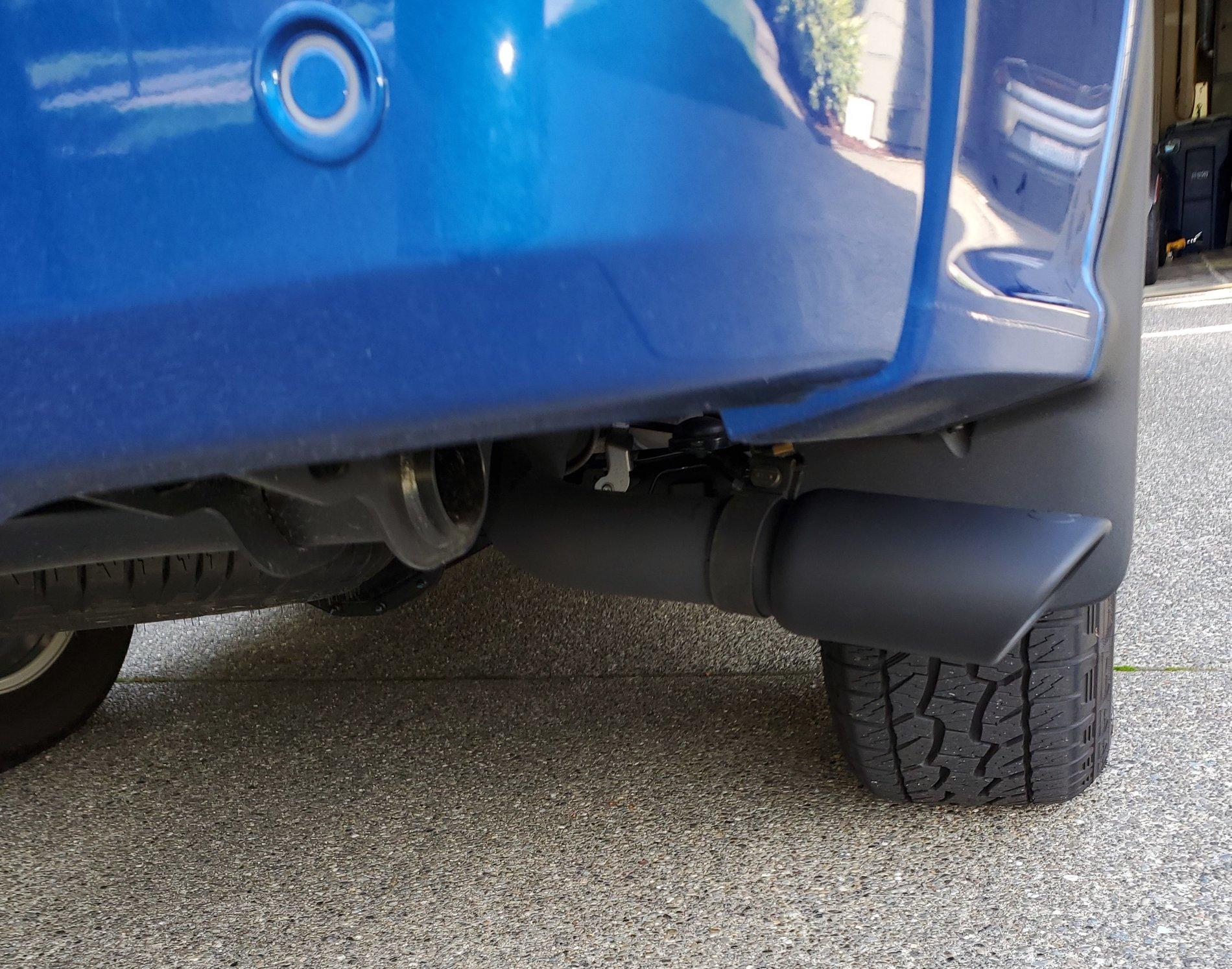

Ah much better now! Like others, I used Rustoleum's hi temp grill paint. Masked the area, sprayed and then did a quick cure/dry with my heat gun set to 400* on low. Clamped on the tip and whalla. Took about 25 mins start to finish. Great outcome.....thanks for the "tip" :) guys!

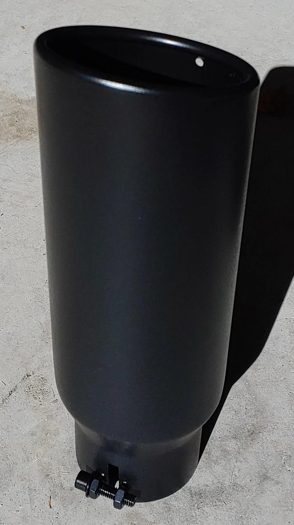

OK here are pics of my OsoTorero black exhaust tip. Nice construction and finish. Only thing that worries me is the nuts welded on to attach. I had to really torque this down to get it to close up on my exhaust. I might need to just go buy an exhaust clamp as insurance.
I really like the extra length, but still need to paint back to the muffler.
