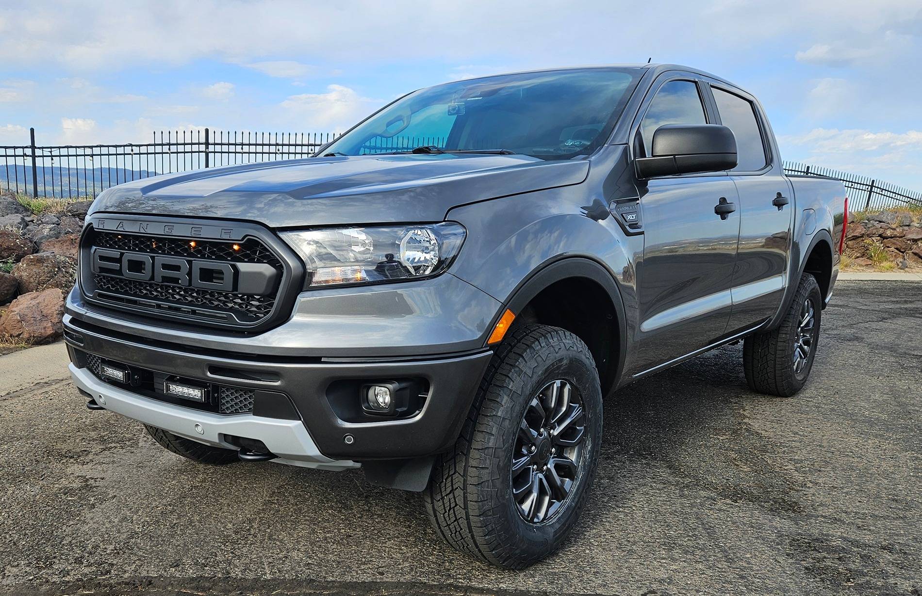

Similar usage for me. Continental Terrain Contact AT. Never heard of the category but they are on road all terrains. They ride nice, very quiet and highly rated. I did lift the front 3/4".
Do you have a link to your Raptor grill? Thanks
