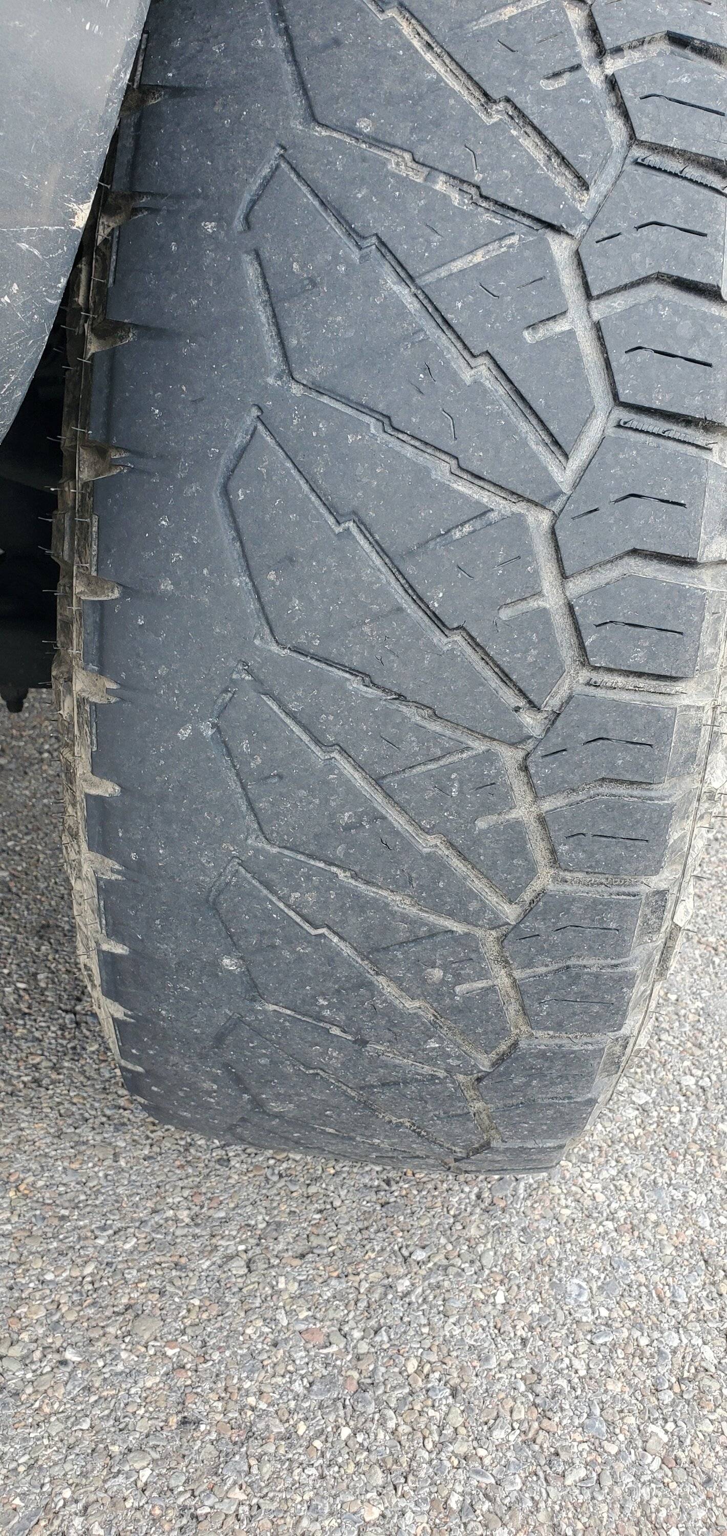

not sure if its the truck or the Ridge Grappler tires but I got 18k out of a set of 285/70/17 the front tires are much worse but I had it aligned at 14k and it was in spec ....
I believe next set I will go with what everyone else says, thats why we are part of these support groups of guys that have been there done that, the Wildpeak seem to be the go to tire? ....
So after my front lift, my insides of my front tires were wearing fast. It was toed-in.
Ask them align the toe almost dead neutral in the front. Spec might still have 1* toe in for straight line stability.

OP, I know you you ran them low, but still looks like you could have gone even lower. Judging by the wear being mostly in the center.
That is shockingly bad wear... i can see why Nitto doesn't offer a warranty on their tires, but its crazy how popular they are nonetheless... I've been running my duratracs for almost two years now, even snagged them slightly used. I've put at least 20k on them, and they still look brand freaking new.
