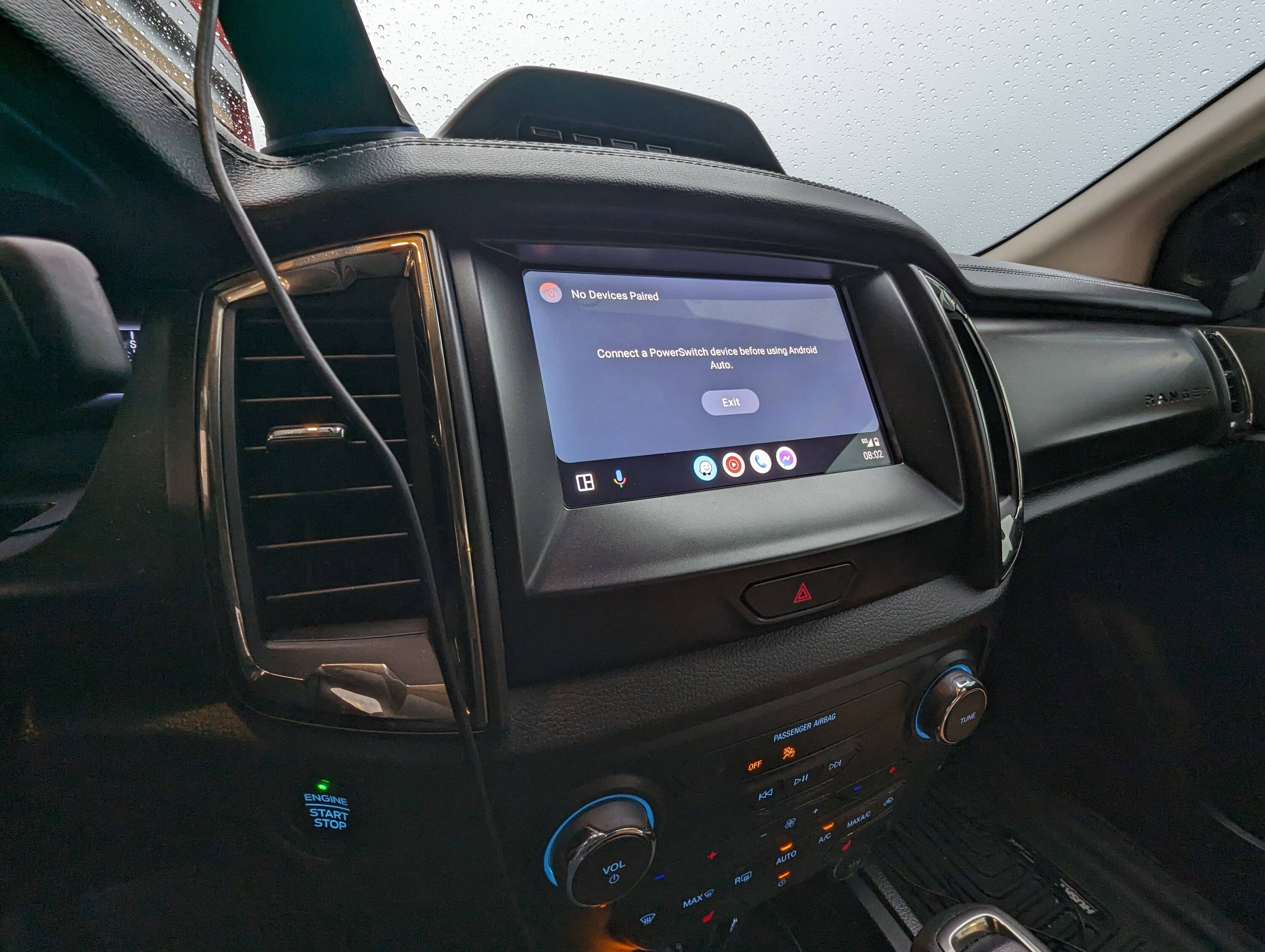

I assume you'll need to load an APP on SYNC3 for it to work? Sounds neat, but Ford limits what APPs will run on the infotainment screen. Maybe SYNC4 will be more APP friendly.
I was thinking the same thing actually. So I downloaded the app. It shows up in my AA screen and I can select it as well. Unfortunately I don't have a unit to install.

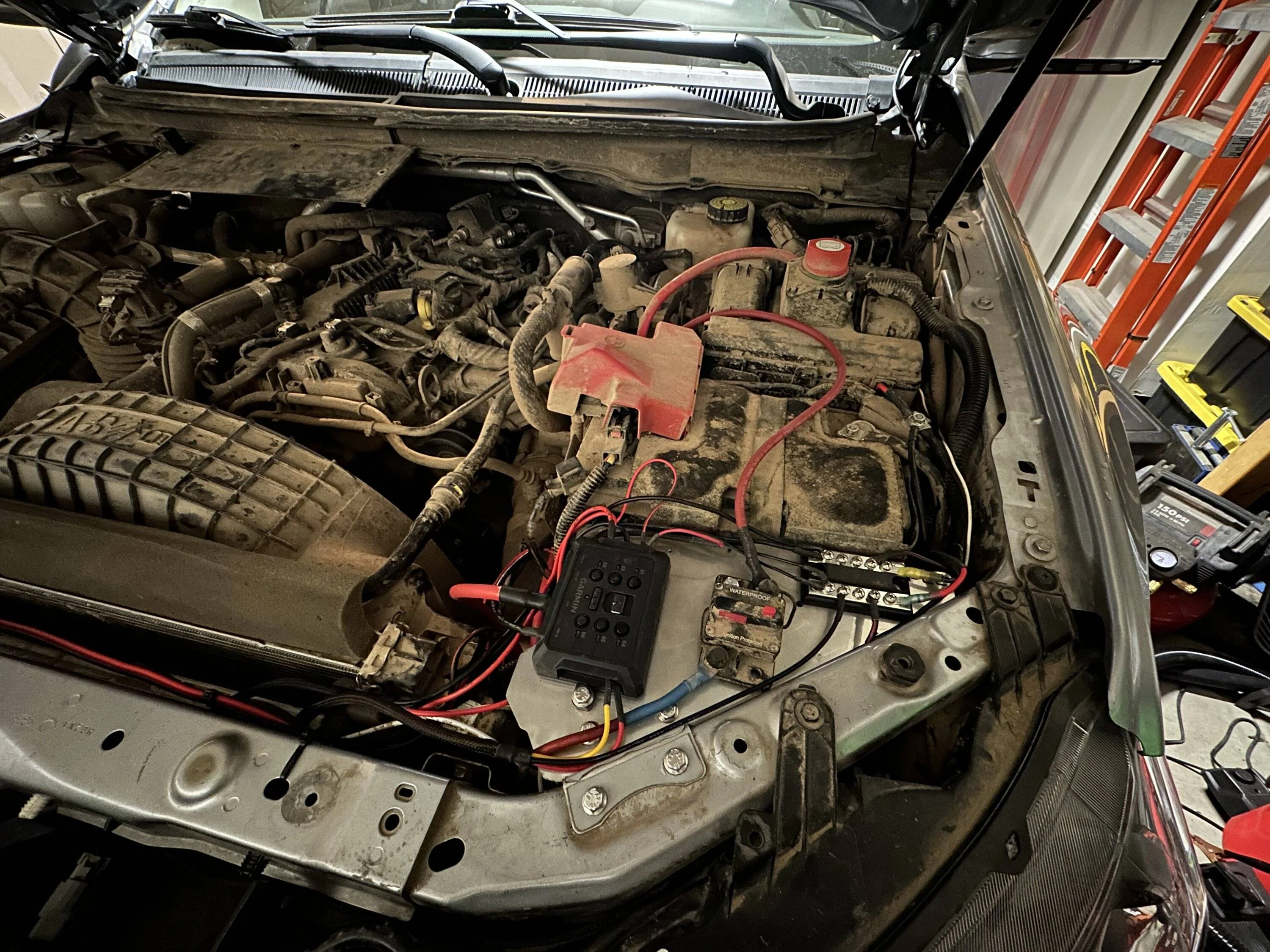

I installed the PowerSwitch ove the last couple of days. It’s awesome and worth each penny it cost. The app shows you total power draw when activated, so you know how much power each channel is taking. My arb single compressor is wired directly to the battery and the relay is connected to the PowerSwitch (the compressor takes too much amperage, so direct wire is necessary).

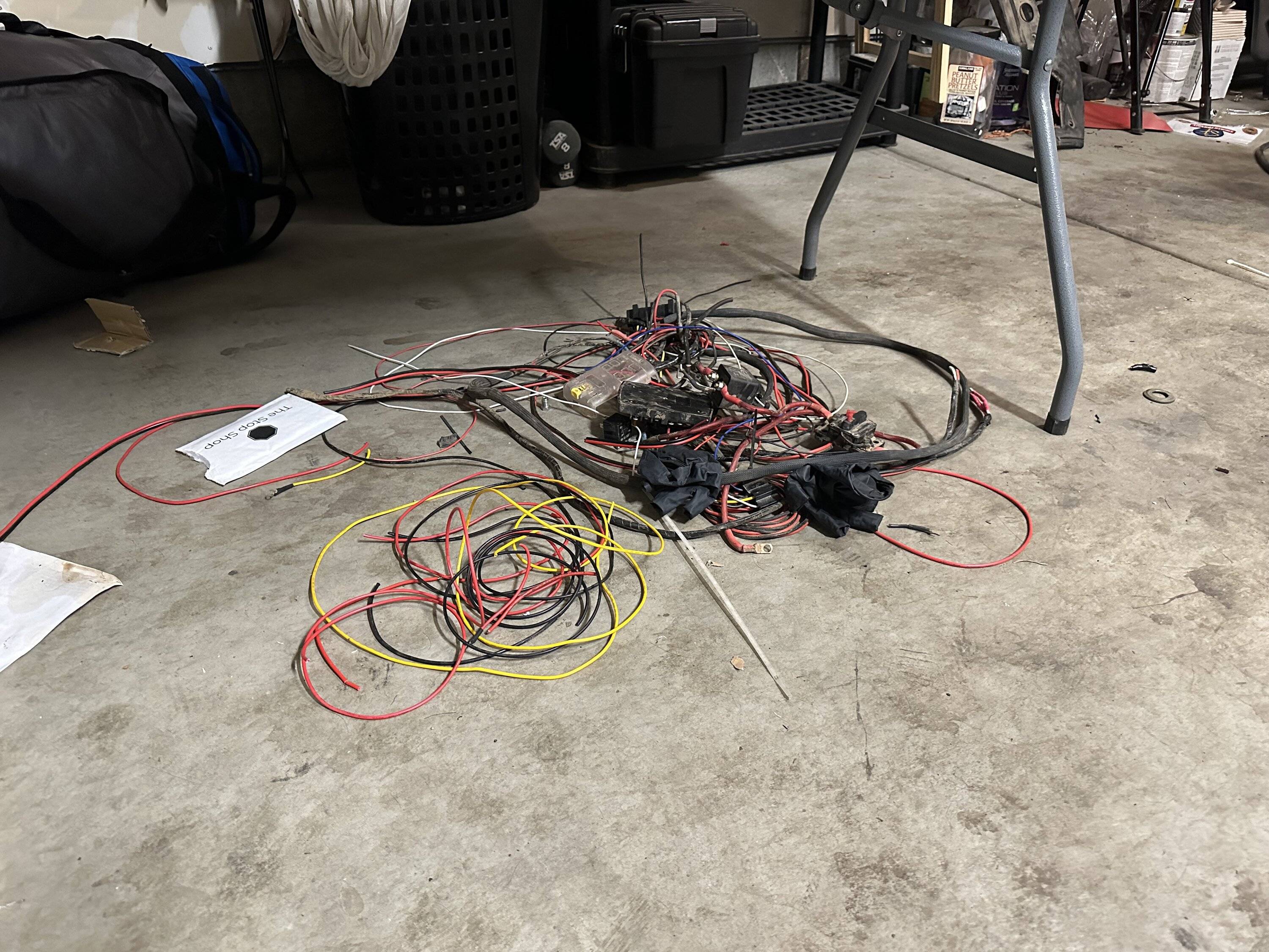

previously, I had each device on a relay and individual switch. Below is how much wire I was able to remove from the truck.
as for why this is even more worth it, you can setup conditional triggers. IE; I can tap into the brights and make it automatically turn on all front facing lights when the brights turn on. I use the auto brights feature, so this would be handy. Also, I can make a custom button that controls more than 1 thing at a time. One button to turn on my light bar, 7” rounds, and ditch lights.
the app is intuitive and the CarPlay integration is clutch.
