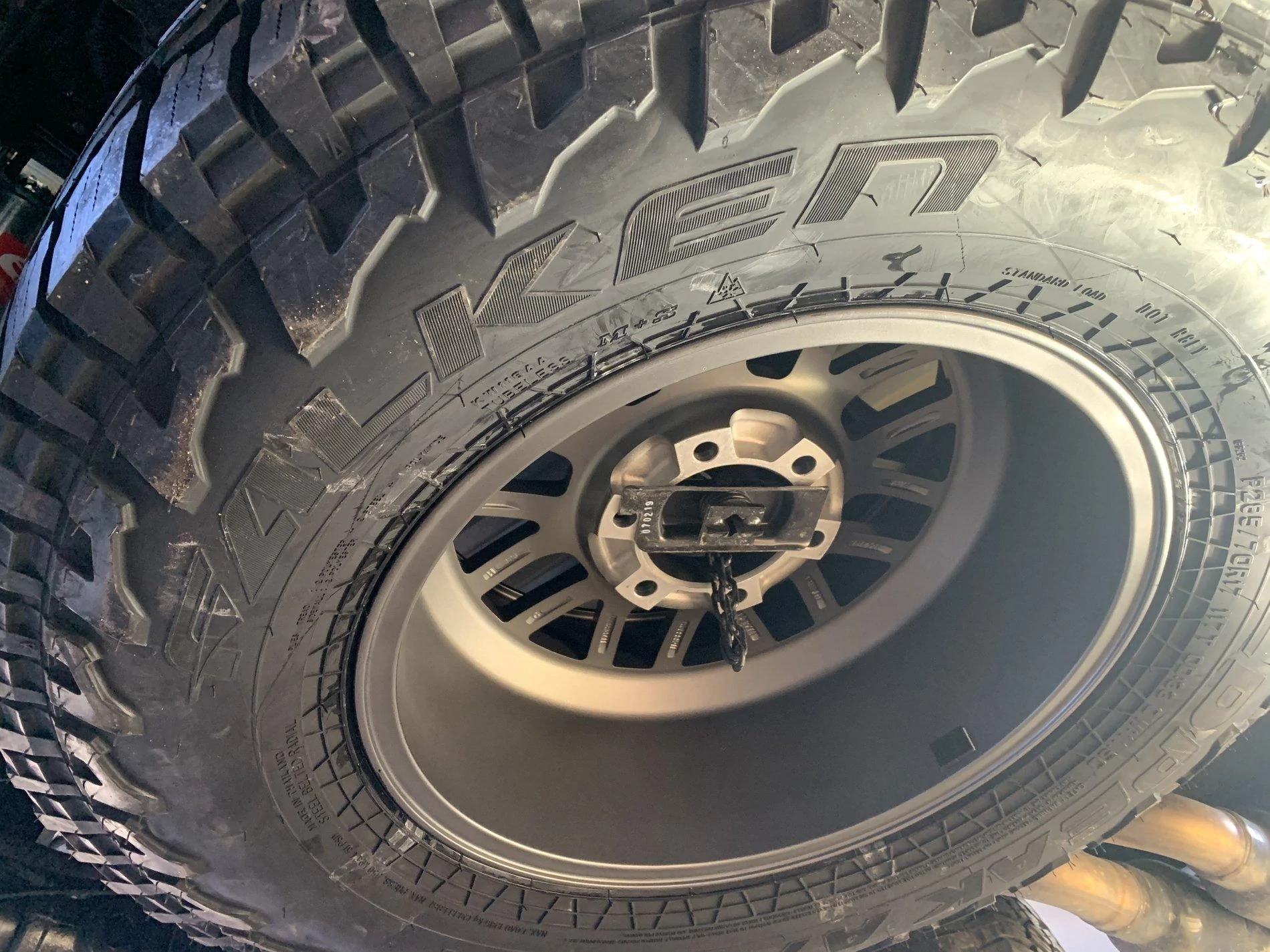

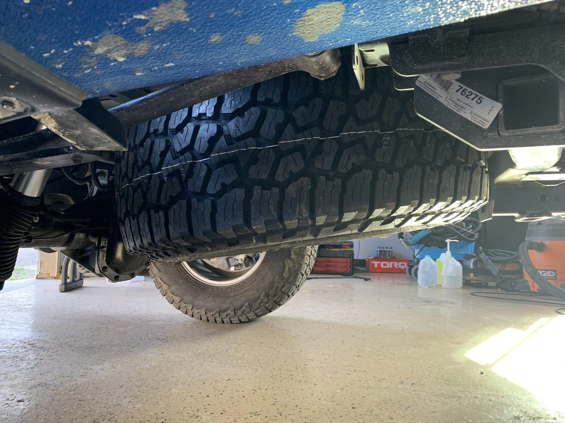

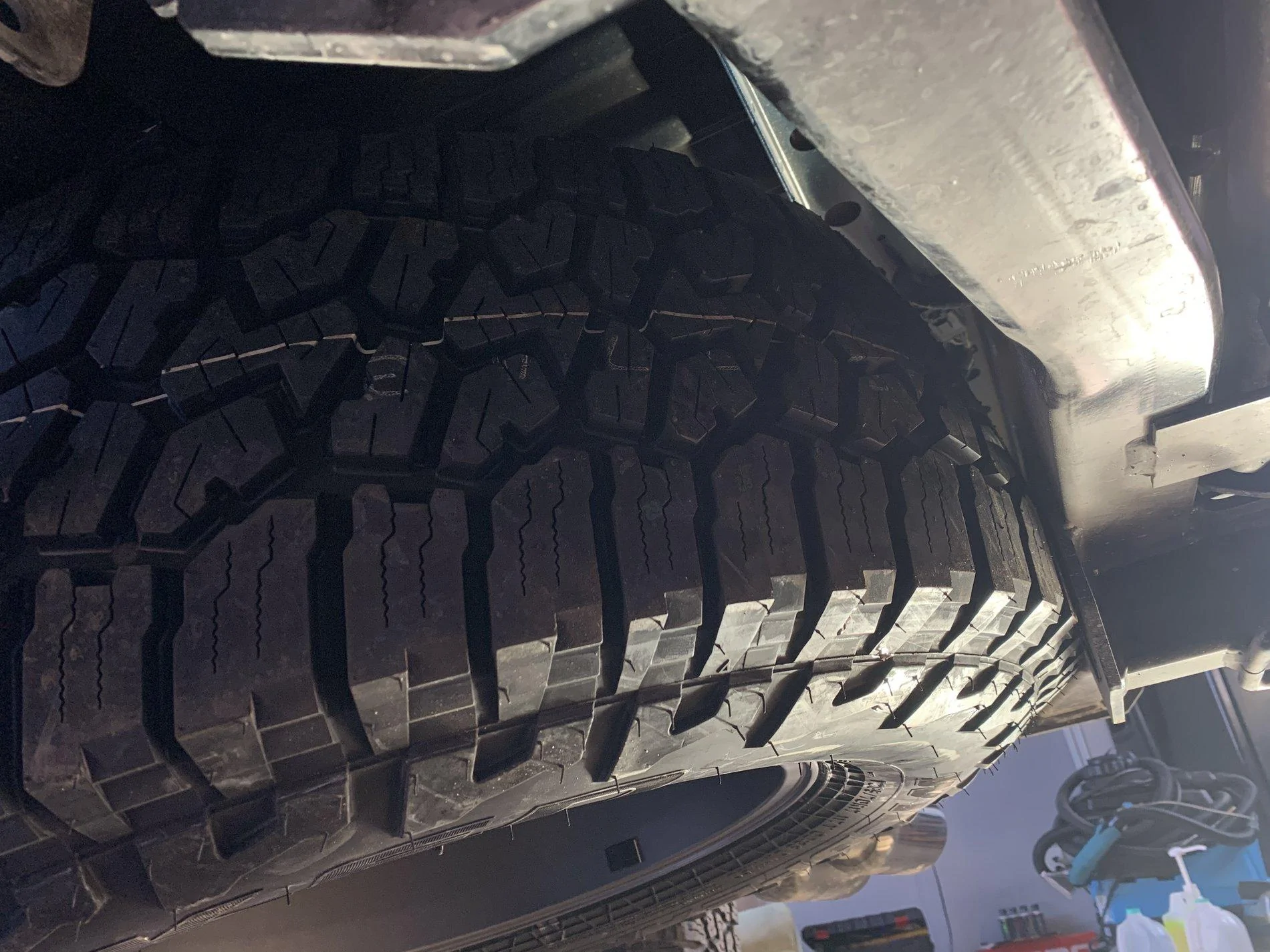

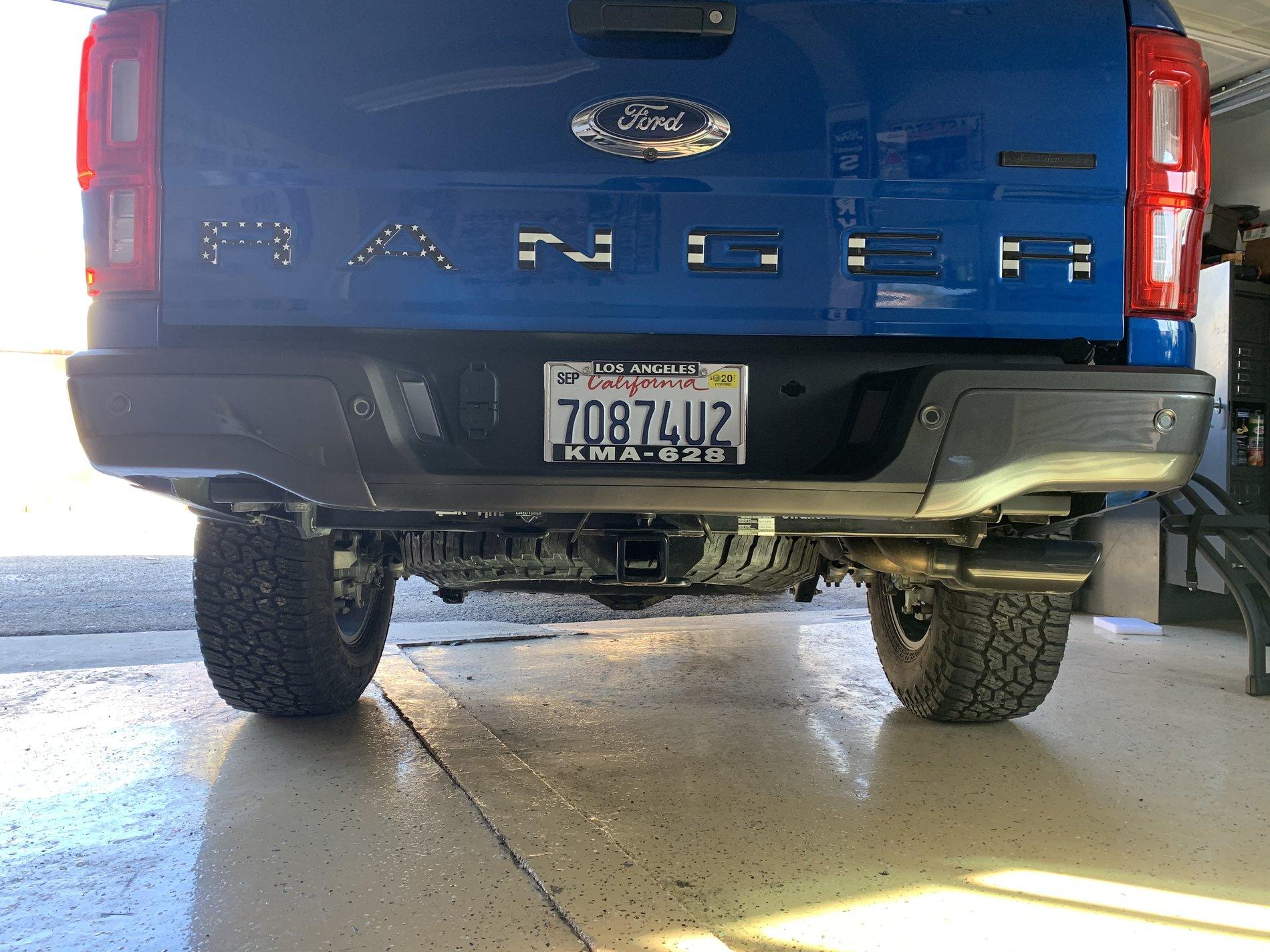

Today was able to mount my Icon Alpha wheel with a zero offset and a 285-70-17 tire under my truck in the spare tire location. Fits perfect and nice and snug! Mounted wheel face up so rod grime and rocks won’t mess up the face of the wheel

OHHhh I am digging that Ranger Flag letters accent.... super dope done on the flag... Oh yah the spare tire looks great too.

Snug indeed :clap:

Threw my full size spare on today as well - BFG KO2 285 70 R17. I have the Curt Class 3 Trailer Hitch - just in case anyone with that was wondering if it impacted mounting, it doesn't. Real snug fit but it got in there just fine.
