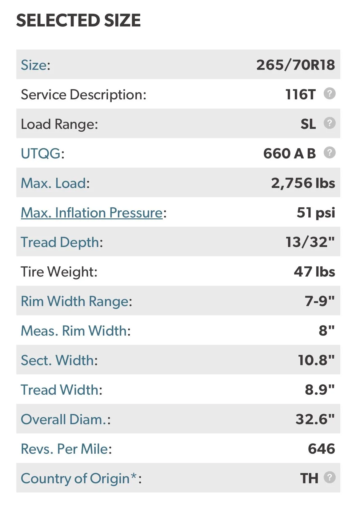

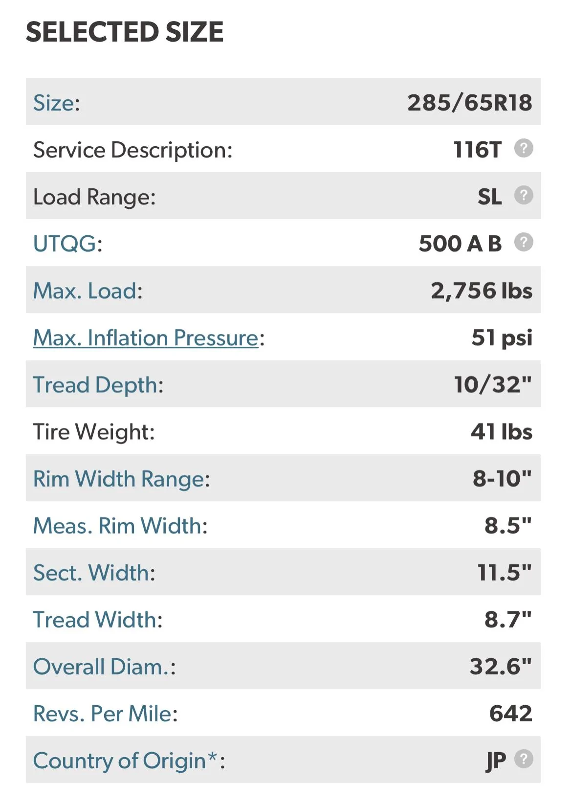

Making me think I should have went with 285/65R18 for the Wildpeaks.
I take that back. Looks like the 265/70 actually have wider tread on the ground and significantly less expensive at $263 ea vs $393. Sheesh.
