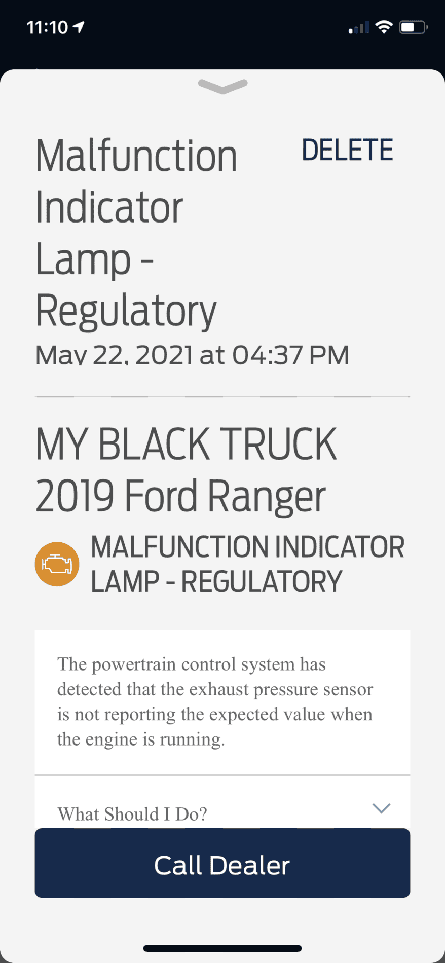

Just sharing some info, had an intermittent P0471 check engine light come on. The tech replaced the "Exhaust Pressure Sensor." Truck is approaching 50k miles.
I use a Scan Gauge ii daily which is what I used to clear it. Sometimes it would come back in a few mins and sometimes a few days. No perceived power loss and still drove normally. Was covered under an emissions warranty so didn't even need to use my extended warranty. It has been a week now and no more CEL so I presume the correct component was replaced.

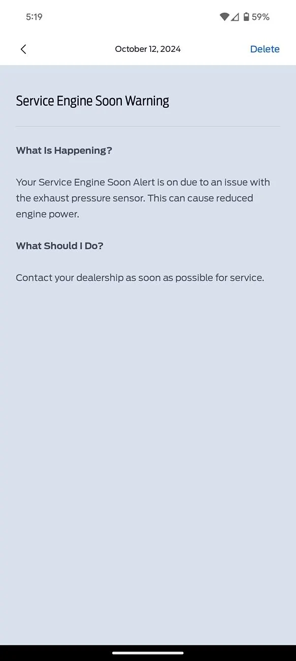

I've searched and haven't seen any threads about a Service Engine Soon Warning (check engine light) with the app message: Exhaust Pressure Sensor.
This was an intermittent problem in September and October, and hasn't occurred since, but I've also been mostly driving my other vehicles since that time while waiting on new suspension bushings. Seems to occur after extended periods of easy cruising (ie towing at a constant speed), and resolves after engine is switched off and everything cools down.
Note that I have a Magnaflow cat back, K&N filter, and the FP tune, in addition to 285/75-17s.
Could this be related to the DPFE sensor? https://www.ranger5g.com/forum/thre...mbly-replacement-write-up-lb5z-9j433-b.29247/
Anything else to check?
