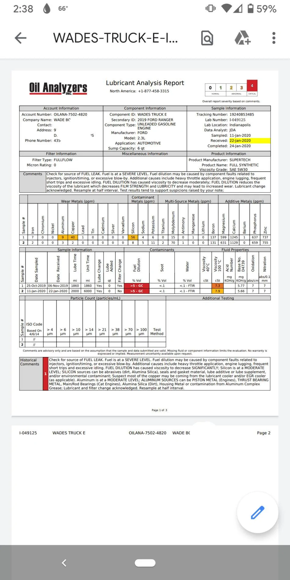

I have owned DI vehicles before, and never smelled fuel (strong raw fuel) in the oil. If it turns out to be nothing, then everyone can help others that have the same questions. If something is uncovered that is wrong, well it needs to get resolved.

When I change my oil, I fill it to about the top of hash marks, which I feel is good for when the truck is cold. Now, only about 150 miles later, it is already well above the top hole, checked while cold, sitting for over 24 hours. That is completely insane. If you look at the catch can threads, you'll find many are full of nothing but gas. That couldn't happen unless there is tons of gas in the crankcase that is evaporating and going through the pcv system. You are right that a small amount of blowby is normal with the high pressures of DI, but not to the extent we are seeing here. That's why I think it is important we get oil analyses done, since smell is so subjective. Still waiting on my second analysis results.True ....and as info, I checked the owners manual and it says the hash marks aren't the high oil mark....it's the hole. the online version of the owners manual will not pull up right now to verify.

Just got the results back from my second oil analysis. After less than 1700 miles (the 2000 miles reflected on the analysis was just an estimate I threw out there when filling out their form) the fuel dilution is once again well above 5%. That was 100% highway miles, from Colorado to Utah and down to Texas. The rate at which the fuel builds up in the oil is insane, imagine if I waited the recommended schedule for oil changes in this truck? I hope that others who suspect this issue get an oil analysis done. $28 is a small price to pay to protect your $30,000+ truck and know what is actually happening to it.
