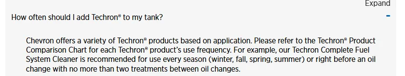

PEA tends to wash some crud down into the oil, so it is best to get it out with an oil change. Not absolutely essential, but it is a good idea. Some people have had UOA's come back with slightly increased wear and lead after a run of Techron and Chevron themselves say not to use it more than twice between oil changes...or at least used to. Looking for that info now.

Bookmarked to pertinent section:
