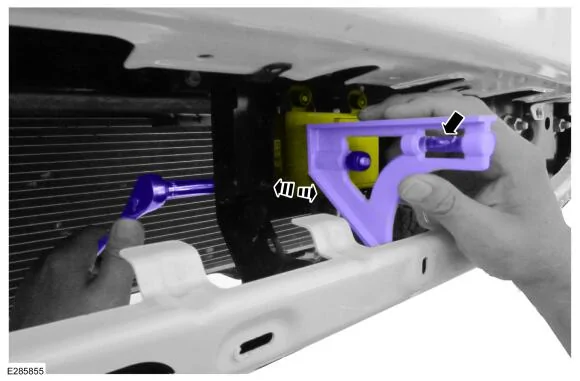

Note: The CCM has a cover installed that covers/protects the CCM, you have to remove the cover to get access to the actual CCM, cover has 2 pushpins, and the module is secured to the bracket with 3 Grommets Ensure the Bracket, Module and Cover are all secure and no debris between the module and cover.
Ref: This has to be completed with Truck on a LEVEL surface, the manual procedure utilizes an alignment rack
Then use Scanner - for the Horizontal (Alignment) calibration and then do a CCM Self-Test (Reset)

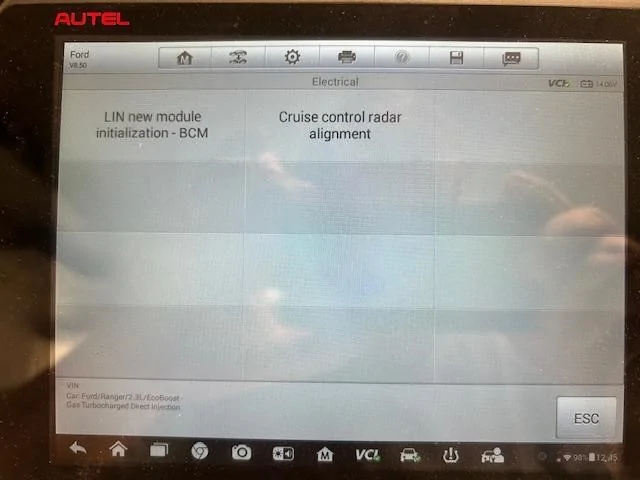

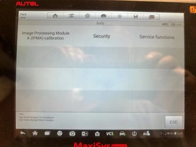

Not sure if Forscan has it (YET)
My Autel has it.

The 1st step (Alignment) is just a simple (Como-Square) Tool, adjust it to Level (Vertical)
The 2nd Step - Is a Software Recalibration (Horizontal) of the Adjustment Made in Step 1, this requires a High Level (Bi-Directional) Scan Tool or Forscan (If Forscan) has this as an available tab. (I do not think it does) but could be wrong.
As long as there are no added covers from stock, you should be able to just reach through the opening to access the cover for the CCM - pull the cover will reveal the actual CCM (Module)
