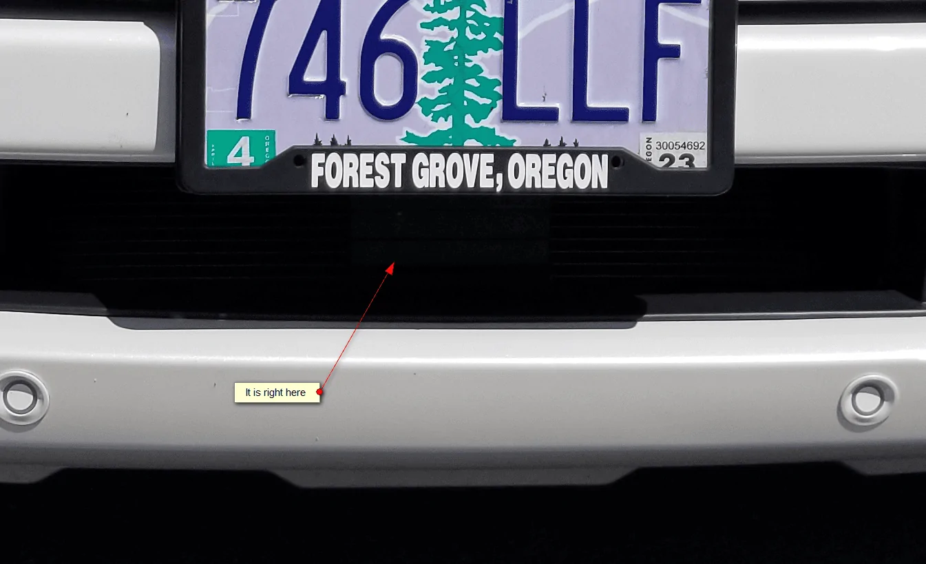

FYI, The panel is centered right under the front license plate (If you have a front plate). I was trying to find a photo of one on my truck, but it is always in the shadows. This was the best I could do. The other one is in the mirror assembly - probably just need to make sure your windshield is clean around it. My guess is that it is the sensor in the bumper.
