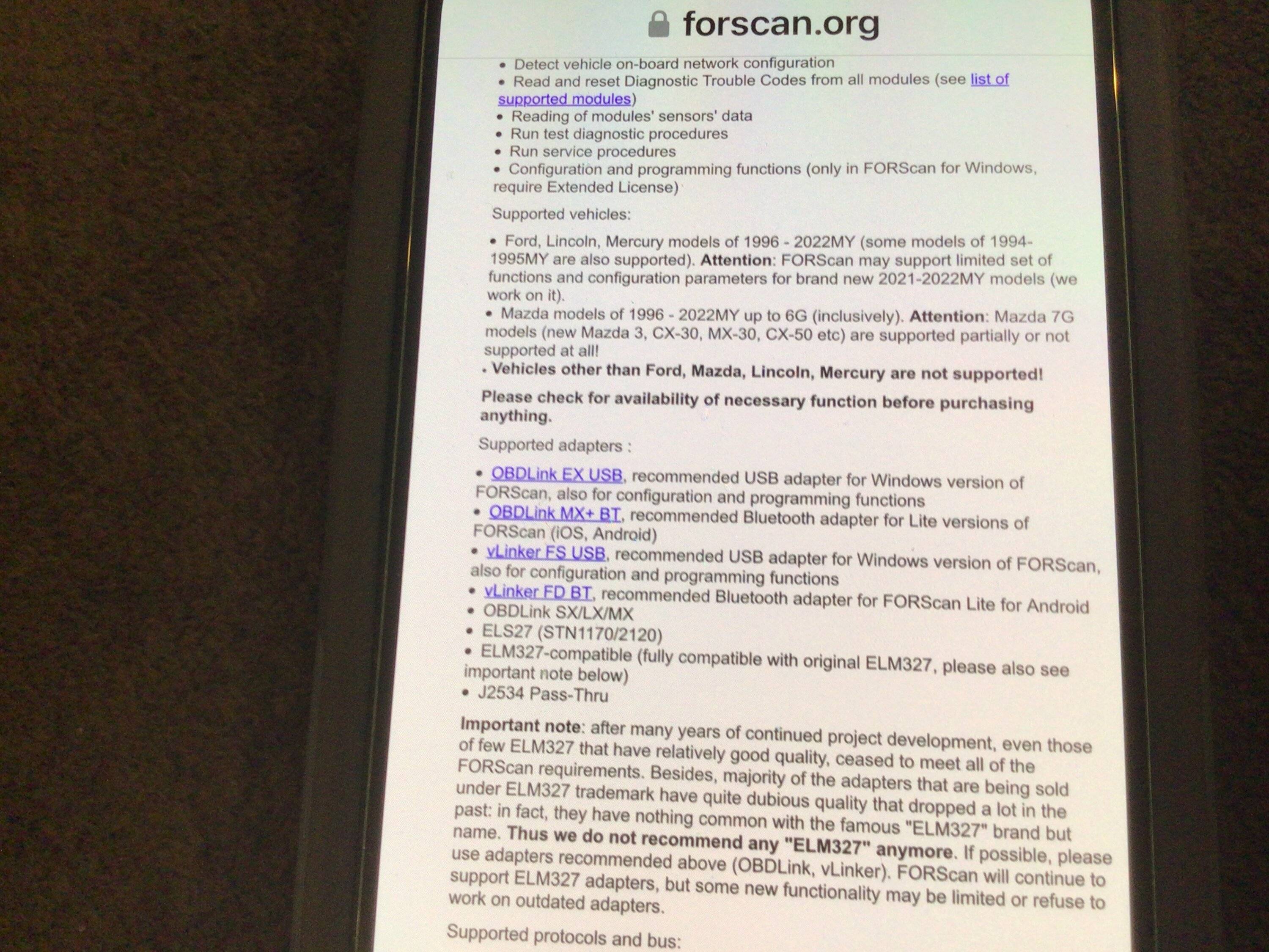

Once the battery is replaced, using FORScan, change the max battery charge to 95%. From the factory, its set at 75%.
After 6 hours at the dealer to finally replace the battery and download new files (supposed to take 2 hours!) the dealer said the A/S/S still didn’t work. They would contact Ford. Well, well, it worked fine for me on the way home. Now the FORScan route to change to 95%. Gotta reread the discussion on the 95%.
Question—is the “OBDLink EX USB“ the one to use?
