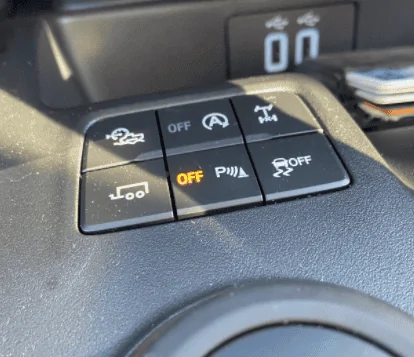

hit the button:
it will stop them from being annoying at that moment.
I actually feel pretty stupid ?. That literally has never crossed my mind. I forgot that it was even a feature. That’s a pro tip for sure
