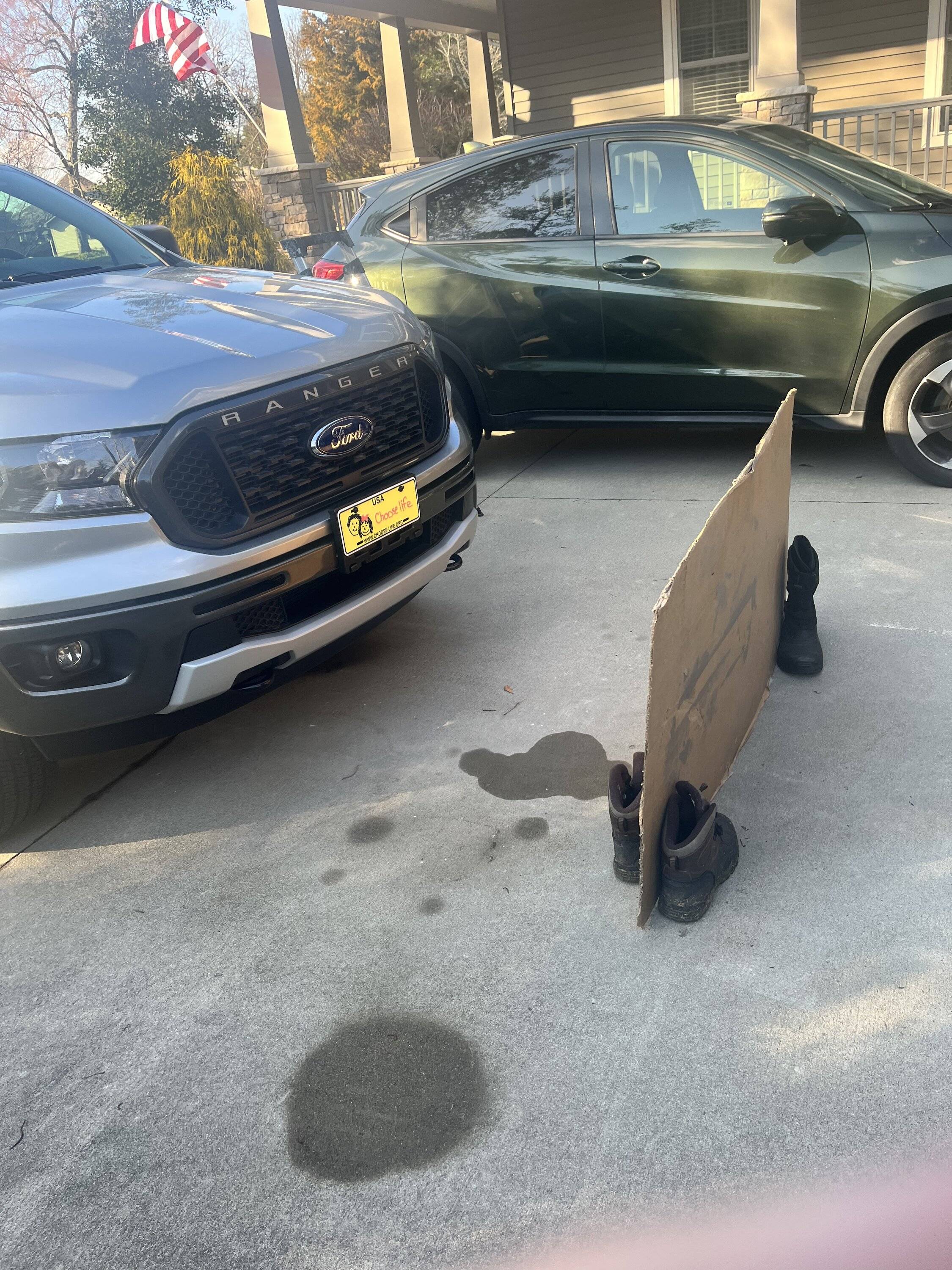

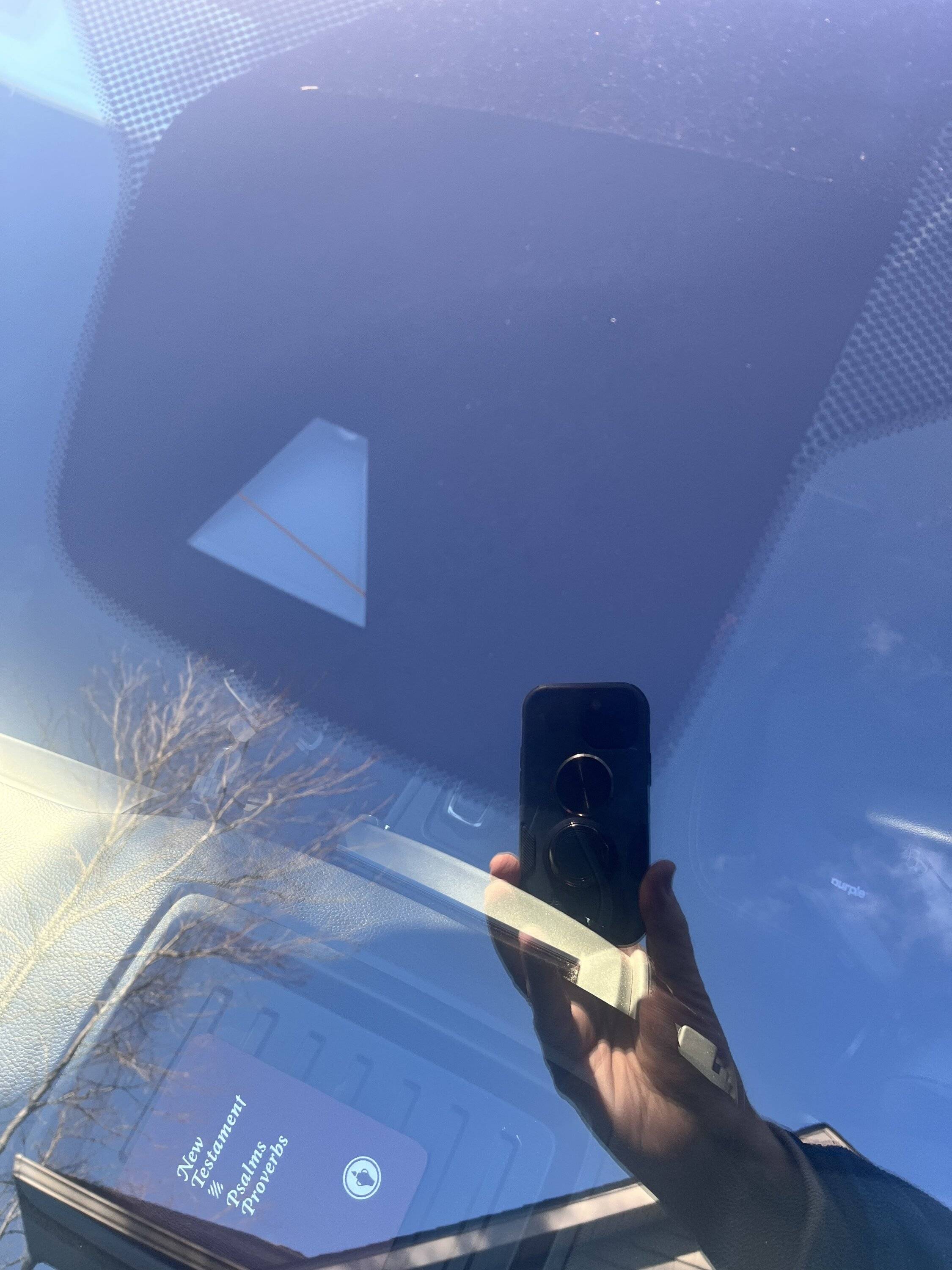

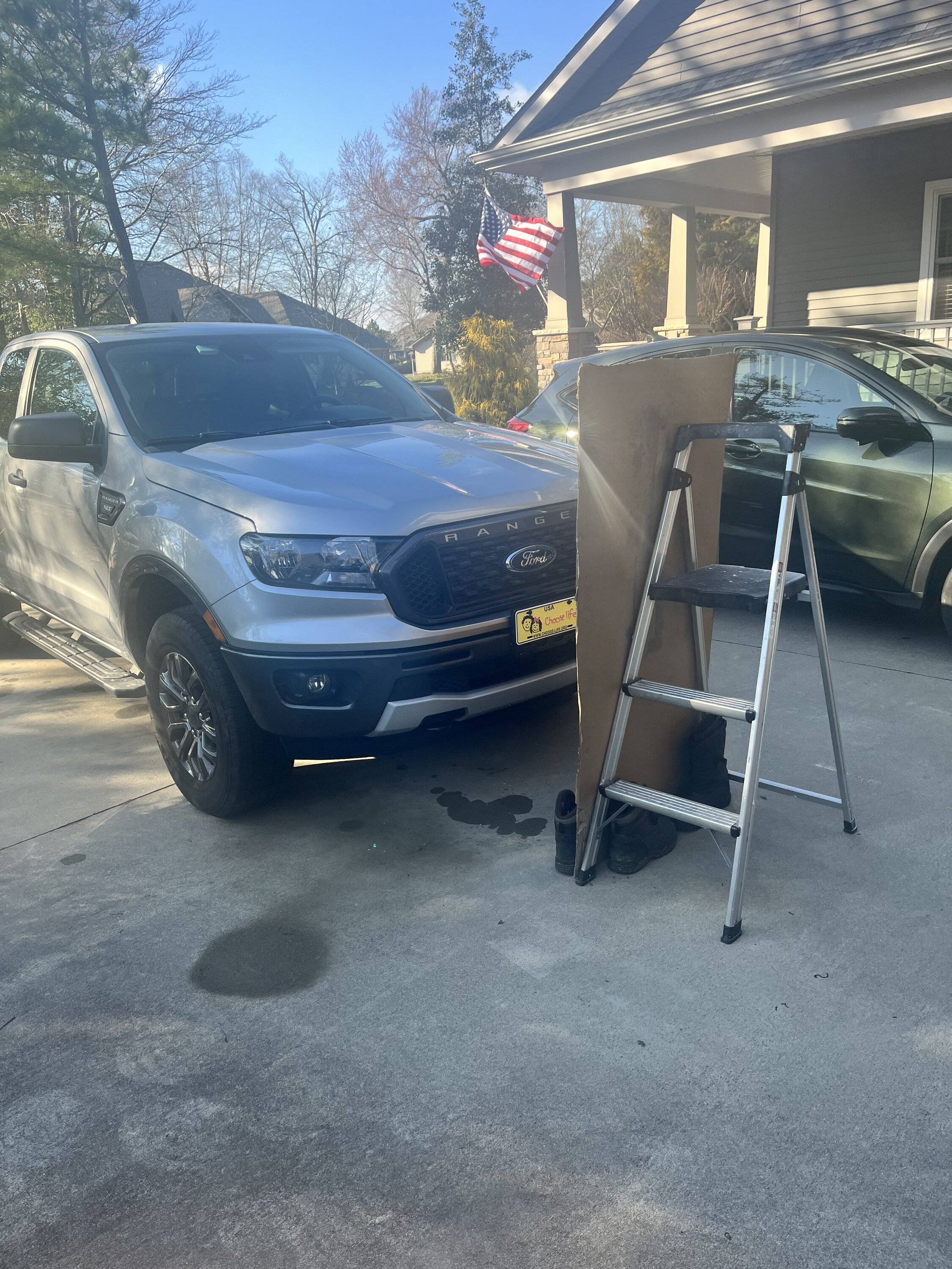

OK just tested with cardboard. Collision Sensitivity is set at High. Windshield is clean.
Ran tests with cardboard 28” x 58”. Tested in horizontal and vertical positions.
Car at 10 mph in driveway. Drove at speed within 2-3’ of cardboard 3 times each. NO Warning on Dash or Alarms. No Automatic Braking.

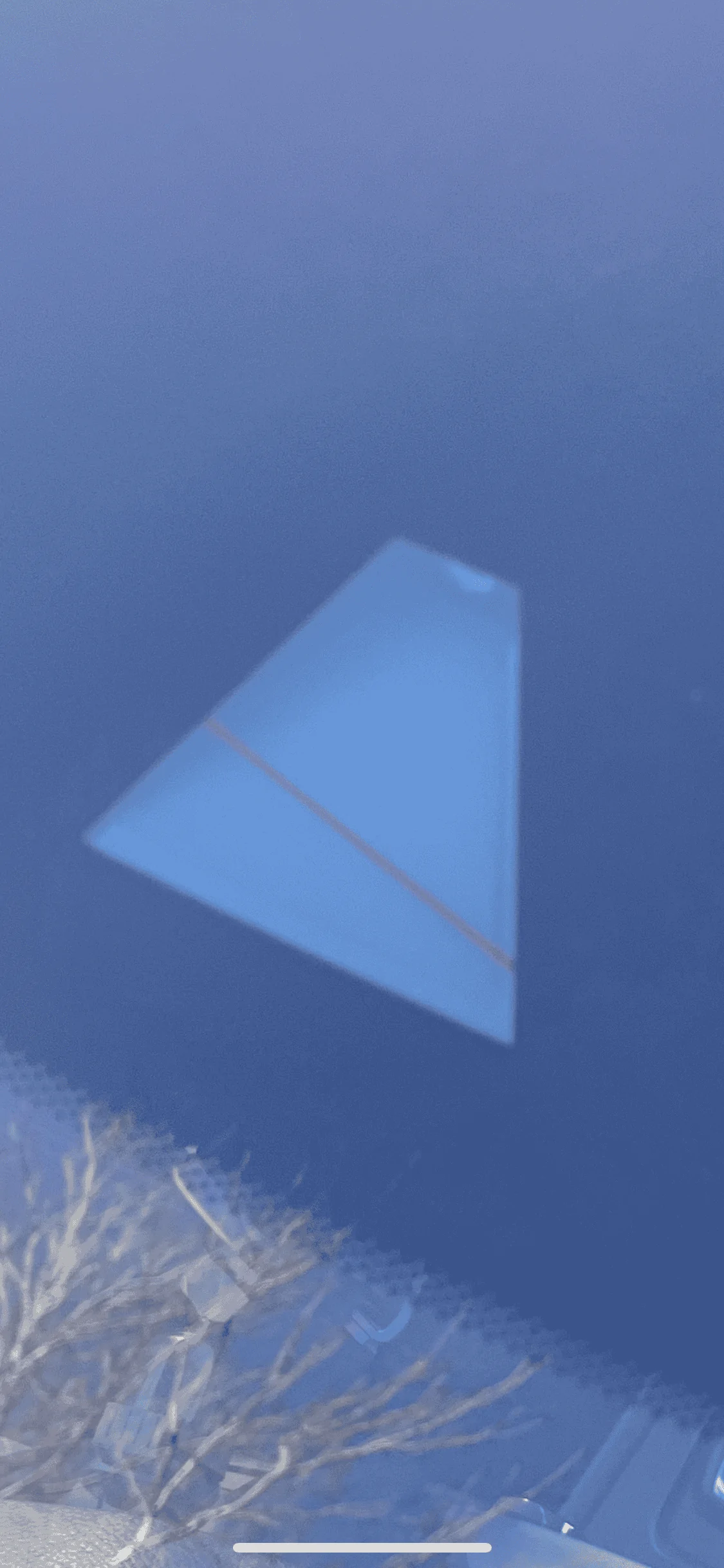

What is Orange Line across Camera?

You can do a real world test by suddenly speeding up to a vehicle in front of you.
Seems the systems calculates the speed and distance together.
Mine comes on occasionally as I try to over-take slow pokes that freak out over a drop of rain.

That orange line has something to do with calibration.

@Ranger Roger - I am a driver that is frequently in metropolitan rush hour traffic and I have a theory that this camera is looking for brake lights illuminating. My camera goes off (beep mode only,) pretty frequently in stop-and-go traffic, especially at night. I've often had the thought "I wonder if it's responding to all of these brake lights.." because people are not necessarily panic braking. Just being typical impatient bumper huggers during rush hour.
I have a theory that is why your test failed. The camera probably does not recognize flat walls as a danger scenario for braking assist. That is my understanding is it is not "automatic braking" it's a braking assist. It will apply more force than you are giving as an input with the pedal, but you must touch the pedal.
