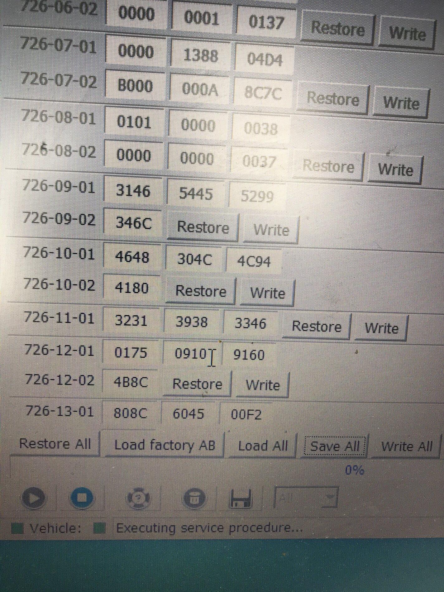

Guys, any advise on why I don’t have write button against 726-12-01 entry?
Latest Forscan with extended trial license.
Notice only the lower entry in each section has a write button? It writes both entry in the section.
It worked. Thank you. Will check differences later.
