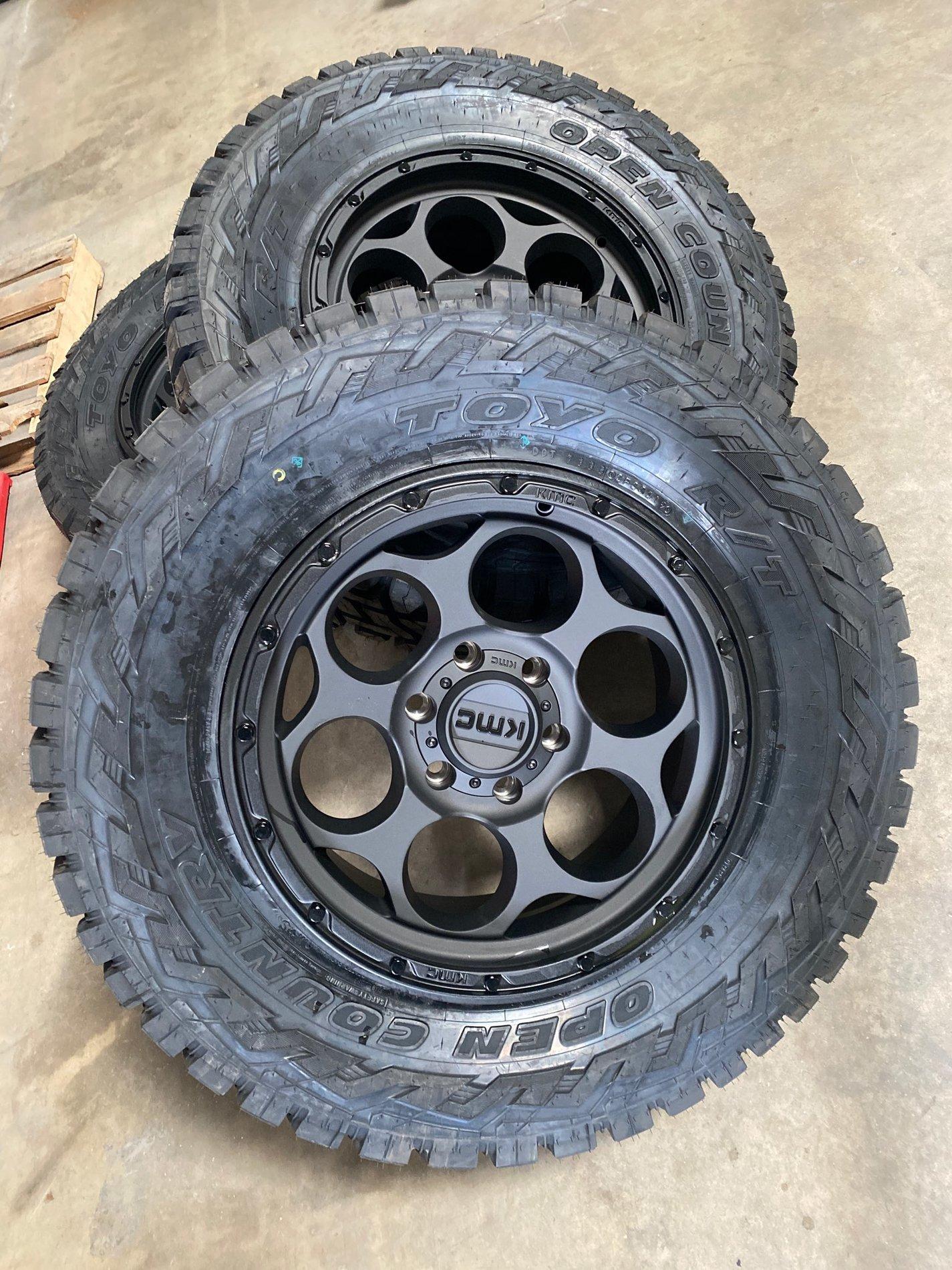

After lurking on this thread a while, I finally got a new set of wheels and tires. I went with a slightly larger size of 33x12.5x18 tire size and thought I'd share my results.
According to the data I found on my tire size, the circumference is listed as 2635mm. Adjusting to 2635mm in FORScan, my speedo was reading 4-5mph too fast. I ended up having to scale down to 2510mm which I thought was interesting considering how far off it was.
After dialing in the speedo, I also got the PCM U0422:00-2F. I also have a couple of edits to my truck aside from this.
Crewcab FX4 Lariat
Tires: Toyo Open Country R/T (33x12.5x18)
Wheels: KMD 541 Dirty Harry in textured black (18x8.5 0mm offset)

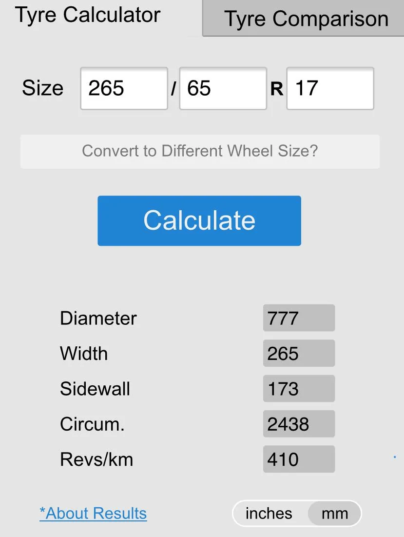

The OEM tires don’t match the mm size in the configuration either. The calculator has them at 2438, but the setting from Ford is 2360. I get the PCM error when I adjust the tire size for my 285/70R17 BFG KM3s. I can clear it but it always comes back. If I change it back to factory, I get the PCM error, but I can clear it and it doesn’t come back.

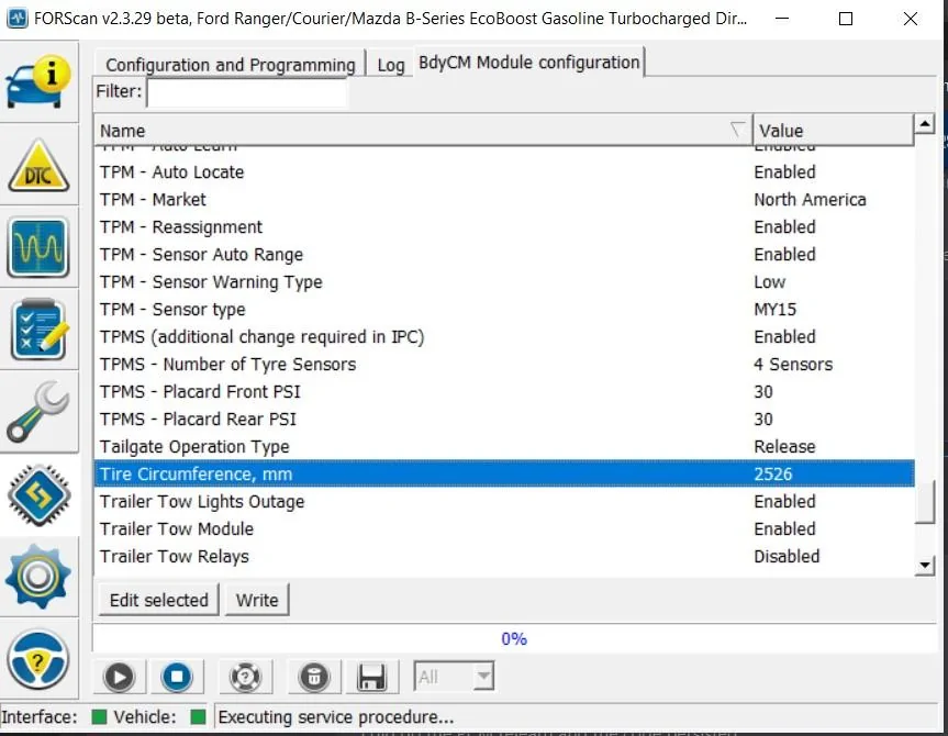

When calibrating by circumference I wonder if taking 3.2% from the calculated circumference is the formula since that's the difference of the factory setting of 2360 vs calculated 2438. With that said if running 285/70/17 3.2% of 2610 would be 2526. Going to try this tomorrow.
TheKracka
Klay
Apr 27, 2020
208
830
St. Louis
2019 XLT FX4/2005 xB
I fix things not people
Only made a tire circumference change and the speedometer seems pretty much spot on using Google maps on my phone for GPS. When the truck indicates 70mph the GPS indicates 69-70. At an indicated 45mph the GPS shows 44-45. So it seems like I might be going 1/4 - 1/2 of a mph slower than indicated.
Running 285/70/17 and used the value of 2526

Only made a tire circumference change and the speedometer seems pretty much spot on using Google maps on my phone for GPS. When the truck indicates 70mph the GPS indicates 69-70. At an indicated 45mph the GPS shows 44-45. So it seems like I might be going half to 3/4 of a mph slower than indicated.
My new tire size 265/70R18 appears to be nearly identical, so I’m going to try your number of 2526 first.
thank you
TheKracka
Klay
Apr 27, 2020
208
830
St. Louis
thank you
You're welcome! Using the same formula, for your tire size I come up with 2519.
