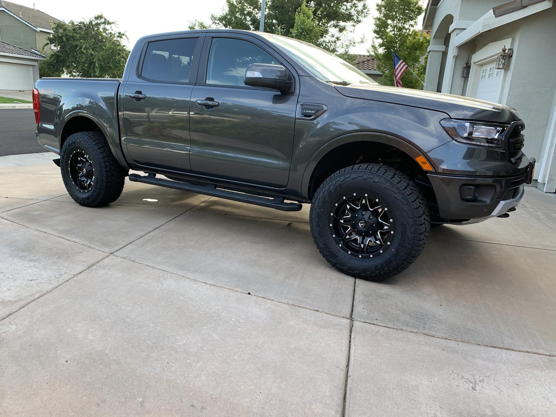

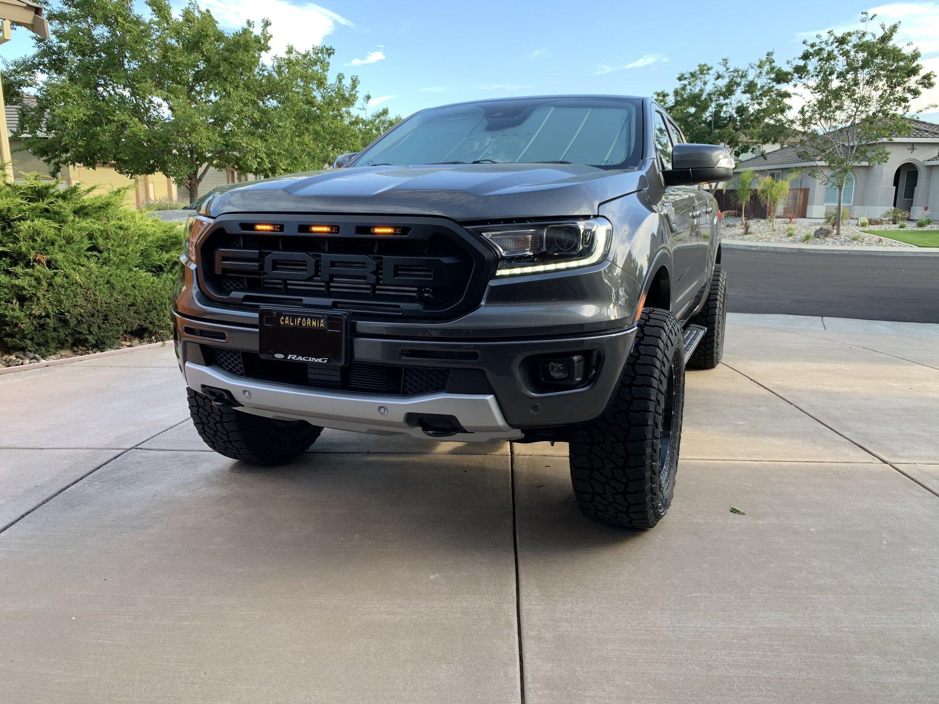

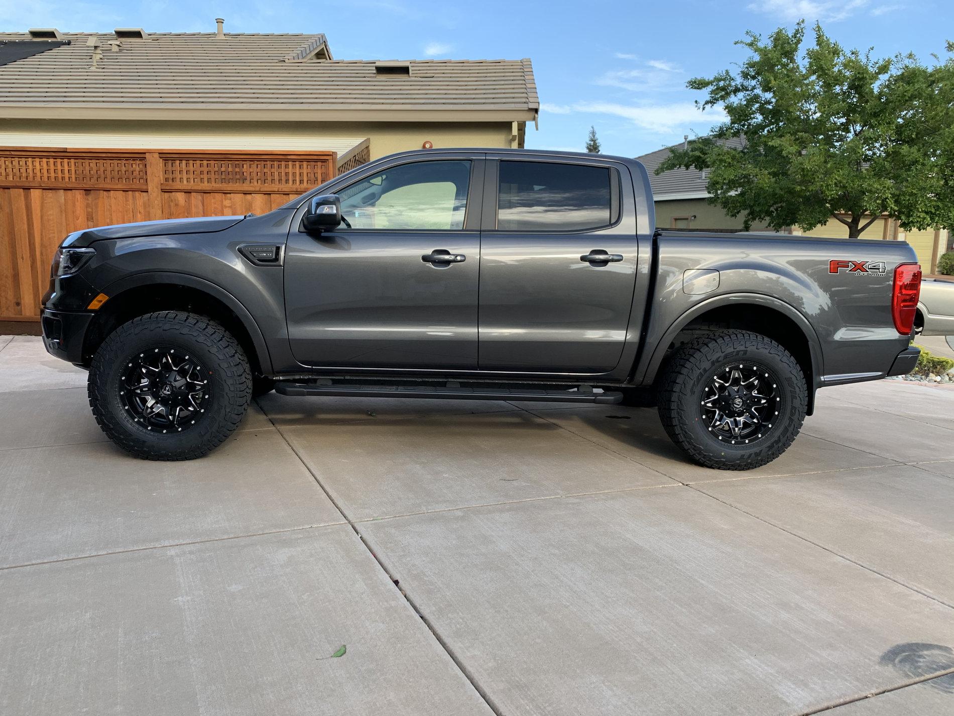

Stock: 255/65-17 - 726-12-01: xxxx 0910 xxxx
Change: 285/70-17 - 726-12-01: xxxx 09DC xxxx
Cruise set at 70mph, GPS reads 70mph. Before the change with the cruise at 70mph the GPS would indicate 75mph.
Hello everyone - I see this thread seems to be a little old and the recommended solution to fix the speedo after changing the tires has also changed. I would like to confirm what FORScan changes need to be made for my setup.
I have a 4wd 2019 Ranger Lariat.
Stock wheels and tires were 265/65/17 Hankook Dynapro AT M
New wheels/tires are 285/70/17 Falken Wildpeak A/T3W with Fuel Lethal 17/9 with the -12mm offset
The new wheels are 32.8 inches tall per the manufacture. That said, the tire converter tool says they are 32.7 inches tall. If I did the math correctly, the circumference is 2610mm
At first people were changing the BCM and I think the correct code for my setup would be
I then read that some are just using FORScan to change the tire circumference, I guess I would put 2610.
I also read that some are getting error codes, but it sounds like we can ignore those.
At the end of the day, what is the recommended change for my setup so the speedo is correct?
Many Thanks!
