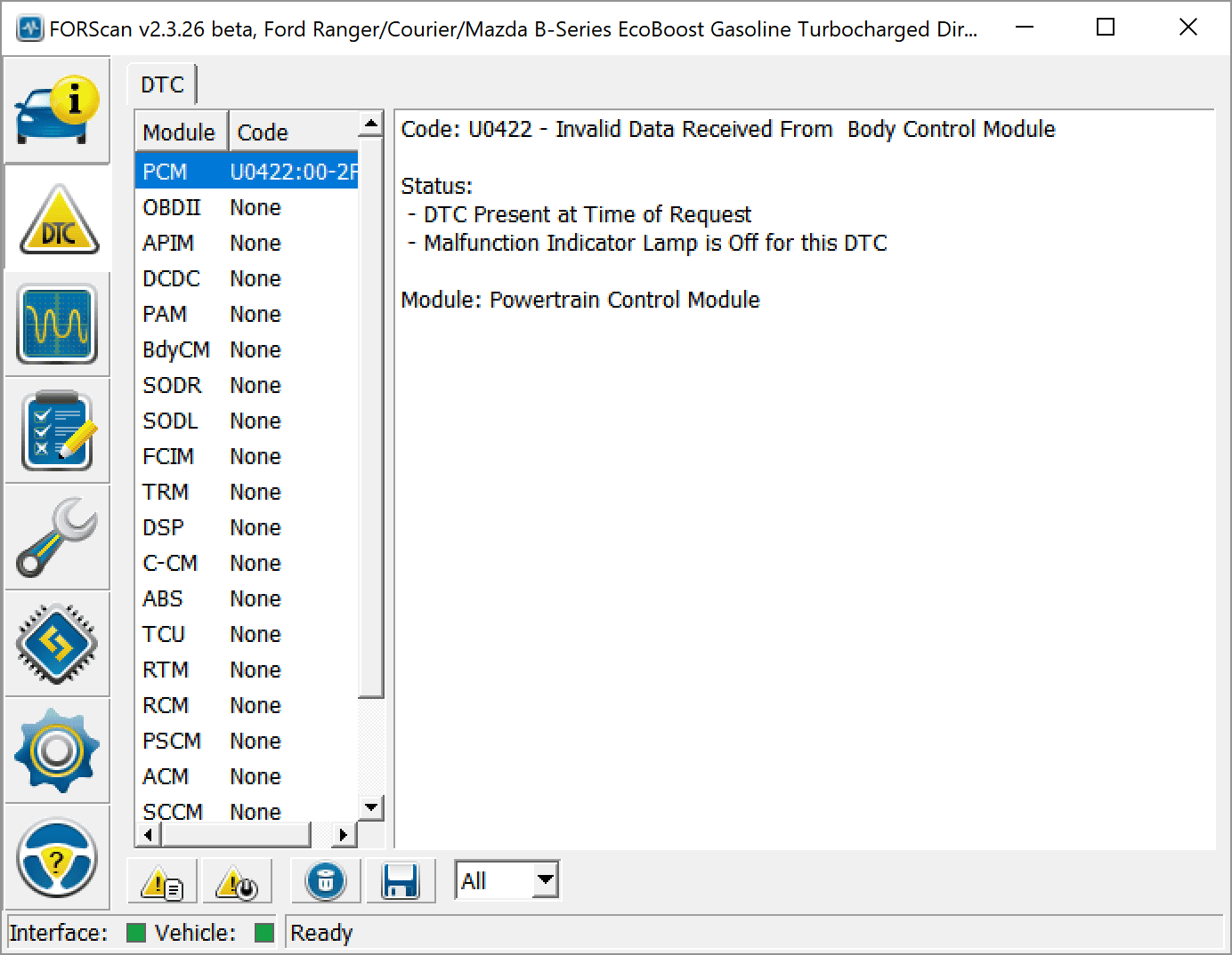

So to everyone that mentions that you get a code when you change the setting. Where does the code show up? Does it cause a CEL? Does it re occur at every start up? Is it always there? Do you need to have your programmer attached to see it? If you change the setting back to factory does the code go away?
I would like to change mine but I don't want to see any messages on normal operation. Thanks.
There's no CEL.
It shows up in the DTC section of FORScan. It goes away when you change 726-12-01 back to its default value.
The code on my brothers truck (I still have stock wheels/tires) comes back on every start. It does NOT cause a CEL, but is always there. I tried to clear it 2 or 3 times but it would come back after every restart. We undid the changes and the code went away. Put it back and it came back. No messages, but the code is persistent - it does not appear to affect anything at all according to my brother.

Which tire size and what value did you change to?
Stock: 255/65-17 - 726-12-01: xxxx 0910 xxxx
Change: 285/70-17 - 726-12-01: xxxx 09DC xxxx
Cruise set at 70mph, GPS reads 70mph. Before the change with the cruise at 70mph the GPS would indicate 75mph.

And you don't have a DTC in the PCM when connected via FORScan?

Not that I saw, but I will check it out next time I have it plugged in.
I didn't see the DTC when I connected with my android OBDLINK app, only when connecting via FORScan.

I can confirm that this fix works as advertised! Speedometer and GPS speed matchup perfectly. I can also confirm that it's throwing a code. I switched from 0934 to 09DC.
It's a small compromise to get a properly working speedometer and accurate milage.

This ā€˜codeā€™ seems to have no affect and only detectable with forscan.
Question: Does the code come up with a typical OBD scan?

I connected to my OBDLink MX Bluetooth from my phone and using their software it does NOT detect the DTC. I only see it when I connect via FORScan.
