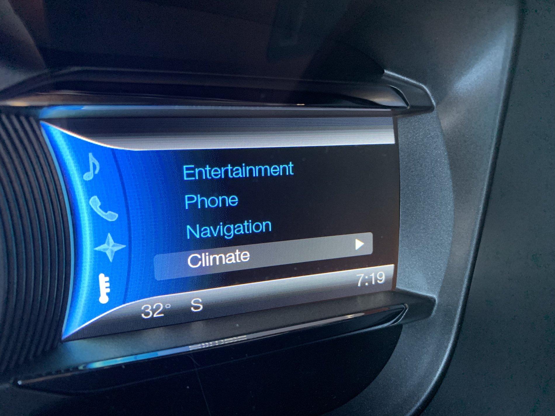

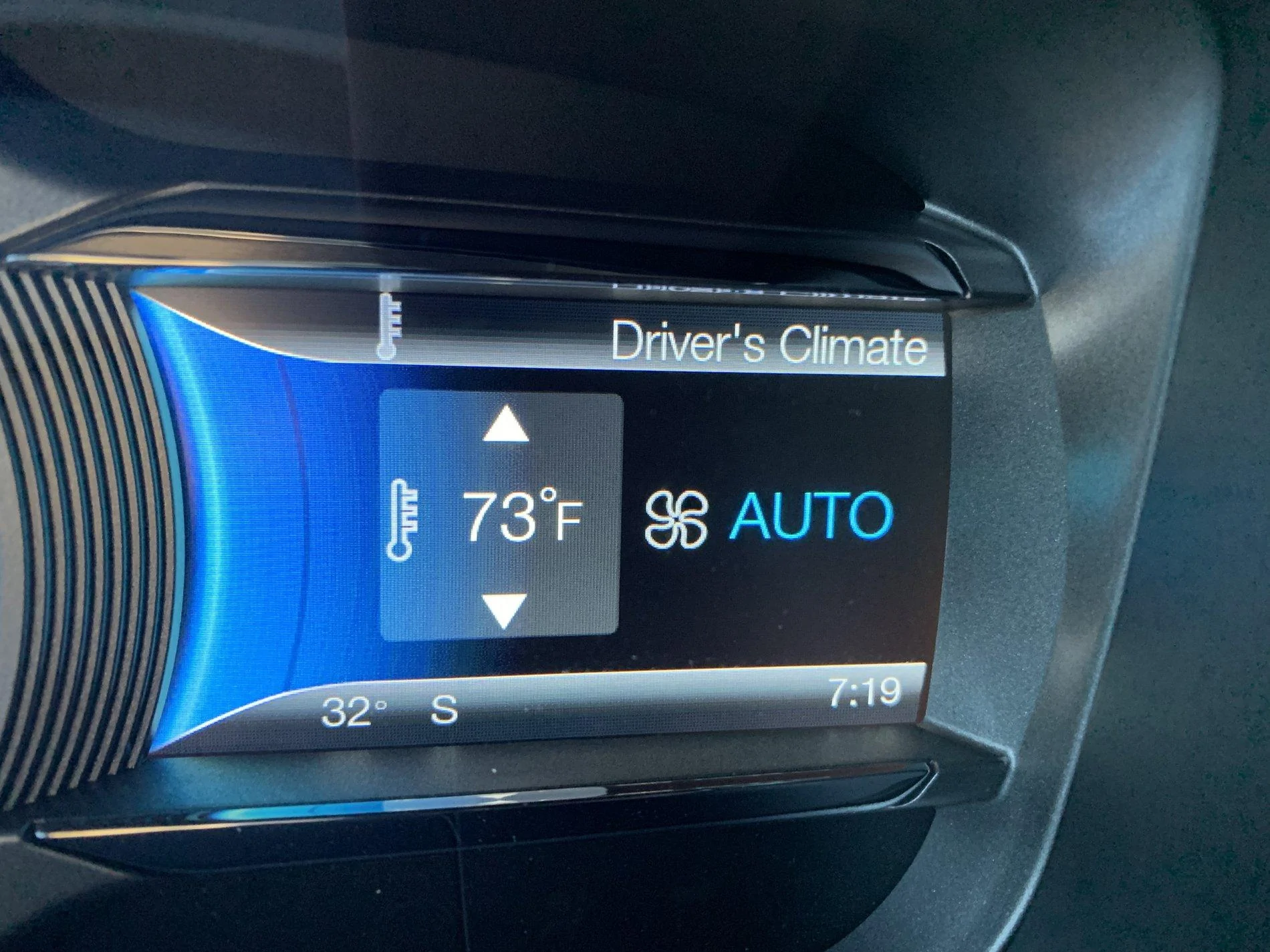

Anyone with access to a truck and FORScan... could you look to see which modules control the gauge cluster? I want to see if I can add the “climate” tab to the truck.
That should be the fairly obvious, I don't have it right in front of me, but as a first time user of Forscan, I was able to find it pretty easily. IPC sounds about right from memory.
If you have a Lariat, the climate tab should already be there no? My wife has a 2011 Edge, and it's present on hers.
Not an option for Lariat either.

That right screen option for Climate was removed on later Fords if I remember correctly (this was talked about over on BON). My wife's 2018 Edge with the dual screen cluster does not have it either.
