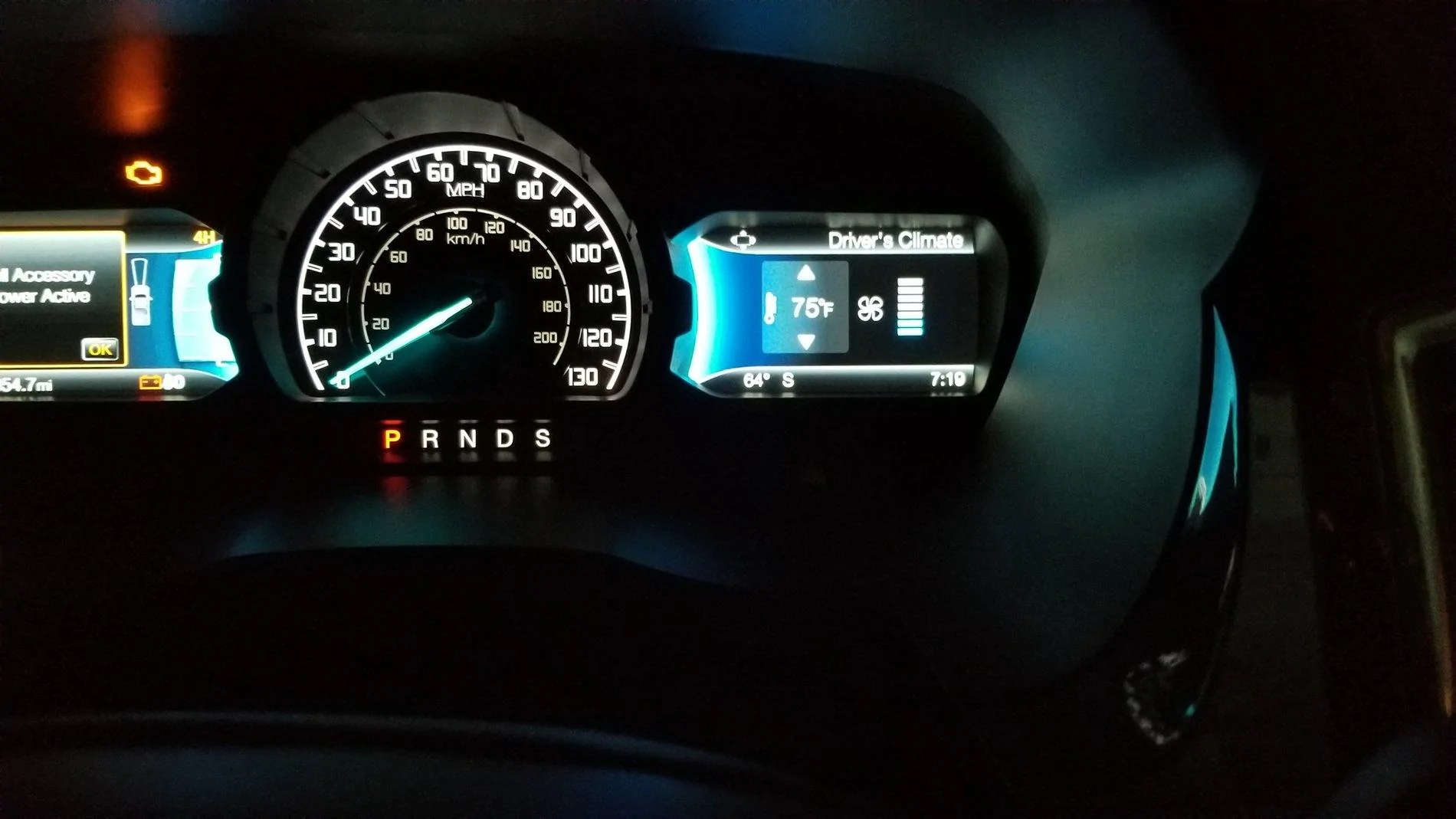

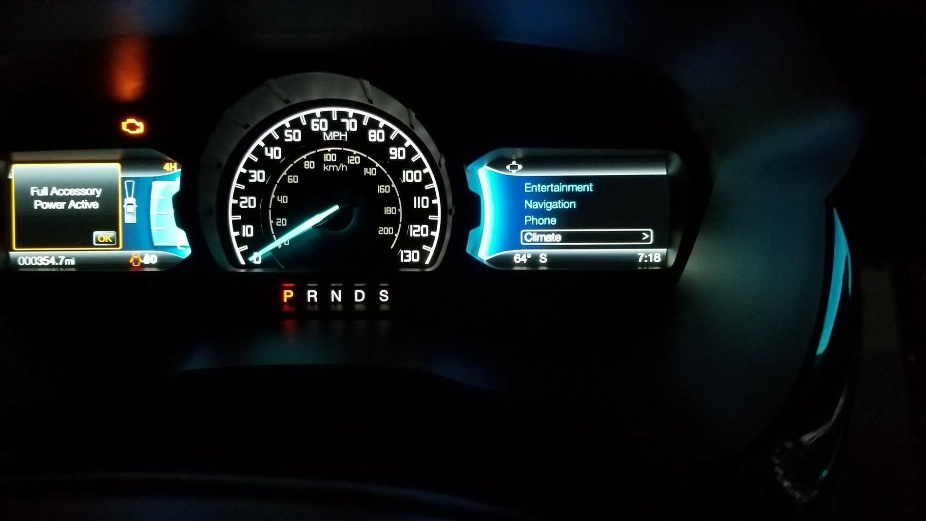

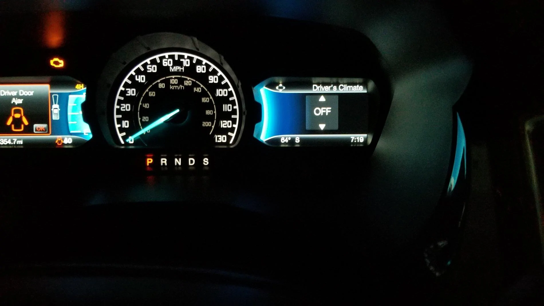

Just verified adding climate to right screen D8B8 xxxx xxxx
Oh really?! I didn't think they had the provisos left for that to work. Can you upload a pic? I'd like to see if its the same. Great work!

I just played with it and even though the controls seems to work it goes right back to what it's actually set at by either the manual buttons or the SYNC controls. So, it can't actually control the settings of temp or can speed. You can only see what the te
mp and fan speed is.
Hummm... It must need control over the climate and not just being enabled. Have to dig deeper and see what else it would be in relation to. I could check out a few things on my car before I trade it in this week.
