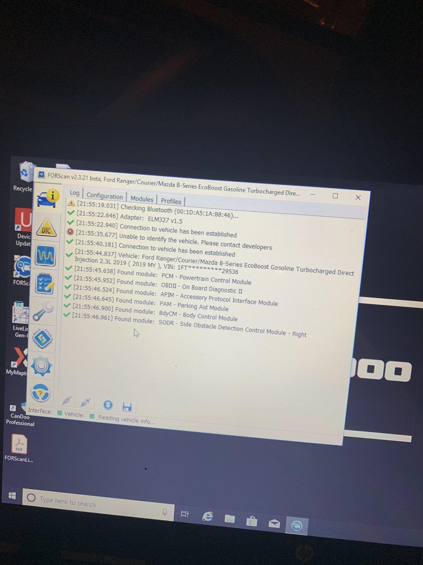

So I tried to get into the For Scan last night and it would read until this module and just stop anybody have this issue before?
It has been a bit since I hooked up Forscan (and I'm no expert), but I seem to recall something like this once or twice when I used one of the saved configurations. If I said no when it asked if I wanted to load an existing configuration it worked fine. Not sure if that helps or not. It would be worth a try if you did that.
Yea. Same for me. When prompted decline to use a saved configuration.
