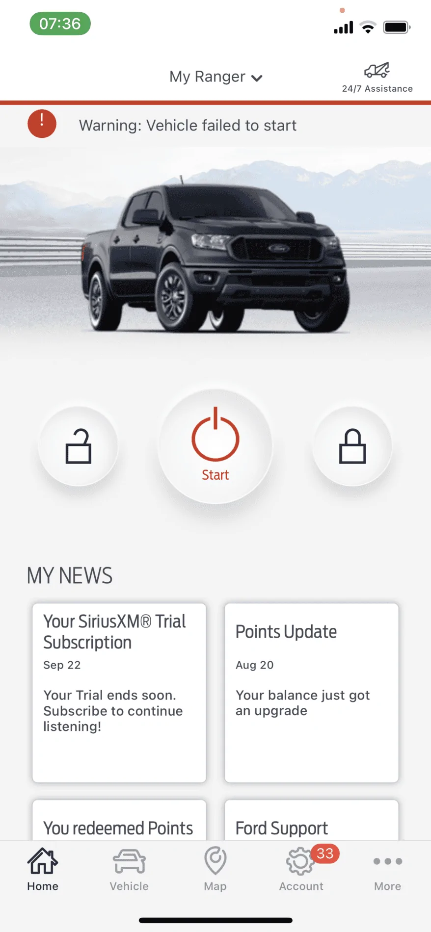

My truck is setup with my FordPass on my iPhone. The vehicle will not start with the app. I can unlock and lock the doors so I know it is set up correctly, but when you hold the start button it says vehicle failed to start. I read anecdotal evidence that this is some kind of software issue in the truck? I have deleted the app, reset the truck to stock and reset it all back up and same results. Any help would be appreciated.

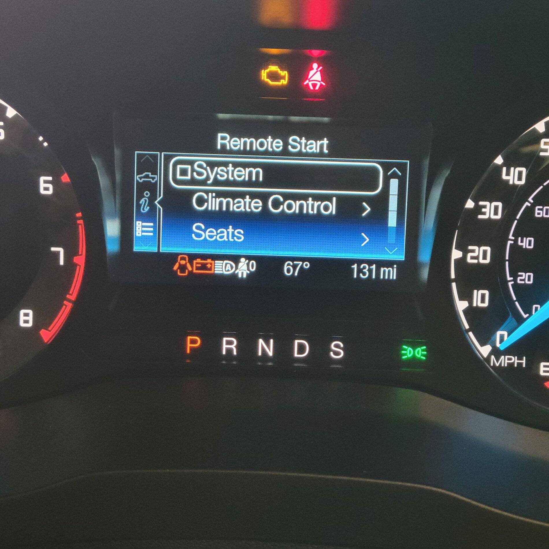

I just tested this.
check that your vehicle\settings\remote start\system is checked.
I unchecked it and was able to lock\unlock but got the fail to start error
I checked it and was able to remote start
