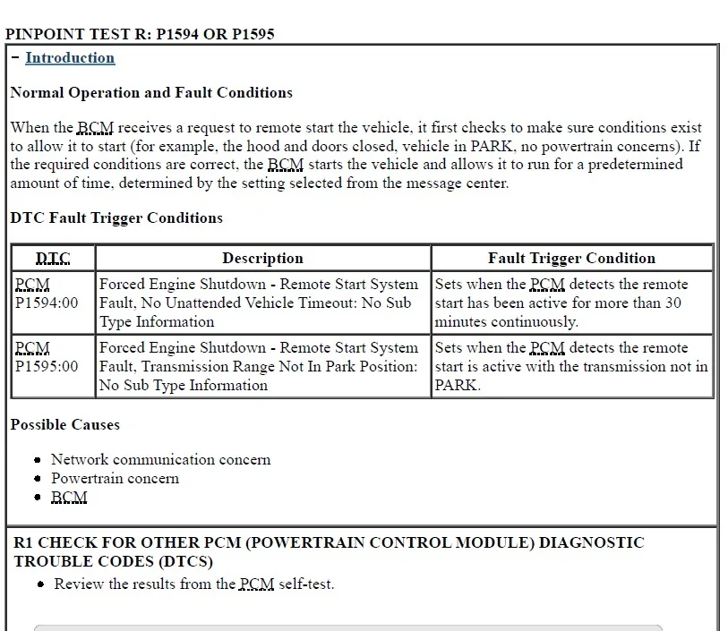

If you Ref: The WSM and find the Door Locks - Testing (look for Test R)
This is the (ONLY) ref to remote start (INOP) I can locate in any manual
So, it boils down to finding the related PID's and look for something that's out of range.

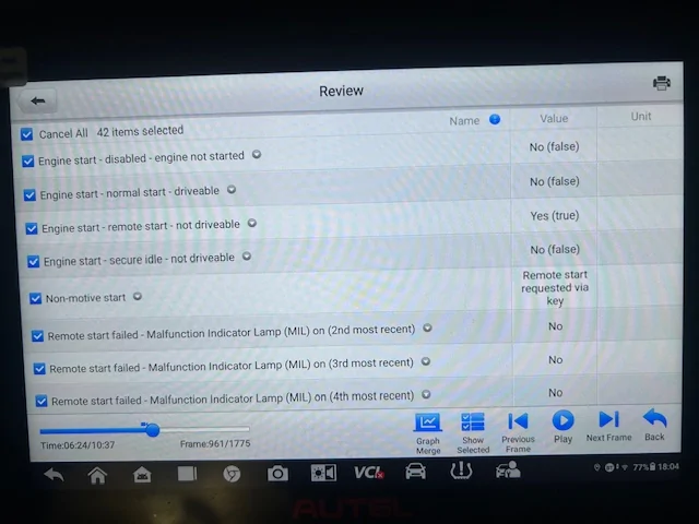

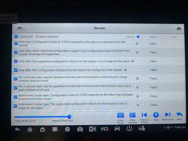

Here are some EXAMPLES of the BCM & PCM PIDs that need checked
There is a long list of these in the PIDs, but these are an example of what needs checked.
You are looking for something that's (Out Of Range)
So, pull up all the (Remote Start - Failed) PIDS
Note: FYI the PID - Remote Start (Not Drivable) is the Engine Started via Remote Start but the Ignition Switch is not (ON) - The transition when you get in - has not been completed and hitting the PB Switch
BCM
PCM

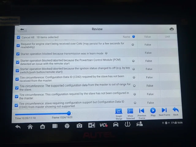

PCM - Tire Size
Hopefully, this will help pinpoint it down
