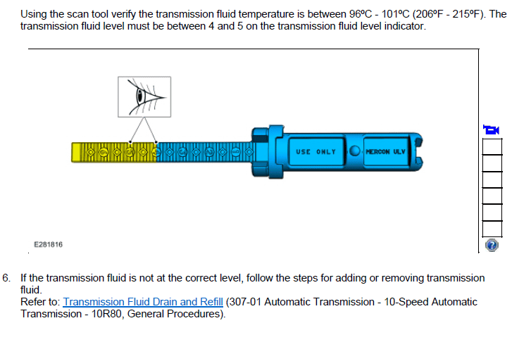

Okay so i've installed the fritzstick And took it out for a drive. And I got the temperature up to 204 checked level and I'm close to the 4 mark between 4 and 4 1/2 Does this mean my transmission is overfilled?

204 degrees is basically within the tolerance as stated in the manual - see below (206 is the low range).
