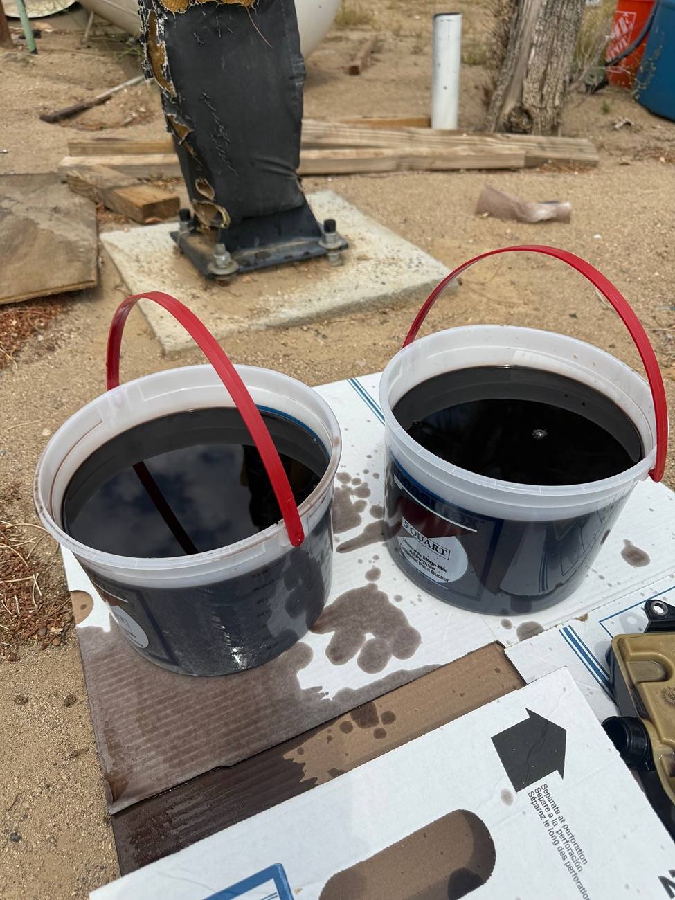

The first time changed the fluid and filter, I got just about exactly 7.5 quarts out of the pan. This was after parking the Ranger for 2-3 days (plenty of time for all the fluid to pool up in the pan). I put that exact same amount back in. I then drove it for a few hundred miles, dropped the pan again and got 5.6 quarts out the second time. (The truck only sat for. Few hours this time before changing the fluid, so not as much time for the fluid to drain to the pan). But again, I made sure to add that exact same amount back.The goal was to get as much fresh/cleaner fluid into the transmission without actually doing a full flush. The fluid was also dark as motor oil.

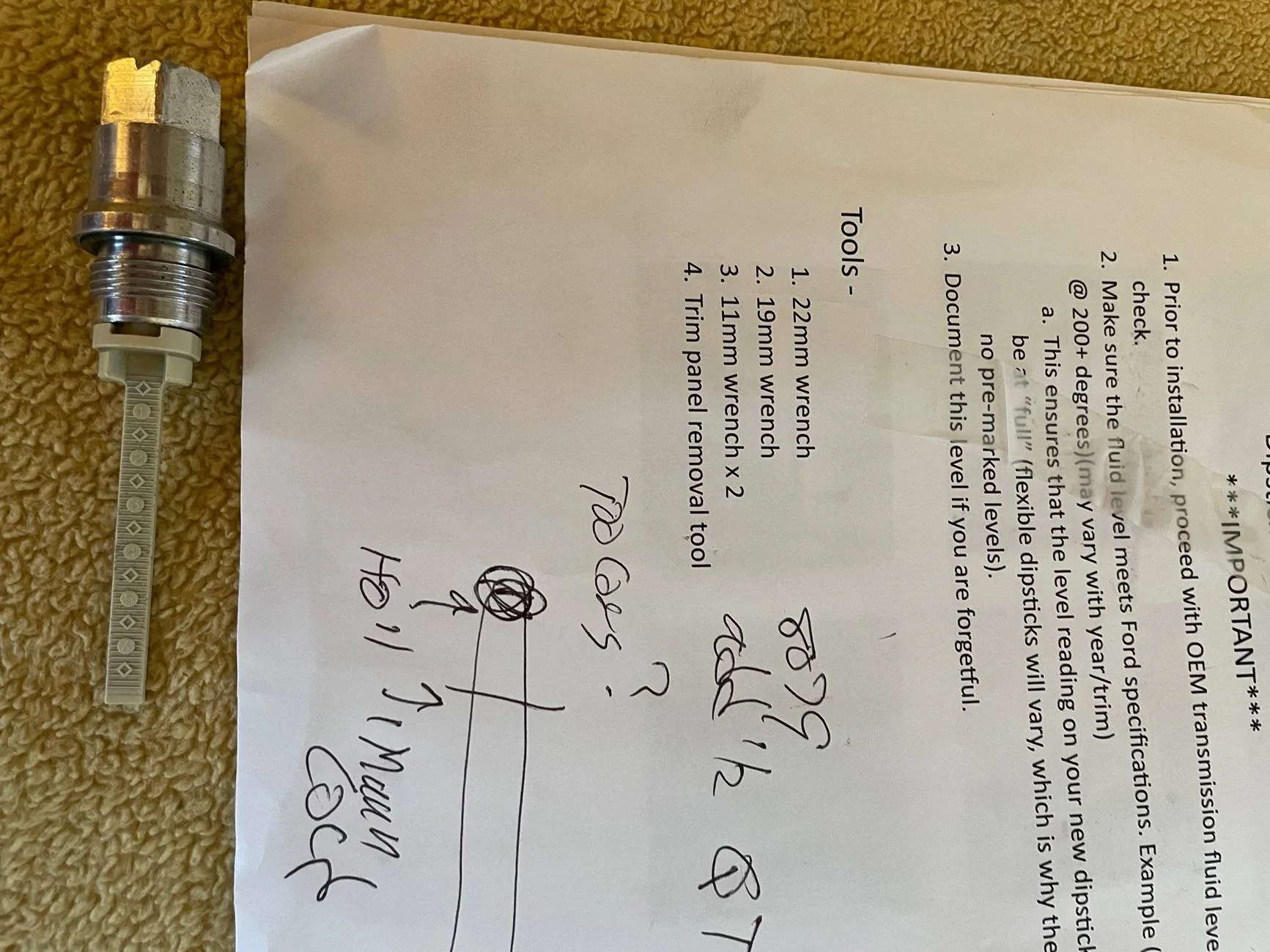

I put on the extra capacity PPE pan and added 6 1/2 QTs with funnel and plastic tube from top .
Then I added transmission dipstick .
It barely showed on end. They sent another insert 1/2 in longer.

I recently installed a Fitzstick, PPE pan, new OEM filter and a qt. of Lubegard. ...no problems at 32K, but I want to avoid them.
