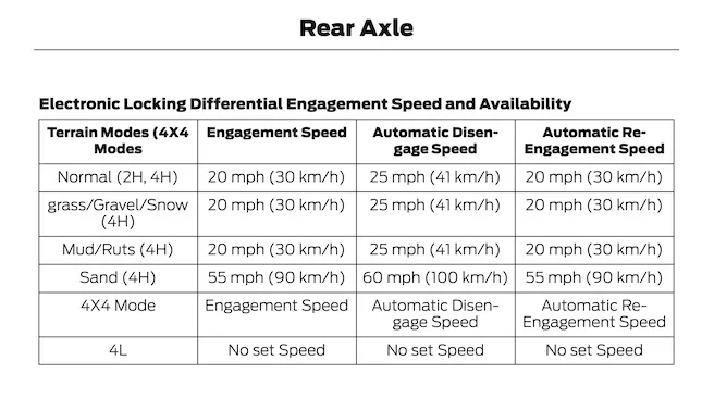

FYI, this is not true. You can engage 4H up to 68 MPH and it will stay there until you disengage it.
I have engaged it at least as high as 65 MPH.
You are correct, I was mis-confused. The e-locker disengages at certain speeds and re-engages when slowed:
